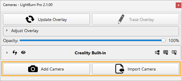

Quick Start
If you want to dive right in with adding a camera, you can use the Add Camera or Import Camera buttons in the Cameras Window, and follow along with the onscreen directions.
Screenshot of buttons in the Cameras Window

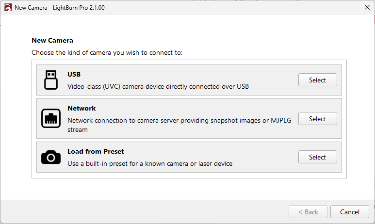

1. Select Camera Type

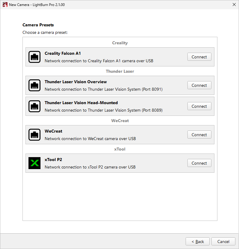

LightBurn 2.1 offers three options for camera type. Select the one that matches your setup.
  • USB for typical USB cameras with a direct wired USB connection to your computer.
  • Network for cameras you connect to over a wired or wireless network.
  • Load from Preset to load a preset, if one exists for your device. Currently, LightBurn has presets for the following camera setups:
    • Creality Falcon A1 Pro
    • Thunder Laser Vision (both Overview and Head-Mounted)
    • WeCreat
    • xTool P2
Screenshot of selecting camera type

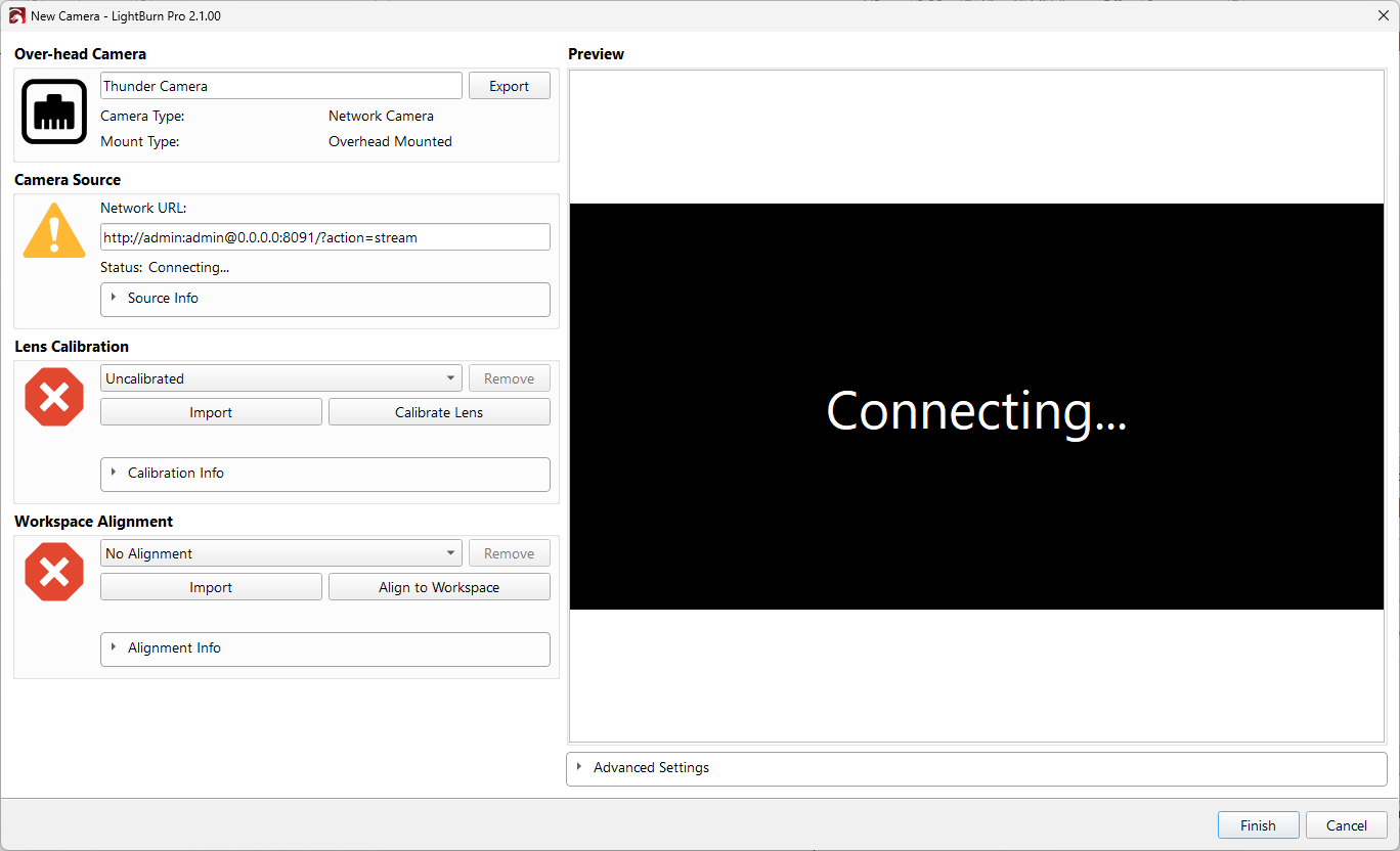

If you're loading a preset, the process is similar but looks a little different - after selecting camera type you'll go to the Edit Camera screen, which shows you the camera name, type, source, calibration, and alignment all in one place.
After selecting or connecting to a camera, the left side of the window will show additional information about the camera, and the right side of the screen shows you a preview of the camera feed.

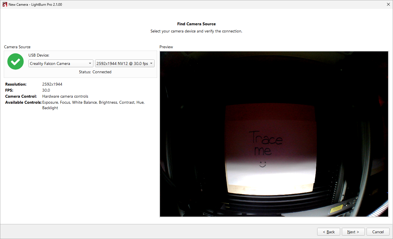

Screenshot of finding source for a USB camera
To select your USB camera, click the dropdown under USB Device and select the camera you want to use. You may have additional options for framerate or resolution in the second dropdown. Higher resolutions will give you more detailed images, and higher framerates will give you more responsive previews, but at the cost of requiring a more powerful computer.
If you don't see the camera you want to use, make sure it's connected. Check our Camera Troubleshooting or email support for more help.

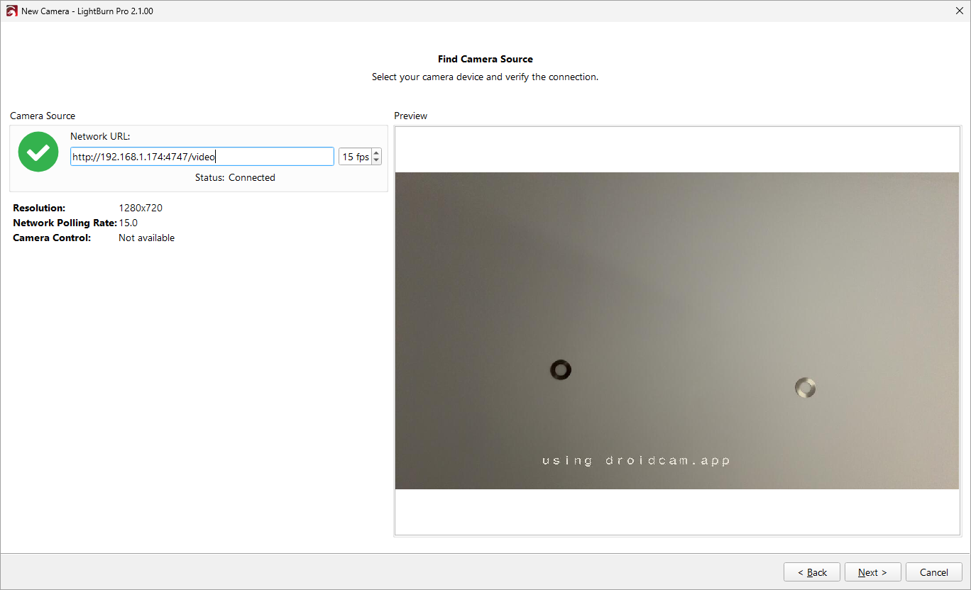

Screenshot of finding source for a Network camera
To connect to your network camera, type the URL for the camera feed into the box under Network URL and set the framerate you want to use. Higher framerates will give you more responsive previews, but at the cost of requiring a more powerful computer.
If you can't connect to your camera, check that you've entered the URL correctly, and that your video feed is accessible. Check our Camera Troubleshooting for additional help with getting the correct URL or email support for help.
Select the camera that matches your hardware and click Connect to continue to the Edit Camera screen, where you'll make sure the computer can find the camera, preview the camera feed, and manage lens calibraton and workspace alignment.
Camera presets currently support:
  • WeCreat
  • xTool P2
Screenshot of Edit Camera screen

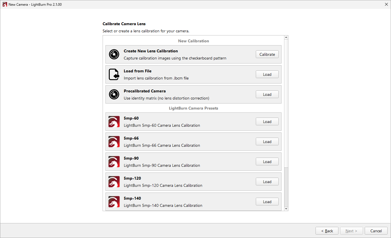

3. Calibrate and Align Camera Lens
After selecting your camera type and finding your camera source, LightBurn will walk you through the steps to calibrate your camera lens and align your camera to your workspace.
This will look a little different depending on how you added your camera:
Preview after adding a USB camera
After adding a USB or Network camera, LightBurn takes you to the Calibrate Camera Lens screen.
Edit Camera Window after loading a Camera Preset
After loading a Camera Preset, LightBurn takes you to the Edit Camera screen, where you can manage lens calibration and workspace alignment.
There are a few paths you can take for lens calibration.
  • Create New Lens Calibration will walk you through calibrating your camera lens yourself.
  • Load From File will import a camera calibration from a .lbcm file, which you can create by exporting the camera settings from an existing camera setup.
  • Precalibrated Camera is for cameras that are already calibrated and don't require additional distortion correction.
  • LightBurn Camera Presets will automatically apply the appropriate settings for cameras purchased directly from LightBurn.
Regardless of which one you choose, you can follow the on-screen directions or jump ahead to our Camera Lens Calibration page.

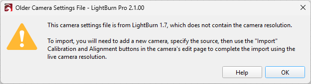

Are you importing a camera from an older version of LightBurn?
If you're importing a camera into LightBurn 2.1 from LightBurn 1.7 or older, you'll see the following Older Camera Settings File warning.
This Camera settings file is from LightBurn 1.7, which does not contain the camera resolution.
To import, you will need to add a new camera, specify the source, then use the "Import" Calibration and Alignment buttons in the camera's edit page to complete the import using the live camera resolution.
Older Camera Settings File Warning
You can still import your camera, but there is an extra step to make it work:
  1. Create the camera, following the directions in Step 1 and Step 2 of Create a New Camera. Don't worry about Calibration and Alignment, you'll import those.
  2. Once you've added the camera and connected to it, you'll be able to import the Lens Calibration and Camera Alignment from your camera settings file, as described in Import Calibration and Import Alignment.
Why did this happen?
You're seeing this message because the older camera settings file you're using doesn't have information about the camera resolution, so LightBurn can't import it in one step. Once you create the new camera in LightBurn 2.1 and connect to it, LightBurn has the information it needs to be able to import the Lens Calibration and Workspace Alignment.

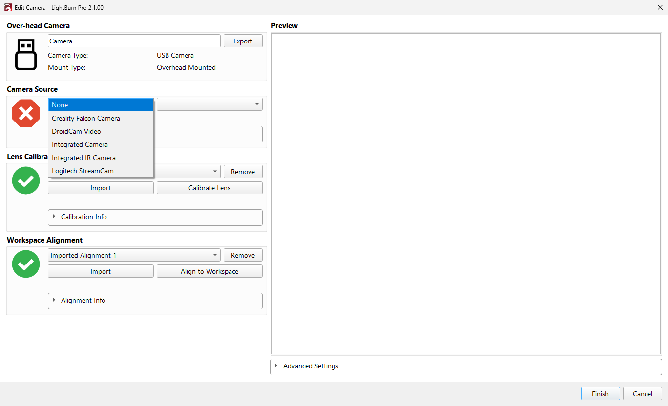

2. Edit Camera
After importing your camera, you'll be taken to the Edit Camera window. You'll probably want to change the name of the camera in the text box to something a little more descriptive than "Camera", especially if you'll be using more than one.

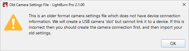

Edit Camera window after importing from an old version
Because you've imported your existing camera data, Lens Calibration and Workspace Alignment should both have green checkmarks and show the imported calibration data. If you got the Old Camera Settings File warning described above, you'll need to select your camera source from the dropdown under Camera Source. Otherwise, that should also have a green check mark and show the camera name.
The screenshot here shows the Edit Camera window after getting the Old Camera Settings warning - to fix it, you would select the appropriate camera option under Camera Source.
