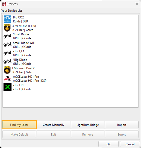

In LightBurn, click the Devices button (highlighted in the screenshow below) in the Laser window to open the Devices window.

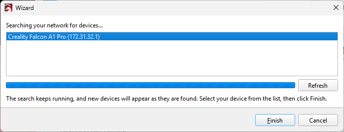

In the Devices window, click the Find My Laser button under the device list to open Find My Laser.
Make sure your device is connected to the network. Click the Search Network button.
If LightBurn detects your device, it will show up in the list. Select it and click Finish.

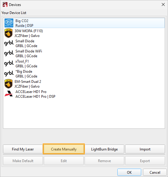

In LightBurn, click the Devices button (highlighted in the screenshot below) in the Laser window to open the Devices window.
In the Devices window, click the Create Manually button under the device list to open the New Device Wizard.

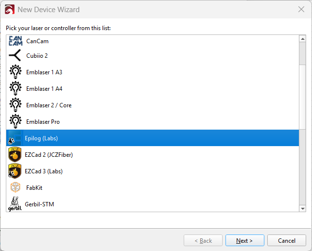

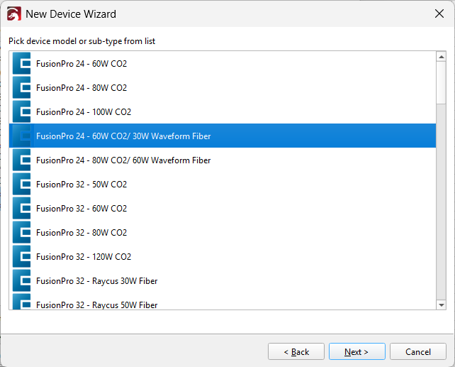

In the New Device Wizard, select Epilog from the list of device types. Click Next to Continue.
Select your specific Epilog model from the list.

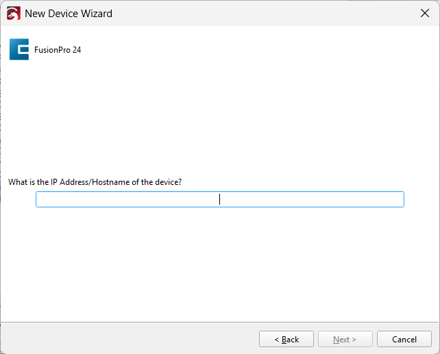

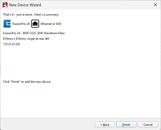

Enter your IP address to tell LightBurn where to find your laser on your network. Click Next to continue.

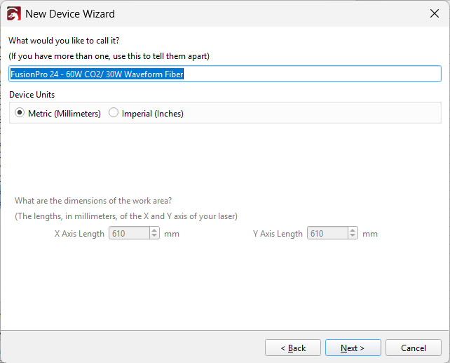

Name your device something recognizable. The dimensions should be set automatically. Leave the Device Units in millimeters - if you prefer to design in inches, you can set that separately later. Click Next to continue.
Make sure the summary on the final screen seems correct. Click Back to go back and make changes, or Finish to save your changes.

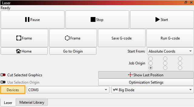

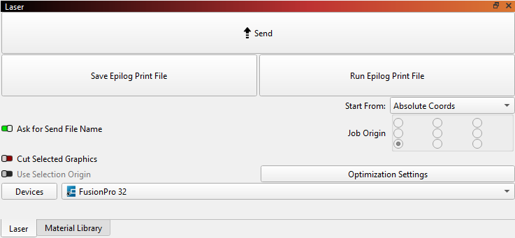

When you use LightBurn with an Epilog laser, you'll see a custom version of the Laser Window.
Send¶
Click the Send button to send the current design to your laser. If Ask for Send File Name is enabled, LightBurn will ask you for a file name.
Save Epilog Print File¶
Saves the cut data for the current design to an Epilog Print File (.prn) that you can upload to your laser later.
Run Epilog Print File¶
Loads an Epilog Print File and runs it on the laser immediately.
Ask for Send File Name¶
When Ask for Send File Name is enabled, LightBurn will ask you to name the file that is sent to the laser before sending it.
Start From and Job Origin¶
These two controls determine where the job is placed on the bed of your laser.
See Coordinates and Job Origin for more information.
Cut Selected Graphics¶
This toggle switch tells LightBurn to only send the portion of your design that is currently selected when you click Start, Send, or Save Machine File.
See Cut Selected Graphics for more information.
Use Selection Origin¶
Only available in combination with Cut Selected Graphics, the Use Selection Origin button tells LightBurn to calculate origin relative to selected graphics only, and not the whole design.
See Cut Selected Graphics – Use Selection Origin for more information.
Optimization Settings¶
This button opens the Optimization Settings window, where you can adjust various options that control the order in which your graphics are cut or engraved by the laser.
See Optimization Settings for more information.
Devices¶
Opens the Devices window, where you can create, remove, or edit device profiles for lasers you want to use with LightBurn.
Right-click to reset the USB connection
Right-clicking the Devices button closes and re-opens the connection to the currently selected device to reset it. This currently does not work with BSL devices.
See Devices for more information.
Device Selection Dropdown¶
If you've created multiple device profiles for multiple lasers, select the laser you are currently working with the dropdown menu.
