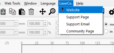

  • Menu Title
The Menu Title, if present, will be used to create the Vendor Links Menu. The URLs and email address you provide will all be listed in LightBurn under this name.
