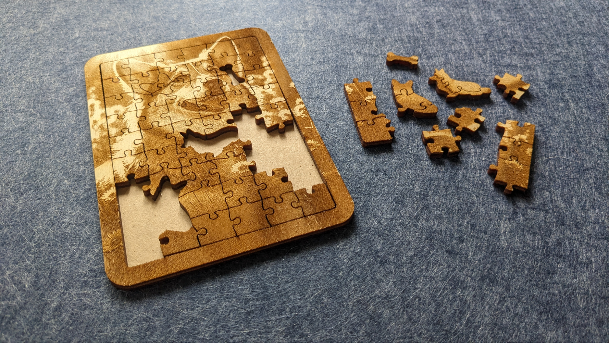

This quick and personalized gift is the perfect project for a beginner. Design it, cut it, and send it to your loved one. Imagine putting together a bunch of random puzzle pieces and slowly realizing it's your very own furry friend!

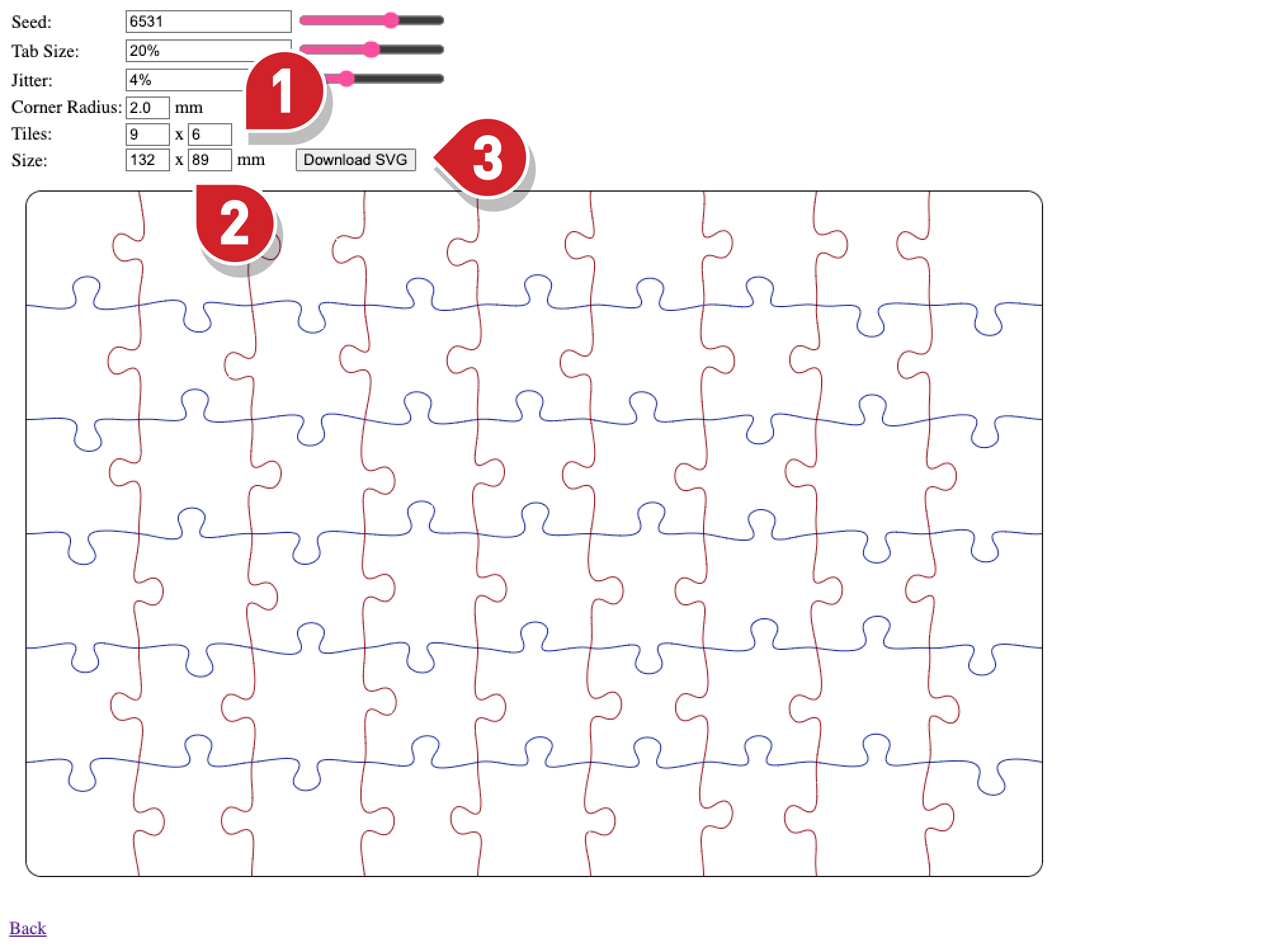

Use a free online Jigsaw Puzzle Generator, such as this one by Manual Kasten (Draradech), to create the puzzle pieces.
  1. Set the Tiles to the number of puzzle pieces you want across and down (I used 9 x 6).
  2. Set the Size to the width and height of your puzzle (I used 132 x 89mm)
  3. Click Download SVG to save the vector file to your computer.

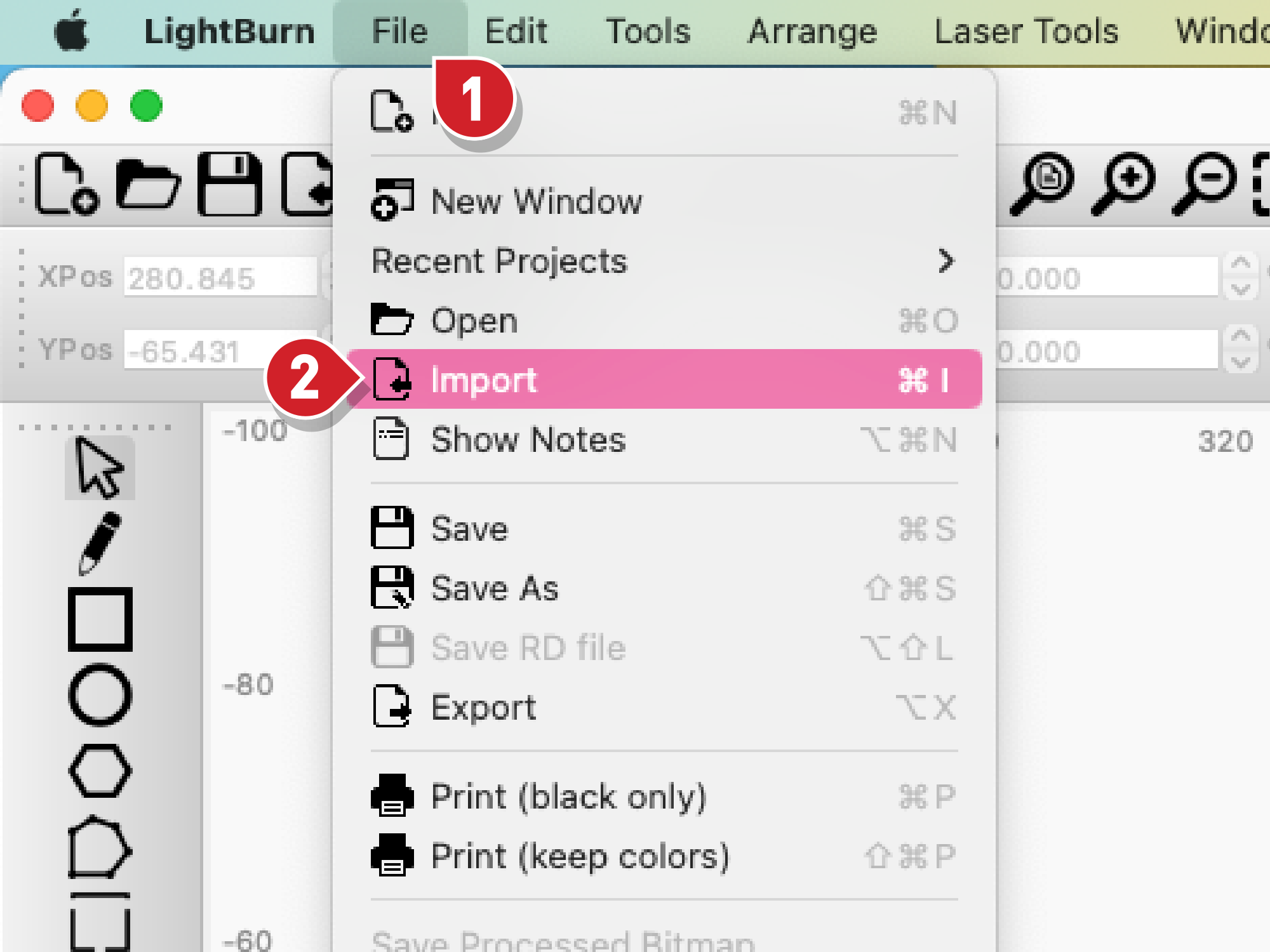

  1. Open LightBurn and click FileImport (or Ctrl+I / Cmd+I on your keyboard).
  2. Navigate to your jigsaw file, and click Open.

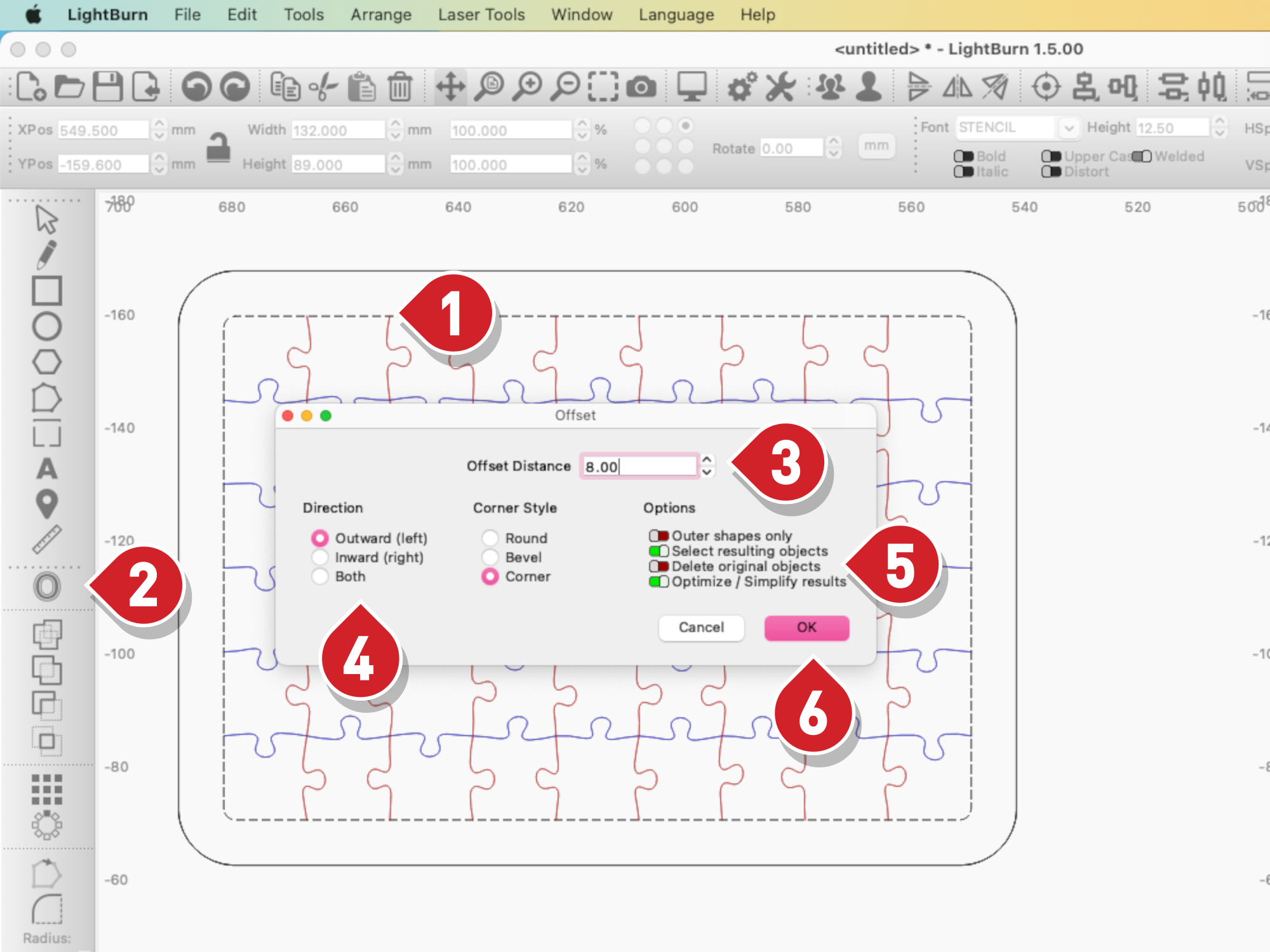

3. Create A Border Using Offset
  1. Click the black outline around the puzzle to select it.
  2. Click the Offset Tool from the toolbar on the left.
  3. Change the Offset Distance to the thickness of your border (in my case, 8mm).
  4. Ensure the direction of the offset is set to Outward
  5. Ensure Delete original objects is off.
  6. Click Ok.

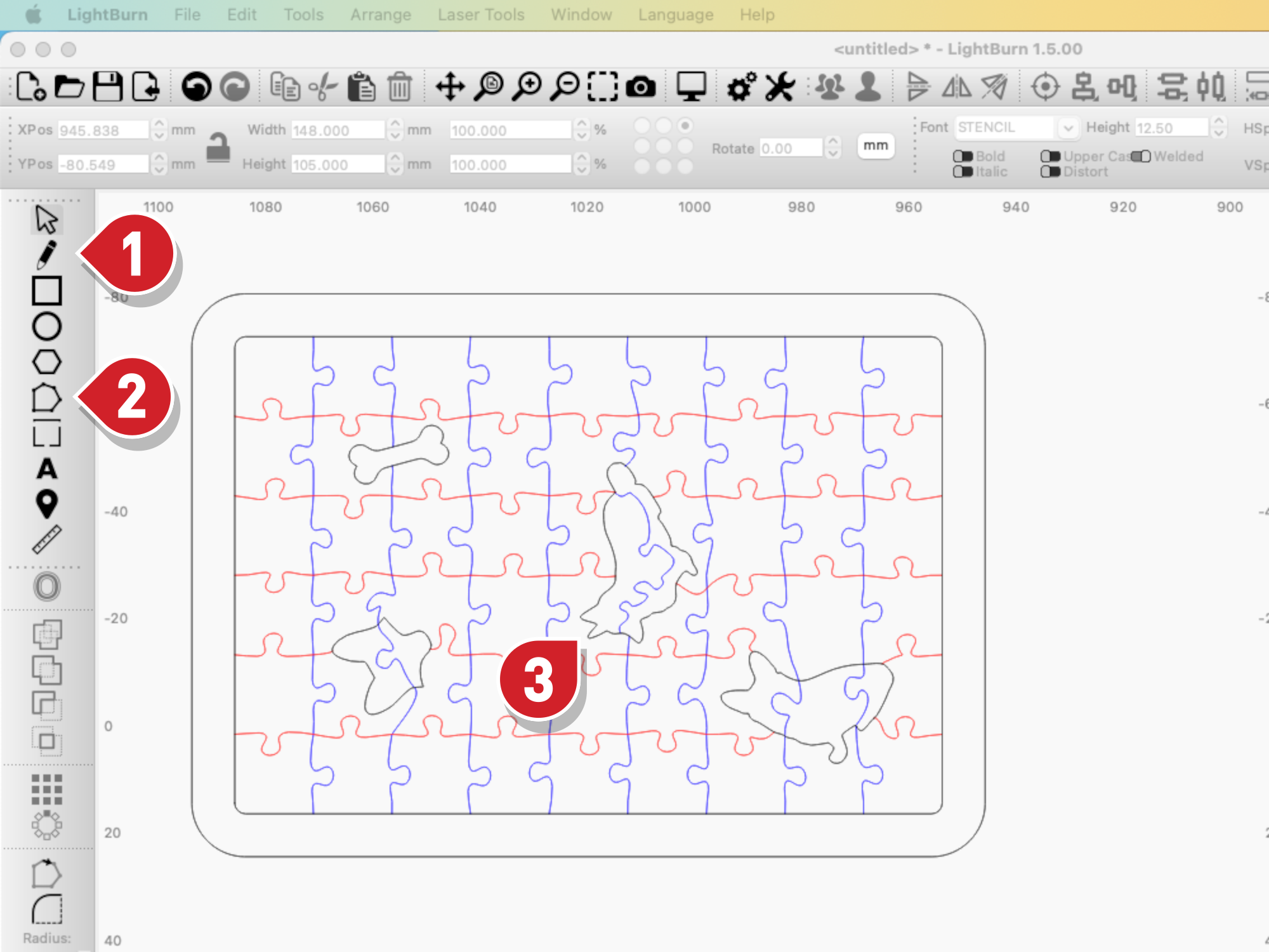

4. Add Fancy-Shaped Pieces
  1. You can create new shapes using the Draw Lines tool, or find an existing vector online from somewhere like The Noun Project and import it. You also might want to get LightBurn to trace a pixel-based image for you.
  2. You can edit both the new shapes and the puzzle using the Edit Nodes tool.
    Tip
    You can hover over the node edit tool icon to see a list of hotkeys! The Cut Shapes tool might also be helpful.
  3. As you customize the pieces, remember your shapes still need to be able to lock together, so add nubbins, and be sure not to make any parts too small, or they may end up too delicate!

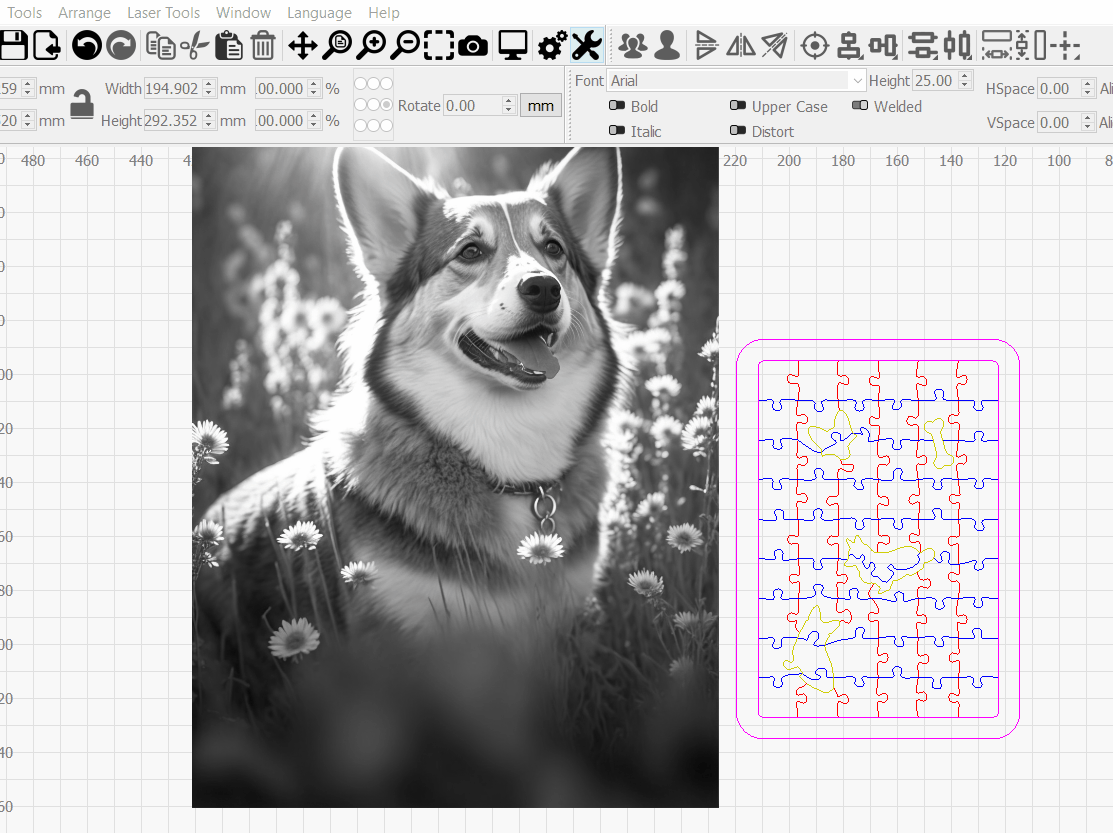

5. Add The Pet Photo
  1. Import the image using FileImport (or Ctrl+I / Cmd+I on your keyboard)., navigate to your pet photo file, and click Open.
  2. Move and scale it into position using the Transform Controls, making sure your image is at least as big as the outer border of the puzzle.
  3. Trim off the excess of the image to the outermost border line using the Image Masking tool. You can toggle the image to not show in the cuts/layers menu, if you're having a hard time selecting the border line.

Now that it's done, pop it in an envelope and send it to someone you love!
