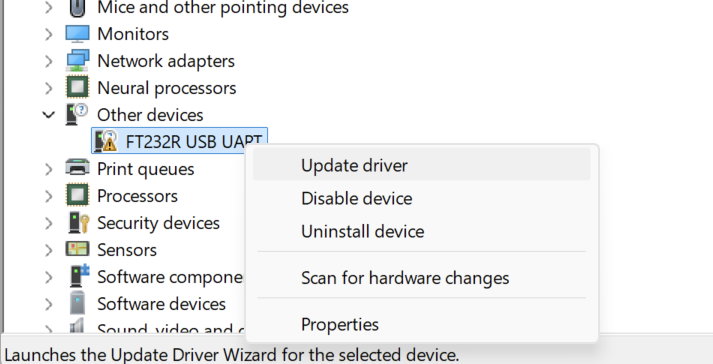

| Ruida or Top Wisdom | Windows | FTDI driver required. If you're not sure you've installed it, you can rerun the LightBurn installer and check the box to install the FTDI driver. You can also manually install the driver by going to C:\Program Files\LightBurn\ and double-clicking FTDI_Driver.exe to run the installer. Starting with the installer for LightBurn 2.2, the included driver is compatible with ARM / Snapdragon computers as well. |

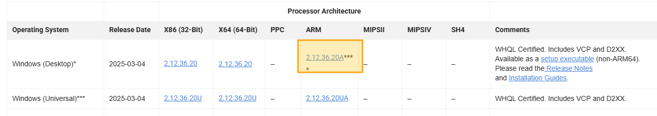

Windows on Arm Drivers¶
With previous versions of LightBurn, if you were using a Windows computer with an Arm processor, you needed to download and install different drivers compatible with your computer.
In LightBurn 2.2, the drivers included in the installer are compatible with Arm processors, so no special driver installation is needed.
