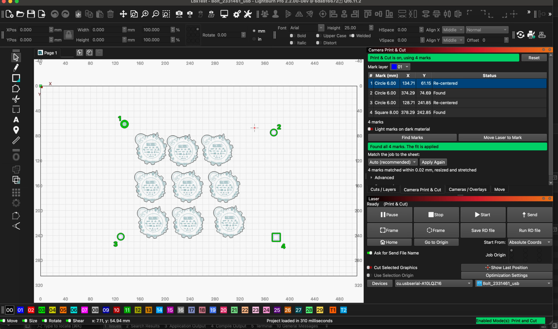

  1. Load your design, with its registration marks, and print it at 100% scale.
  2. Go to Window → Camera Print & Cut to open the Camera Print & Cut Window.
  3. LightBurn chooses the Mark Layer for you. Check to make sure it's correct, and if not, change the Mark Layer to the one you want to use. The marks and their locations appear in the list and are highlighted in the workspace.
  4. If you're using light marks on dark material, turn on Light Marks on Dark Material.
  5. Place the printed sheet in the laser.

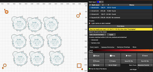

  6. Jog the head so the camera can see the mark named in the yellow line in the window, for example "Park the head over mark 1".
  7. Click Find Marks. LightBurn finds that mark, then moves to each of the others in turn.
  8. When every mark is found, the fit is applied automatically, and the window says Found all 4 marks. The fit is applied.
  9. If you want to be really certain, check the fit: select a mark in the list and click Move Laser to Mark.
  10. Run your job as usual. It is moved onto the printed sheet.

While the Camera Print & Cut window is open, every mark is outlined in orange, with its number beside it, so you can find marks even on a hidden layer or a pale layer color. Circles and donuts get a circle, and squares a square turned to match the mark. The mark selected in the list has a thicker, filled outline. Once the fit is applied, the outlines of the marks it used turn green.
Screenshot of a sheet of several designs with numbered rings. This screenshot shows the rings in orange, with one selected, before the fit is applied
This screenshot shows the marks in orange, with one selected, before the fit is applied
Screenshot of a sheet of several designs with numbered rings. This screenshot shows the rings in green after the fit is applied.

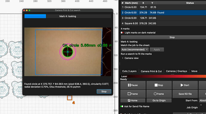

Find Marks, Search Here, and Skip
Click Find Marks to find every mark. Before you click it, jog the head so the camera can see the mark the window names. You can choose a different starting mark by selecting it in the list.
LightBurn searches around where it expects each mark. If it can't find one, it stops and shows Mark # not found. You can:
  • Jog the head near the missing mark, then click Search Here.
  • Click Skip to leave the mark out and carry on, as long as at least three marks remain.
Click Stop at any time to end the search.

Click Camera view to see the last image the camera captured, with the mark it found outlined.
To check one mark without moving the head, select it in the list, jog the head so the camera can see it, and click Find Mark in View. The line below the image says where the mark was found and how big it is.
