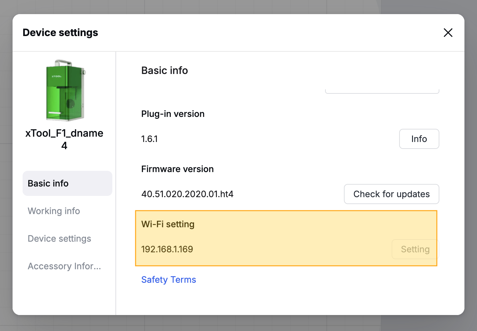

Part 1: Use xTool Studio to Find Your IP Address

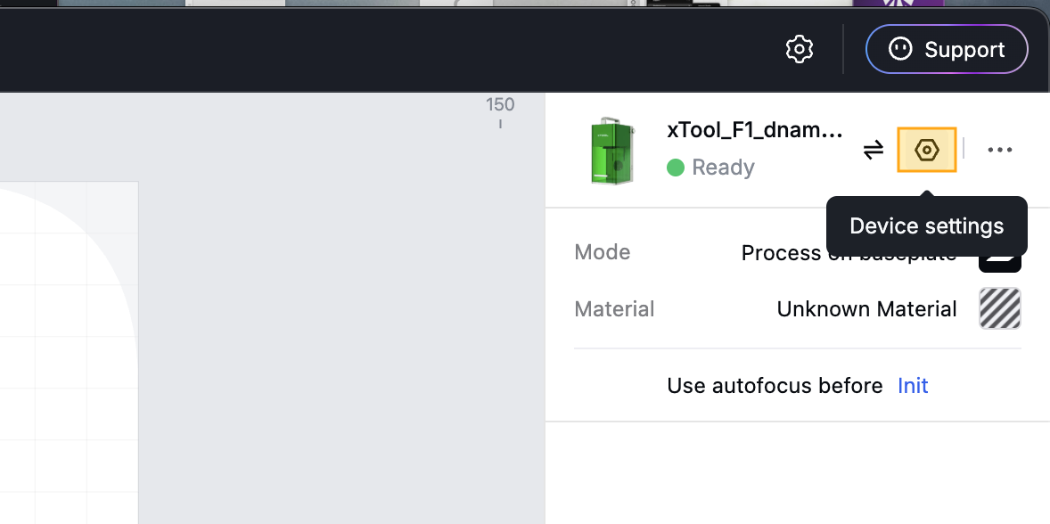

  1. Connect to your laser in xTool Studio. If this is your first time, you'll need to connect over USB. If you've connected before, you'll be able to connect however you usually do.
  2. Open the Device Settings panel in xTool Studio by clicking on the nut icon highlighted in the screenshot below. Screenshot showing the location of the device settings icon in xTool Studio
  3. In the Basic Info section, scroll down to find the Wi-Fi Setting section. You should see an IP address there. In the screenshot below, you can see the IP address of 192.168.1.169 highlighted. Copy the IP address or write it down. Screenshot showing the IP address of an xTool F1 in xTool Studio
  4. Head over to LightBurn to add your device.

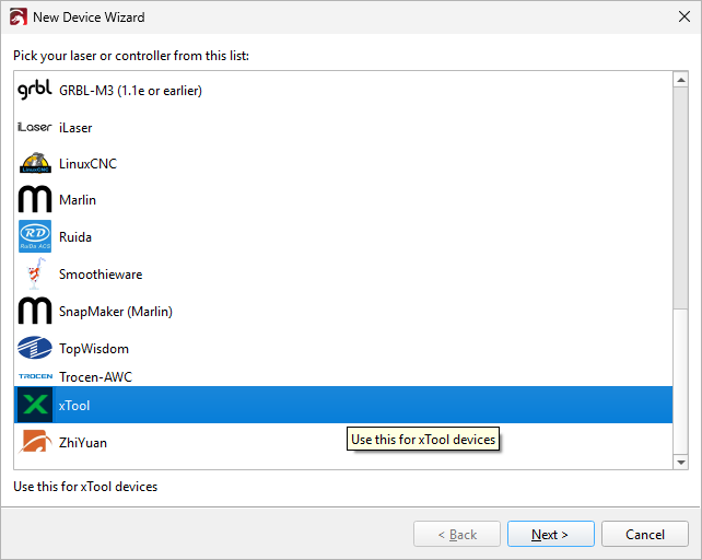

  3. In the New Device Wizard, scroll down and select xTool from the list of device types. Click Next to continue.
    Screenshot showing the device type page of LightBurn's New Device Wizard

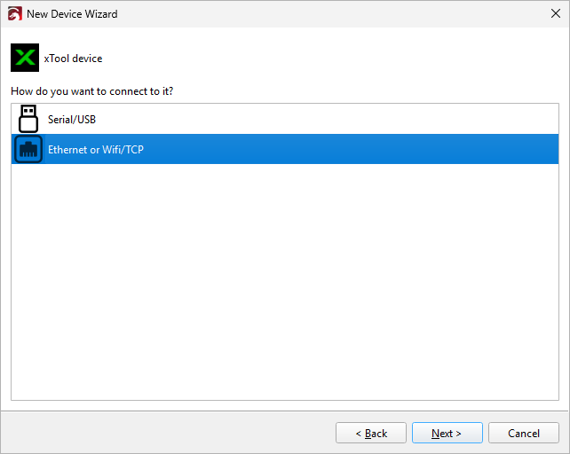

  4. Select Serial/USB if you're connecting an xTool S1, D1, or D1 Pro with a USB cable. Select Ethernet or WiFi/TCP for all other devices or connection types. Click Next to continue.
    Screenshot showing the connection type page of LightBurn's New Device Wizard

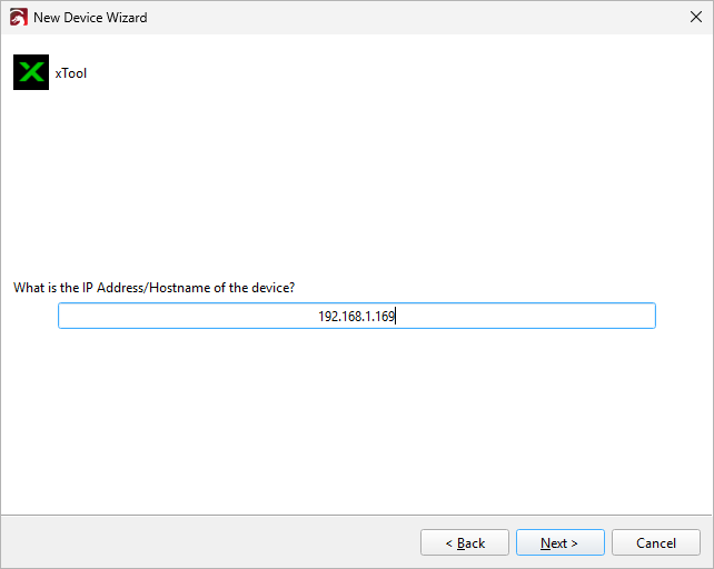

  5. Enter the IP address you found in Part 1 to tell LightBurn where to find your laser. If you're connecting an xTool S1, D1, or D1 Pro over USB, LightBurn will skip this step. Click Next to continue.
    Screenshot showing the IP address page of LightBurn's New Device Wizard

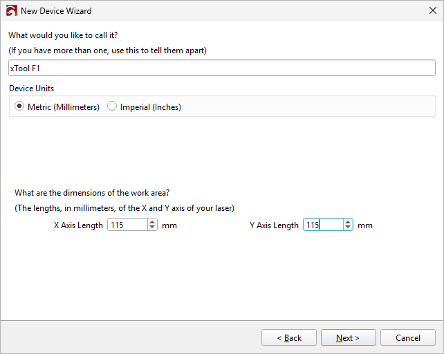

  6. Name your device something recognizable and set the dimensions of the work area to match your laser. Leave the Device Units in millimeters - if you prefer to design in inches, you can set that separately later. Click Next to continue.
    Screenshot showing where to set the device name and size in LightBurn's New Device Wizard

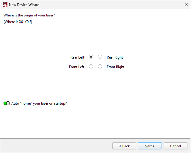

  7. Set the origin of your laser to the appropriate corner. Click Next to continue.

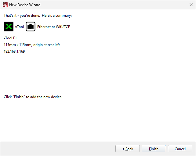

  8. Make sure the summary on the final screen seems correct. Click Back to go back and make changes, or Finish to save your changes.

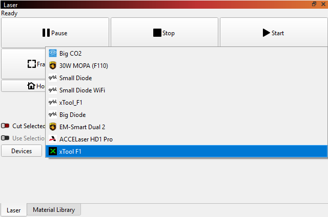

  1. If you have multiple lasers configured in LightBurn, make sure your xTool Device is selected in the dropdown in the Laser window.
    Screenshot showing the device dropdown in LightBurn's Laser Window

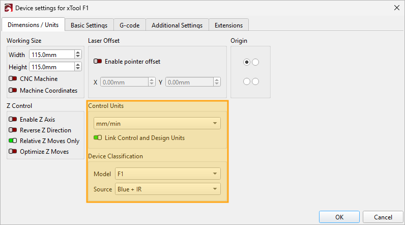

  3. In the Dimensions / Units tab, find the Device Classification section. When you add your laser, LightBurn will attempt to automatically identify it and select the correct device type. If you see unknown or the wrong device, select your xTool model from the Model dropdown.
    Screenshot showing the relevant Device Settings for xTool devices in LightBurn's Device Settings window.
  4. Adjust your Control Units if needed. These are the units that control how you set your speed.
    • xTool's material settings are given in millimeters/second, so if you want to use those recommendations more easily, choose mm/sec.
    • In general, the default of millimeters/minute has been the more common way to describe diode laser cut settings. If you want to convert a speed from mm/sec to mm/min, divide the value by 60, so 120 millimeters/minute becomes 2 millimeters/second.
    • If you usually design in inches, turn off the Link Control and Design Units toggle under Control Units. In the Settings Window you can set your Design Units to inches. Alternatively, you can set your Control Units to in / mm/sec or in / mm/min to design in inches and control your laser in millimeters.
Why is xTool F1 in your device list twice?
In one of the screenshots on this page, there are two entries for the xTool F1. One has an xTool icon, and the other has a grbl icon. The one with the grbl icon was set up in an earlier version of LightBurn, before the improved xTool support, and will not benefit from the improves in 2.2. If you've already created an xTool device in an older version of LightBurn, you should recreate it using the new setup method.

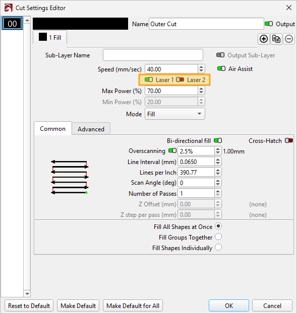

Selecting the Laser Source for xTool Lasers in LightBurn
Some xTool lasers, like the F1 and F2, are dual-source lasers and can output two different wavelengths of light to work with different materials. LightBurn 2.2's new xTool device type adds native support for switching between the laser sources, making it much easier to use both sources than in previous version of LightBurn.
To switch between laser sources on a dual source laser, double click an entry in the Cuts / Layers Window to open the Cut Settings Editor. In this window, you can choose between Laser 1 and Laser 2 to switch which laser source will be used for that layer. This also allows you to switch between the two sources in a single job. See the screenshot below for the location of the laser source toggle.
