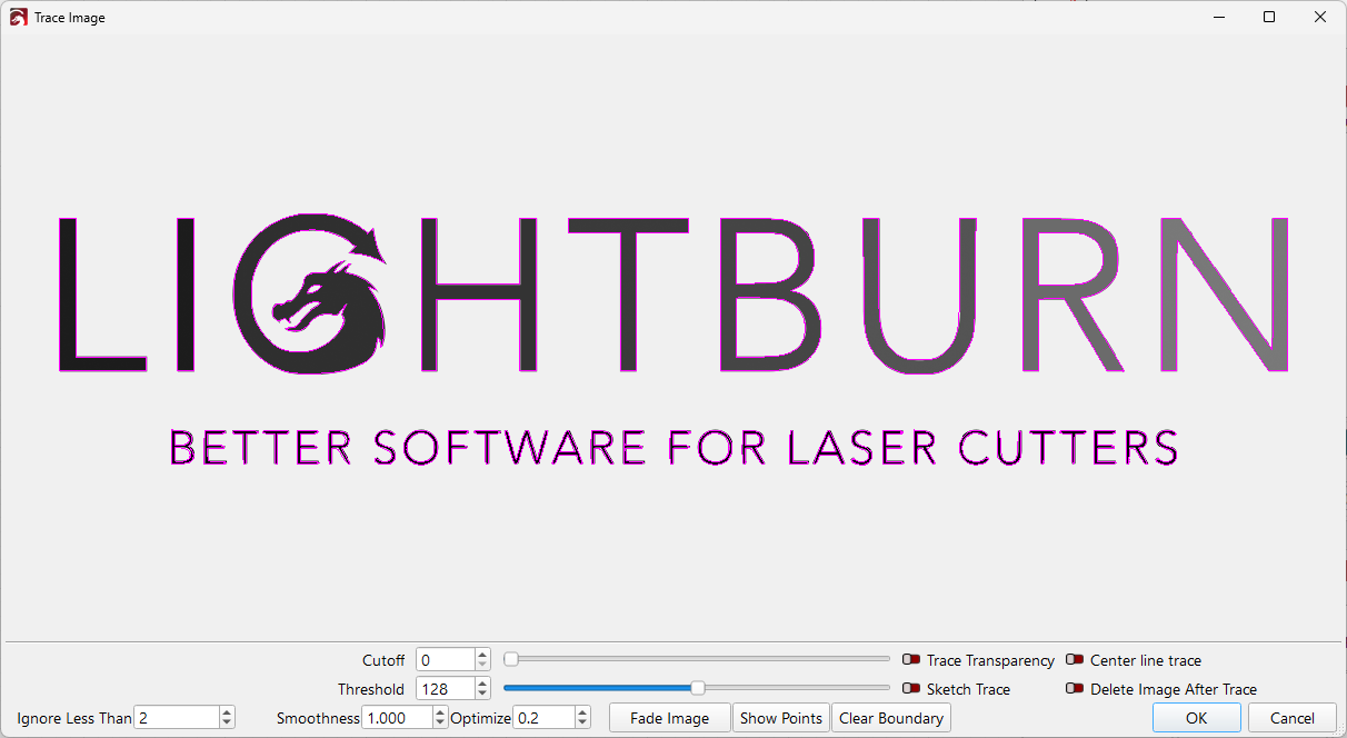

Trace Image Window
After selecting an image in your Workspace, select Tools → Trace Image, right-click the image and select Trace Image from the context menu, or press Alt/Option+T to open the Trace Image window.
Trace Image Window
In the image above, the purple lines are the vectors that LightBurn has produced from the image being traced. As you adjust settings in the Trace Image window, the purple lines will change to reflect the new vectors that will result from the updated settings.
You can Zoom and Pan the preview using the same controls as in the Workspace, and double-click the middle mouse button to reset the view.

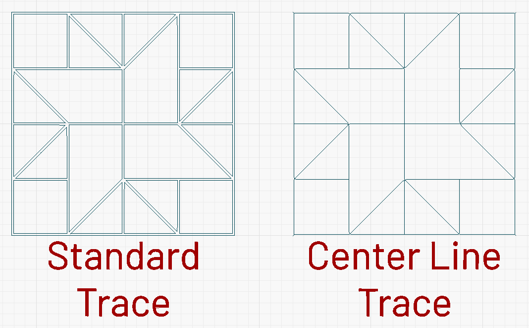

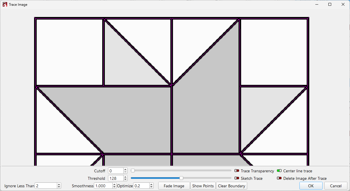

Center Line Trace
Use Center Line Trace to trace along the center of a line rather than around the edges. You can use Center Line Trace to turn line art like the quilt block below into vector paths to cut out.
center line trace
The comparison image below shows a standard trace result next to Center Line Trace for the same image.
center line and standard trace comparison

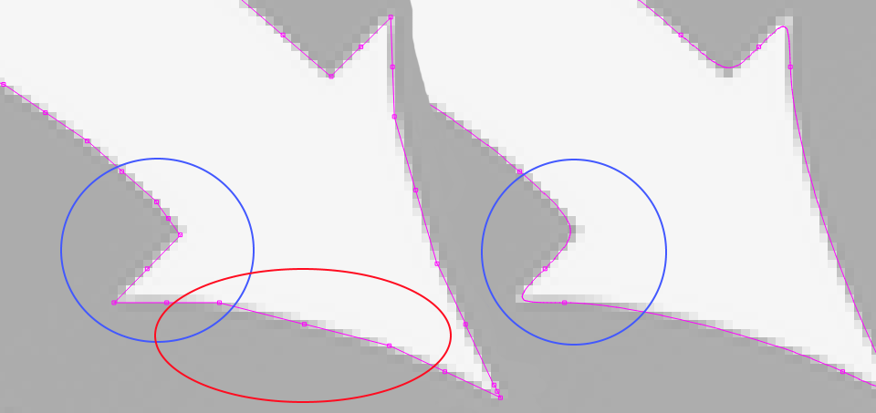

Smoothness
Increase Smoothness to turn more line segments of the resulting vector into curves. Set it to 0.0 to create only lines (left), and 1.33 to create only curves (right).
