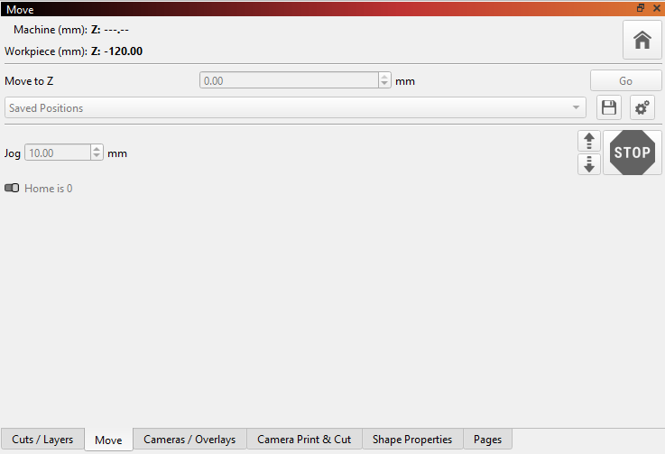

New EZCad 3 Move Window
Screenshot of the EZCad3 Move Window
After adding an Adding an EZCad3 device with a motorized Z axis to LightBurn, you'll have an alternate version of the Move Window available for controlling the Z axis.
Enabling the Move Window for EZCad3
You need to set the Z Axis Height (the distance the Z axis can travel) to be able to open the EZCad3 Move Window. This can be done when you're adding your laser or in the External Axes Settings. If you don't see the Move Window, make sure the Z Axis Height is set, and then go to Window → Move Window.
Screenshot showing the position readout and home button of the EZCad3 Move Window
Position Display
When your laser is connected, the Machine: Z and Workpiece: Z sections of the Move window will show the current position of the Z axis. The Machine section shows the position relative to the machine itself, and the Workpiece section shows the position relative to your material.
Home Z Axis
The Home Z Axis button will home the Z axis using a limit switch to find the origin, similar to homing the X and Y axes on a gantry laser.
Screenshot showing the Move To and Saved Positions section of the EZCad3 Move Window
Move to Z
Enter a number into the Move to Z section and click Go to command your laser to move the Z axis to the position you've set. You can use this to go to an exact height without needing to jog precisely.
Saved Positions
Use this section of the window to choose, save, and manage Saved Positions.
  • Select a saved position from the dropdown and click Go to move the Z axis to the selected position.
  • Click the Save icon to save the curent position into the list of Saved Positions.
  • Click the gear icon to Manage Saved Positions.
Screenshot showing the Jog section of the EZCad3 Move Window
Jog Distance
The Jog Distance is the distance your Z axis will move when you use the Jog Controls. Set it with the numeric entry box on the left. This allows you to move large distances when needed, or reduce the distance when you need to jog very precisely and get a position exactly right.
Jog Controls
Use the Up, Down, and Stop buttons on the right to jog your laser. The up and down arrow buttons will jog your laser up and down by the distance shown in jog distance, and the stop button will stop the jog if you need to interrupt it.
