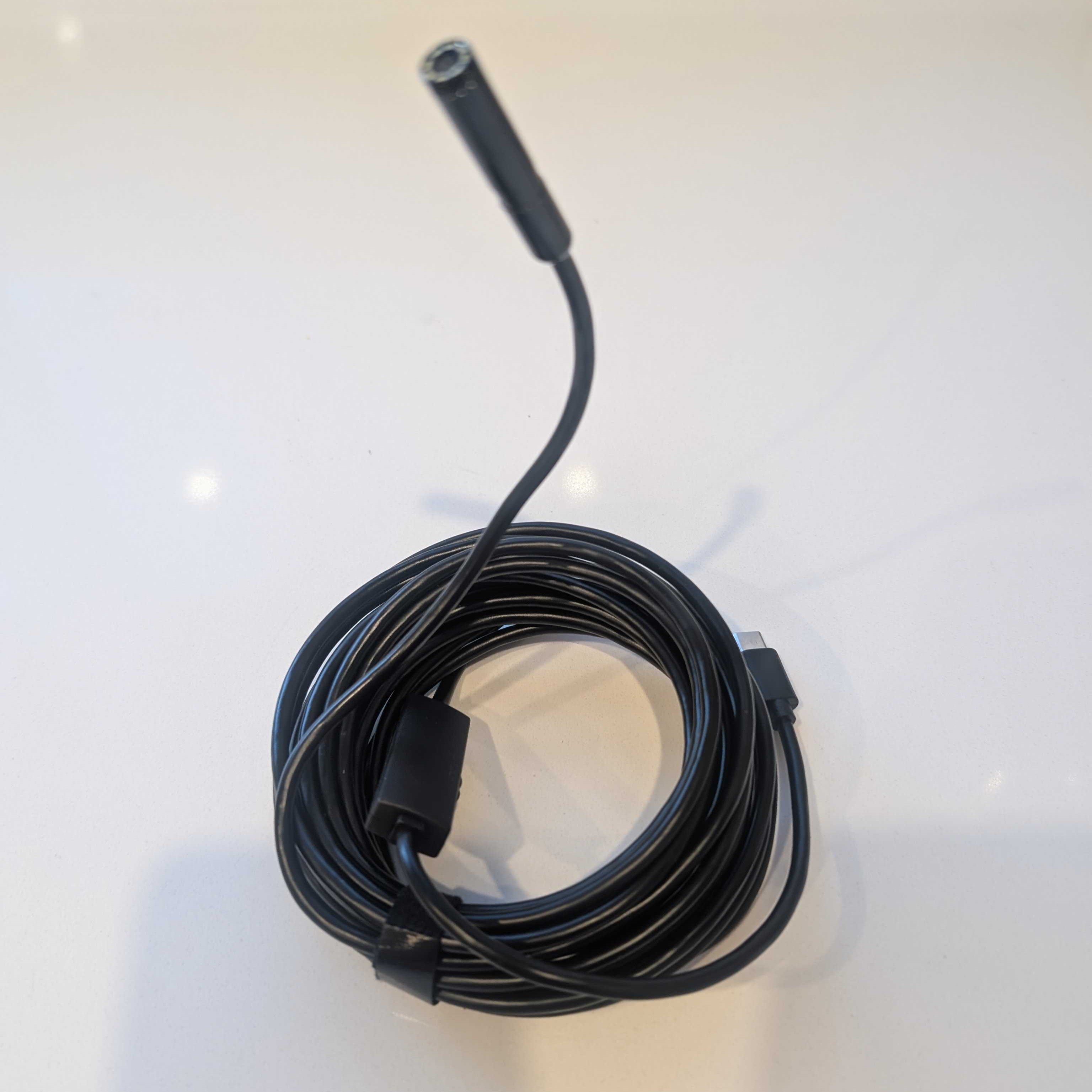

With growing interest in Head Cameras for compatibility with our new Camera Print & Cut feature, we've had more people asking for guidance on what to purchase.
If your laser didn't come with a head-mounted camera pre-installed, we recommend an inexpensive USB Endoscope Camera with a long, flexible USB cable. These cameras are also sometimes listed as a "USB Inspection Camera". Avoid cameras with built-in screens or rigid or semi-rigid cables that will interfere with your laser's motion. As of October 2026, these cameras are typicallly available for about $15-30 or €20-30 from common online retailers.
Example image of an endoscope camera with a coiled cable. This one has a semi-rigid cable but you should look for one with a flexible cable
Example image of the type of endoscope camera to look for. This one has a semi-rigid cable, but you should look for one with a flexible cable.
If you want to explore other options, any small, light camera you can mount securely to your laser head and connect to over USB or WiFi should work. Keep in mind that WiFi cameras that use RTSP will not work - IP cameras need to output individual frames or an MJPEG feed.

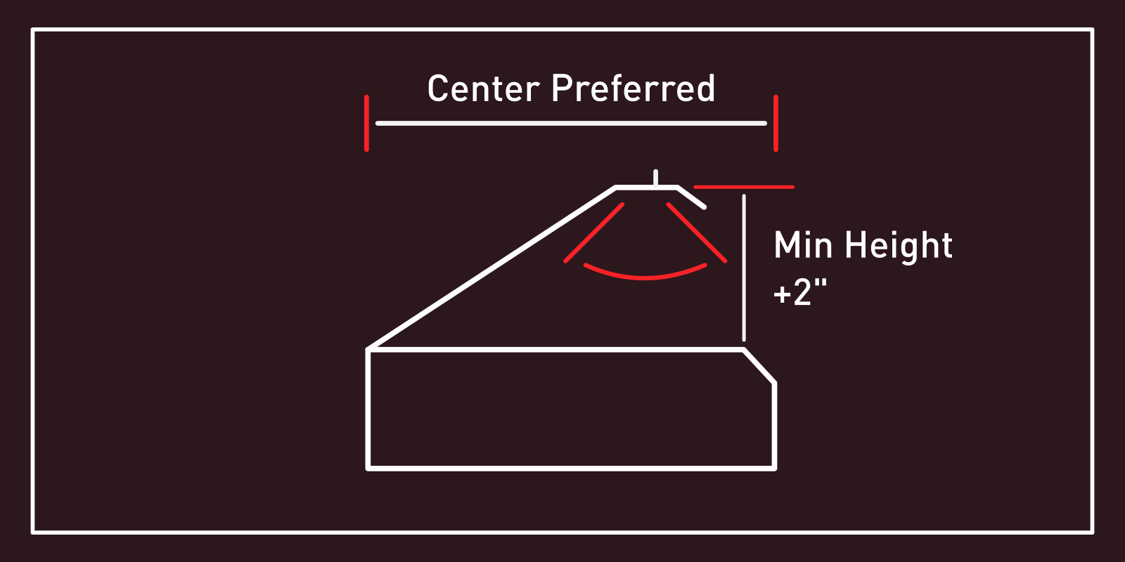

To select a camera, you'll need to know two things:
  1. The size of your laser's work area, in millimeters.
  2. The distance between the height from which you want to mount the camera and the surface of your laser's work area.
Diagram showing ideal mounting location
If that seems like a lot, don't worry - we've got tools to make it easy!

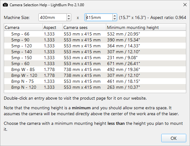

Camera Selection Help Window
The Camera Selection Help window helps you select an appropriate camera for your laser. The information provided is specifically for the USB cameras sold on LightBurn's Website, which are known to work well with LightBurn and have calibration presets built into the software for easier Lens Calibration.
Go to Help → Camera Selection Help to open the window.
To select a camera:
  1. Enter the machine size into the Camera Selection Help window.
  2. Look through the list to find a camera with a minimum mounting height about 2 inches less than the height you intend to mount at. This leaves room for adjustment.
  3. Double-click an entry in the list to visit the product page to purchase it.
