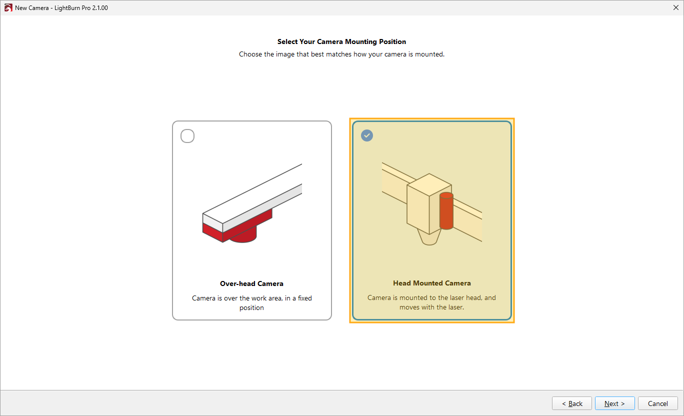

After calibration, when it's time to perform the Camera Workspace Alignment, choose the Head Camera option.
Screenshot of selecting a head camera

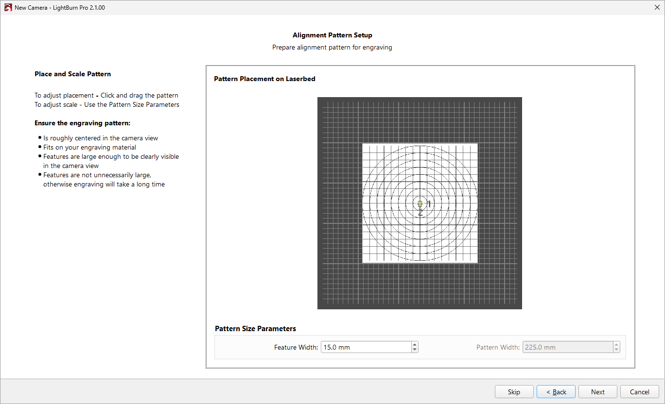

2. Alignment Pattern Setup
The automatic alignment process and the manual alignment process use different patterns, but the process is similar. Regardless of which pattern you're using, you can adjust the Feature Width under Pattern Size Parameters to adjust the size of the markings and the overall pattern size. The pattern should be:
  • Roughly centered in the camera view.
  • Sized to fit on your engraving material. Adjust the overall size by changing your Feature Width.
  • Created with features large enough to be clearly visible in the camera, but not so large they take an excessively long time to engrave.

Manual Alignment Pattern

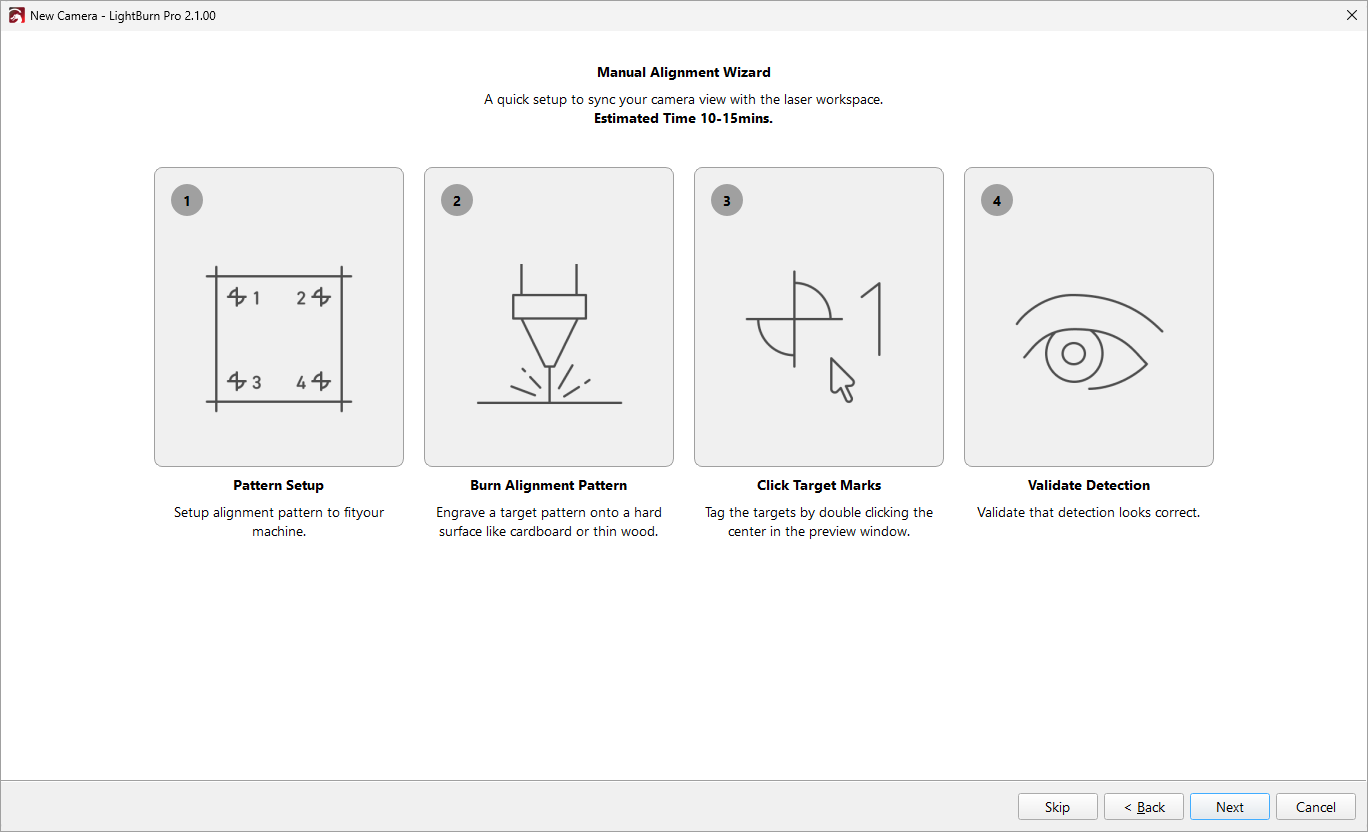

The manual alignment pattern engraves a set of markers for you to identify, and uses them to guide you through aligning the camera to the workspace yourself.
Screenshot of Manual Alignment Pattern Setup

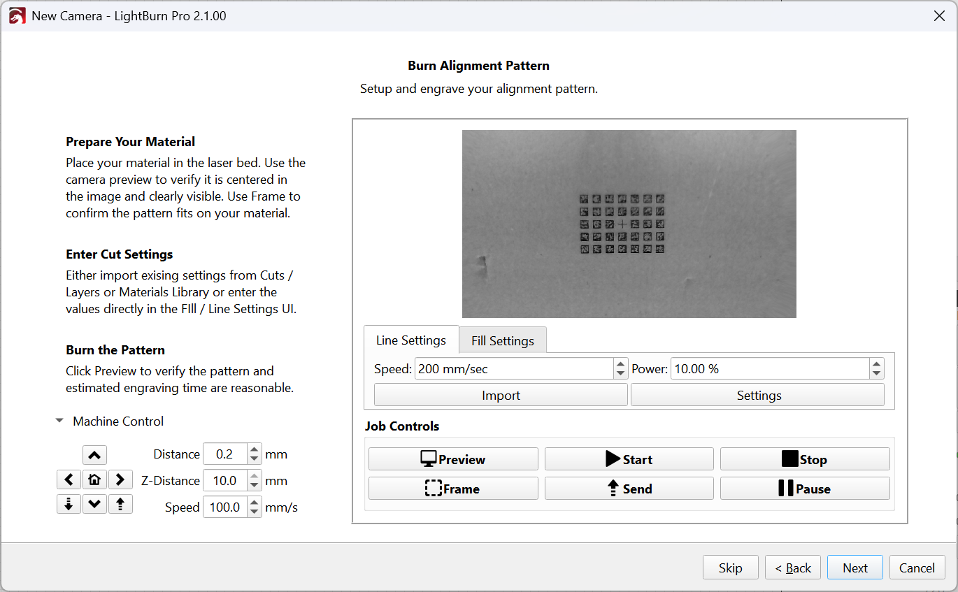

This step is the same between automatic and manual alignment, even though the actual pattern is different. Place your material in the laser cutter, make sure it's focused, and get ready to burn the alignment pattern.
Screenshot of burning alignment pattern
Use the camera preview to make sure the material is near the center of the image and clearly visible. Use Frame to make sure the pattern fits the material, and use Preview to see what will actually be burned. Use the Machine Control section in the lower left to move your laser head around if needed.
Adjust your cut settings to engrave a dark, crisp mark without cutting through the material. You can adjust your settings in a few ways:
  • Adjust speed and power right in the Alignment Wizard window, just below Laser Settings.
  • Click the Import button to load a layer from your Material Library.
  • Click Settings to adjust your layer settings in the Cut Settings Editor.
Run the job using Start or Send, however you'd usually control your laser.
Do not move the pattern after you burn it, or you will need to burn a new alignment pattern.

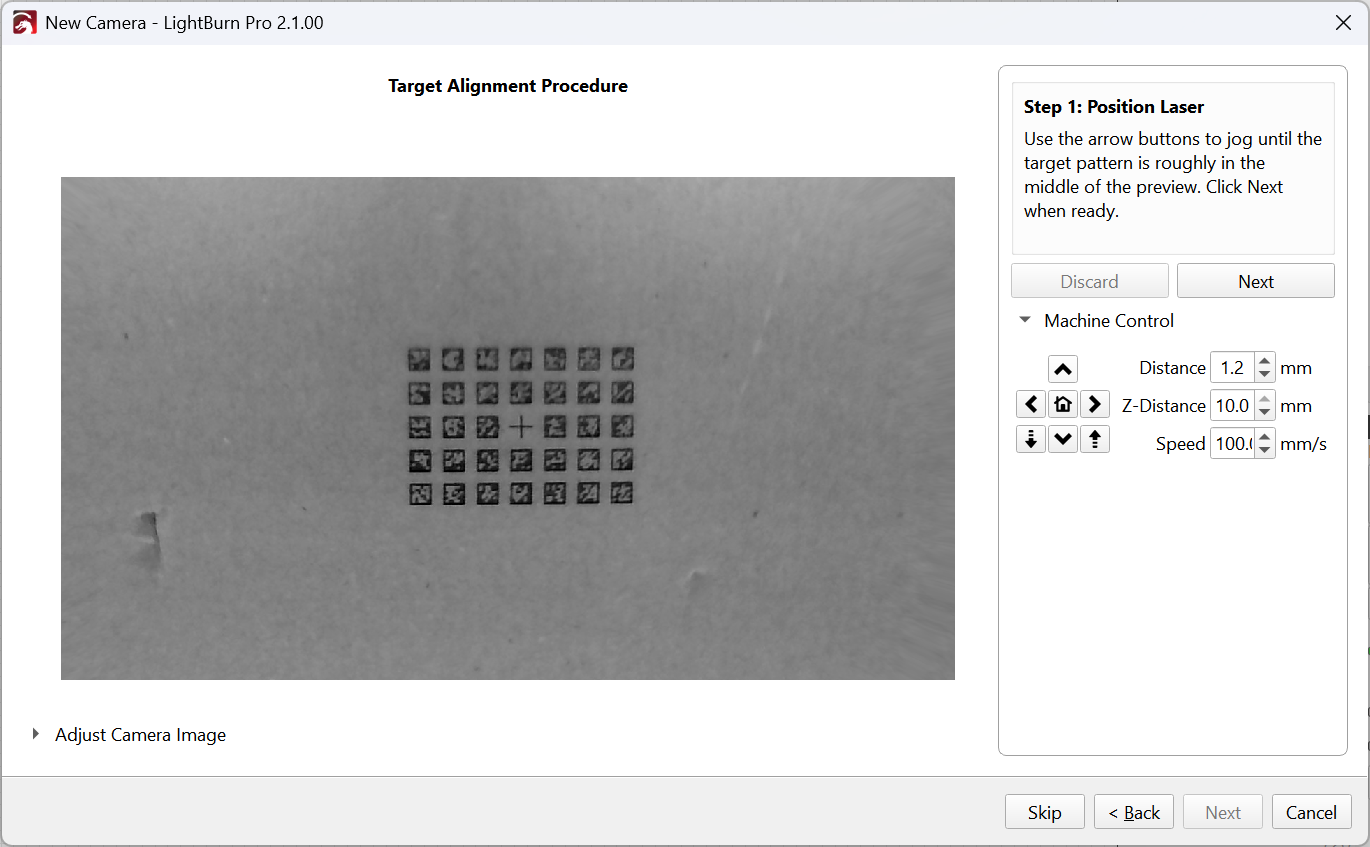

1. Position Laser
Start by using the arrow buttons to jog until the target pattern is roughly in the middle of the camera preview, then click Next.
Screenshot of automatic target alignment process

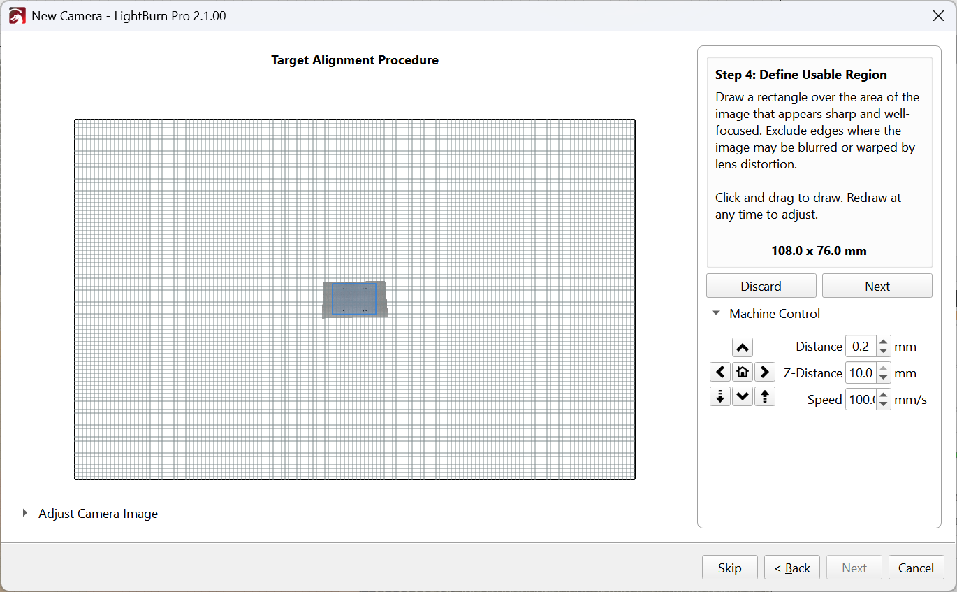

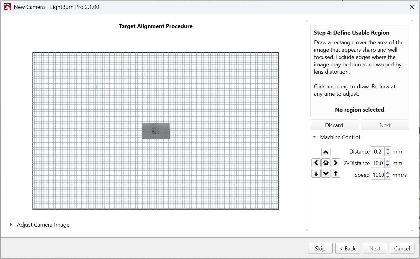

4. Define Usable Region
Click and drag to draw a rectangle over the portion of the image that appears sharp and well-focused. Leave out edges where the image is blurred or warped by lens distortion. You can redraw as much as you want to adjust this. Click Next to save the camera alignment, then Finish on the final screen.

Manual Target Alignment will walk you through identifying the centers of the targets you've engraved and identifying the portion of the camera's view that's clear and well-focused.

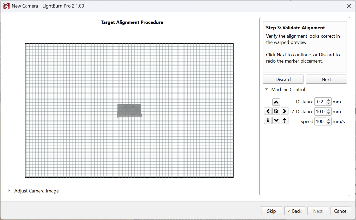

3. Validate Alignment
Make sure the alignment appears correct in the projected camera preview. Click Next to continue, or Discard to try again.

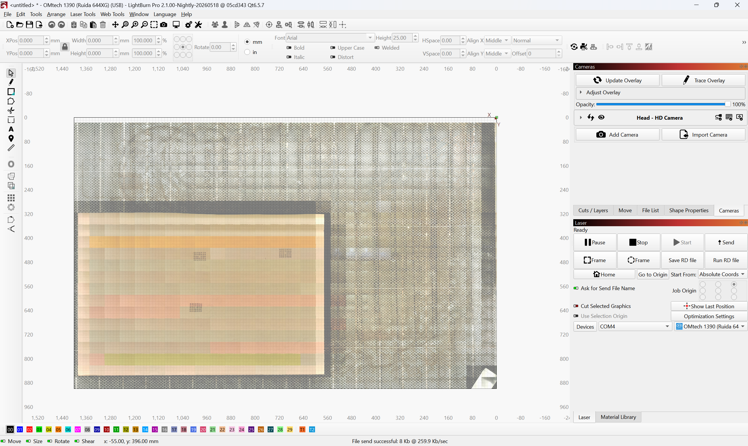

Capturing an Overlay
LightBurn 2.2's new [Cameras / Overlays] window has three options for capturing overlays with your Head Camera.
  • Single, which captures a single frame at the laser's current location using your Head Camera.
  • Selected, which captures the area around selected shapes using your Head Camera.
  • Workspace, which captures the entire workspace.
You can read more about Head Cameras and Overlays in the Cameras / Overlays window.
Example Head Camera Overlay
