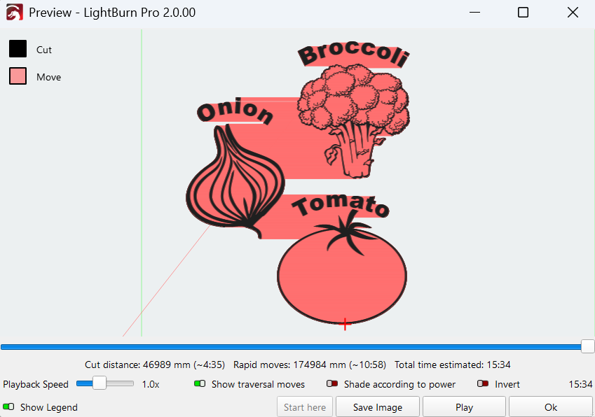

Preview Window Time Estimates
The Preview window simulates movements and lasering operations before sending a project to the machine. You can use it to see the order in which cuts will be completed, and check that your laser will do what you expect, but that's not all.
One of the most useful features in the Preview window is the ability to calculate and show the Total estimated time it will take your laser to complete your project. As you make changes to optimize your project's runtime, check back in the Preview window to see which settings result in the fastest times.
Learn More
Video: Getting Accurate Time Estimates
The Additional Settings tab of Device Settings controls the settings used in Preview for simulating a preview and estimating time. Changing these settings will not change anything about how the job actually runs, but can make time estimates more accurate.

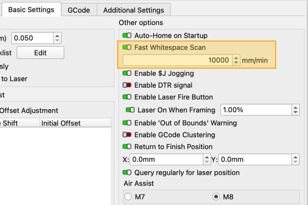

Fast Whitespace Scan
Note
This setting is only available for GCode-based lasers.
This setting boosts your laser's travel speed through blank areas of an engraving, if the speed you set here is faster than your laser's engraving speed.
This can save a lot of time if you're engraving a design slowly to get a good burn, particularly if there are large blank areas. This setting applies to both images and filled vector engravings.
Learn More
Fast Whitespace Scan in the Device Settings window
