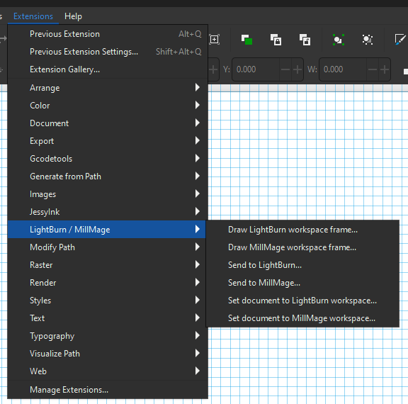

After installation, six new commands appear under Extensions → LightBurn / MillMage:
- Set document to LightBurn/MillMage workspace — sizes the current document to the machine's workspace. (see Document size).
- Draw LightBurn/MillMage workspace frame — fetches the machine's workspace size and draws it as a dotted, brand-coloured background rectangle.
- Send to LightBurn/MillMage — uploads the drawing.

3. Restart Inkscape¶
The commands appear under Extensions → LightBurn / MillMage.
Using the Extension¶
- Make sure LightBurn / MillMage is open (the API listens whenever the app is running).
- In Inkscape: Extensions → LightBurn / MillMage → Send to LightBurn (or Send to MillMage).
