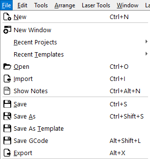

File Management options in the File Menu
File Management options in Main Toolbar

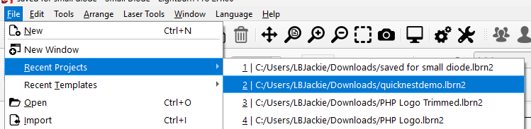

Recent Projects
Hover over Recent Projects in the File Menu to open a submenu containing a list of projects you've recently worked on and Saved.
Click any file in the list to Open it.

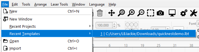

Recent Templates
Hover over Recent Templates in the File Menu to open a submenu containing a list of Template Files you've recently worked on and Saved.

Save
Ctrl/Cmd+S
.lbrn and .lbrn2
The Save and Save As commands offer the option of saving as .lbrn2 (default) or .lbrn (LightBurn Legacy Project).
Unless you need to maintain compatibility with extremely old versions of LightBurn or need an easily human-readable file, we recommend leaving the file type set to .lbrn2.
Saves your current project in .lbrn or .lbrn2 format.
  • If you haven't Saved it previously, a dialog window will open where you can name it and choose the location to Save it.
  • If you have already Saved a copy, the existing copy will be immediately overwritten with any new changes you've made.

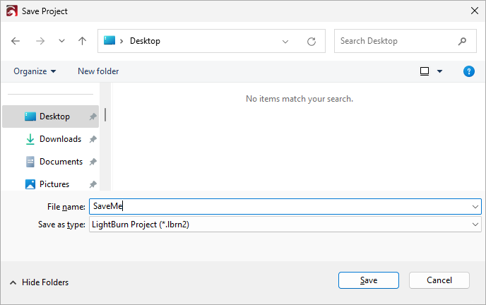

Save As
Ctrl/Cmd+Shift+S
Rather than immediately overwriting your existing file, Save As opens a dialog window where you can save a renamed copy to a new file, leaving the current file unchanged.

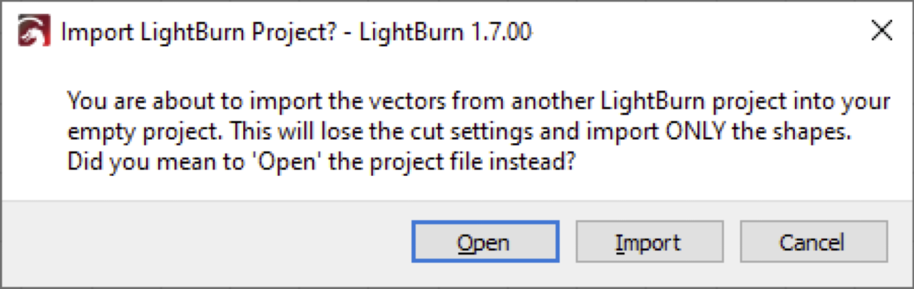

Importing .lbrn or .lbrn2 files
It is also possible to Import .lbrn or .lbrn2 files — however, Importing these types of files does not load the cut settings or any other project-specific information saved to the file. Only the graphics will be loaded.
In order to load graphics along with all other settings, you must use Open instead.
LightBurn will warn you if you attempt to Import a .lbrn or .lbrn2 file.
Click Open to load the graphics and all other settings, Import to load only the graphics, or Cancel to abort the process.
