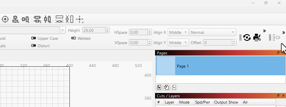

You can find both Quick Nest and True Nest in the Docking Toolbar or by going to Arrange → Nesting.
Accessing the Docking Toolbar

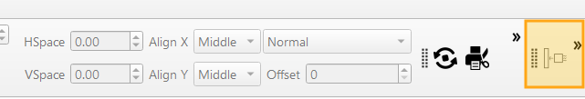

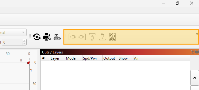

By default the Docking Toolbar is in the top right corner of the screen. Depending on your screen size, you may see a short version like in the screenshots below, with an arrow to the right to expand the toolbar. For the rest of this page, we'll use the full version of the toolbar in screenshots.
Screenshot of the condensed docking toolbar in context
Screenshot of the extra condensed docking toolbar in context
To see all the options, you can expand the toolbar with the arrows to the right, drag it to the left to give it more space, drag it to another toolbar with more space, or drag it out of the toolbar area entirely. All four are shown below.

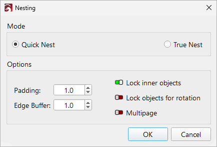

  1. Create a rectangle to use as a container for the shapes you want to nest.
  2. Select the container and all of the objects you want to nest.
  3. Open the Nesting Dialog by clicking the Nesting button or going to Arrange → Nesting.
  4. Select Quick Nest and adjust your Nesting options.
  5. Click OK to nest your shapes.
Nesting Dialog
Mode
Choose between Quick Nest and True Nest.
Options
These options are shared between Quick Nest and True Nest.
Padding
Sets the minimum distance between the parts to nest. The units are either millmeters or inches, depending on your Design Units. Increase this number to leave more space between parts.
Edge Buffer
Sets the minimum distance between the parts to nest and the edge of the container you're nesting in. The units are either millmeters or inches, depending on your Design Units.
Lock Inner Objects
If Lock Inner Objects is enabled, inner objects move with the objects surrounding them, whether or not they're grouped. In the demonstration at the top of the page, Lock Inner Objects keeps the inner shapes of the letters and the dragon's eye in place while nesting without having to group them.
Lock Objects for Rotation
Enable this to lock the rotation of objects being nested. Disable this to allow LightBurn to rotate the objects as part of the nesting process. Quick Nest rotates in 90 degrees increments if this is enabled. True Nest offers more rotation options in a secondary dialog.
Allowing rotation can improve material usage, but may not work well for all designs, particularly when cutting parts from material with a visible grain.
Multipage
With Multipage enabled, if you try to nest more objects than fit in your target container, LightBurn will create additional pages with a copy of the original container to continue the nesting process. With Multipage disabled, LightBurn will nest as many objects as it can and leave the rest unnested.

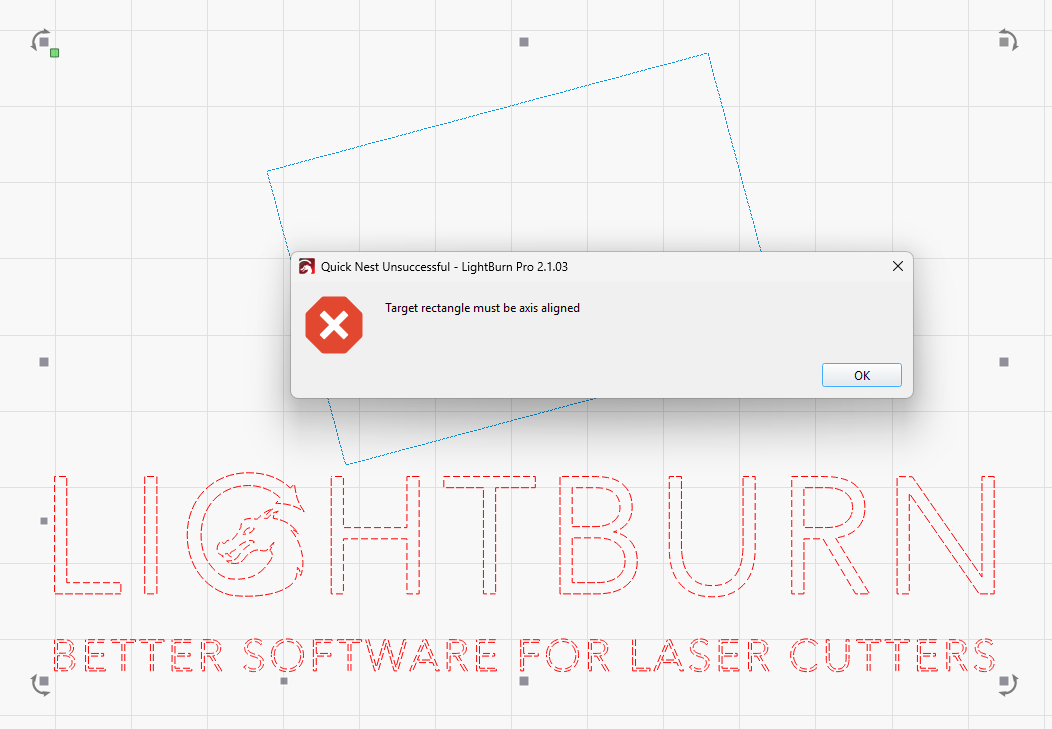

Target Rectangle Must be Axis Aligned
To use Quick Nest, the rectangle you're nesting into must have sides that are straight up and down and sideways.
If you get this error, make sure your bounding box is a rectangle and that it's not at an angle.

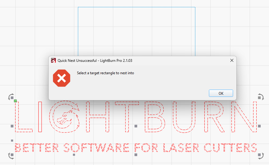

Select a Target Rectangle to Nest Into
If you get this error message, LightBurn doesn't see a selected rectangle to use as a container.
Fix the error by selecting a rectangle to arrange your parts inside of in addition to the parts to be nested. In the example below, the blue rectangle wasn't selected, so LightBurn has nothing to nest the parts into.
Screenshot of error message
Why is the I in LightBurn not selected?
In the screenshot above, the letter I in LightBurn isn't selected, because selecting it and not the larger blue box results in a different error. The reason for this is a bit technical, but if you're interested, keep reading.
The letters used in the demo file here are actually paths, not text objects, and the letter I would be a valid rectangle to nest into if it were big enough. This isn't a problem when the larger blue rectangle is selected, but when I don't select that rectangle, Quick Nest tries to nest into the I. This actually could have resulted in one of two different error messages:

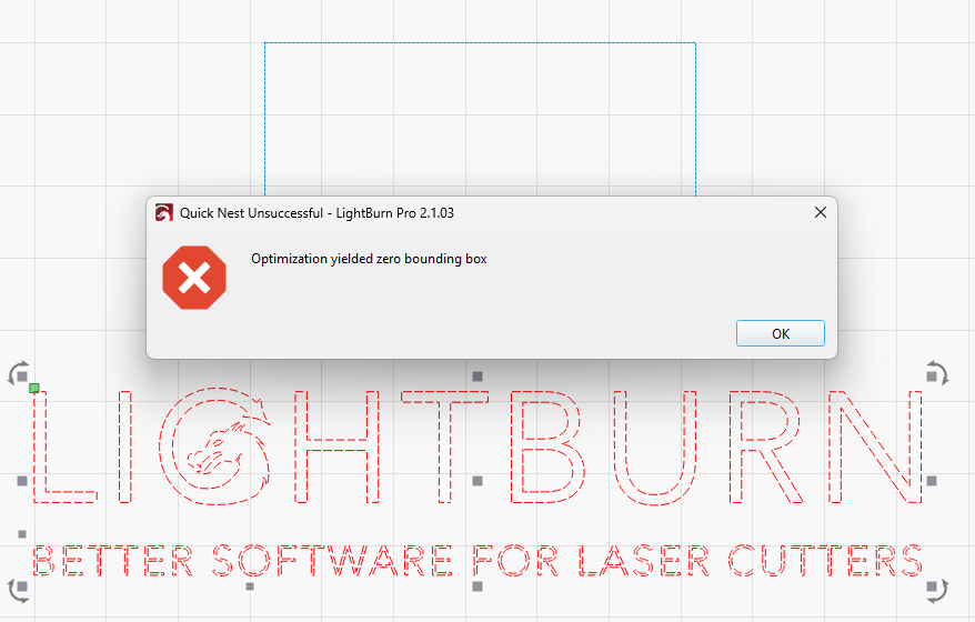

  1. Optimization Yielded Zero Bounding Box: If none of the shapes selected are small enough to nest inside the I, Quick Nest will be unable to create a suitable arrangement and you will receive this error.

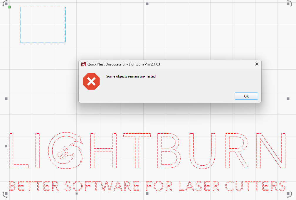

  2. Some Objects Remain Un-Nested: If there are shapes small enough to be nested into the I, Quick Nest will nest the objects it can, and you will receive this error.
If you get this error message, one or more of the parts you're trying to nest are to big to nest in your selected rectangle with the current settings.
When you press OK, LightBurn will still nest as many of the parts as possible, leaving out the ones that can't be nested. If your target rectangle is big enough to nest your largest part, you will not see this error message.
If you get this error message, it means Quick Nest is unable to create a suitable arrangement at all.
In certain circumstances, if you don't select a rectangle to nest into you can get this error message instead of Select a Target Rectangle to Nest Into. In the screenshot below, the blue rectangle isn't selected, but the red I, which is actually a rectangle, is selected. Quick Nest tries to nest into the I and fails, resulting in the Zero Bounding Box error. More about how this happens.

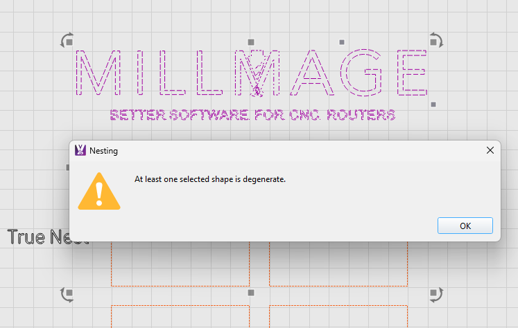

At Least One Selected Shape is Degenerate
If you get this warning message, it means at least one of the shapes you're trying to nest is degenerate, or invalid.
Degenerate Shapes?
Without getting into a full scale math lesson, a degenerate shape is a special case of a shape. Examples might include a line with a length of 0, or a triangle where all 3 points are on the same line.
When you press OK, LightBurn will proceed to nesting all valid shapes.
