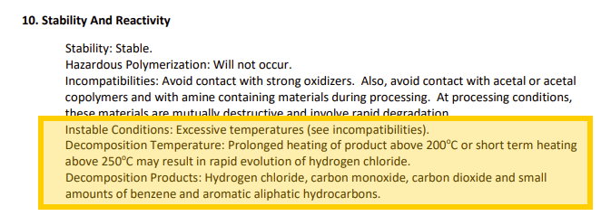

  • Be careful with your material choices. Lasers are versatile and can cut a wide range of materials, but not all of them are safe to cut. We've listed a few common examples below, but can't list every hazardous material. If you're unsure whether it's safe to burn a material, a good starting point is to look for an SDS (or your country's local equivalent) and look for firefighting precautions and decomposition products/conditions. Excerpt from a PVC SDS
    • PVC is a common material that you should never laser — burning PVC or significantly heating it releases hydrogen chloride gas, which is corrosive both to your laser and your lungs. Never laser PVC or any other plastic that contains chlorine.
