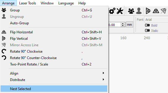

  1. Select any graphics you'd like to nest along with a container shape — usually a shape that has the same dimensions as the material you are going to cut the nested graphics out of — then go to the Arrange Menu and click SVGNest (External Tool).
    Important Note on Inner Shapes
    LightBurn does not export graphics that are contained inside another graphic — this means all of the graphics you'd like to nest must be outside the container shape you choose.
    Once your graphics have been nested within the container shape and re-imported, LightBurn will automatically move any shapes that were contained within them so they maintain their relative position.
    Nest Selected in the Arrange Menu
