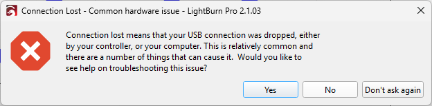

Laser Doesn't Stay Connected To Computer
If your laser connects to the computer but loses its connection, you'll need to find what's causing the lost connection. You may see the following error message.
Screenshot of the connection lost error
Connection lost meants that your USB connection was dropped, either by your controller or your computer. This is relatively common and there are a number of things that can cause it. Would you like to see help on troubleshooting this issue?
Please try the following if you're losing your connection to the laser:

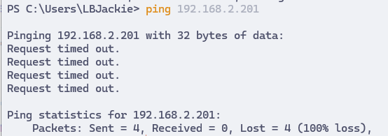

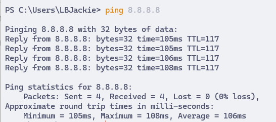

  • If you're using an ethernet connection, it's possible that the IP address you configured in LightBurn no longer points at the the laser. To test this, you can ping the laser. Click the blue box below for directions. If your computer can't communicate with the laser over the network, LightBurn won't be able to either.
    Testing network connections
    I'll use the IP address 192.168.2.201 as a placeholder, but you should replace it with your own laser's IP address.
    1. Go to Device Settings - Basic Settings and find the IP address you used for your laser.
    2. Open the command prompt. You can do this by opening Power Shell on Windows or Terminal on Mac.
    3. With the laser on, run the following command: ping <IP_ADDRESS>, so in my example it would be ping 192.168.2.201.
      Failed Ping
      A ping that failed to connect. No devices are present at the specified address.
      Successful Ping
      A successful ping. There is a device at this address.
    4. If you had an unsuccessful ping, your computer can't see your laser on the network. Make sure the IP address matches the one set on the controller.
    5. If you had a successful ping, it's possible that another device on your network is using the IP address and is interfering with communications. Turn off your laser and try again - if you still get a successful ping, it's coming from something other than the laser. Change your IP address on both the laser and in Device Settings.
