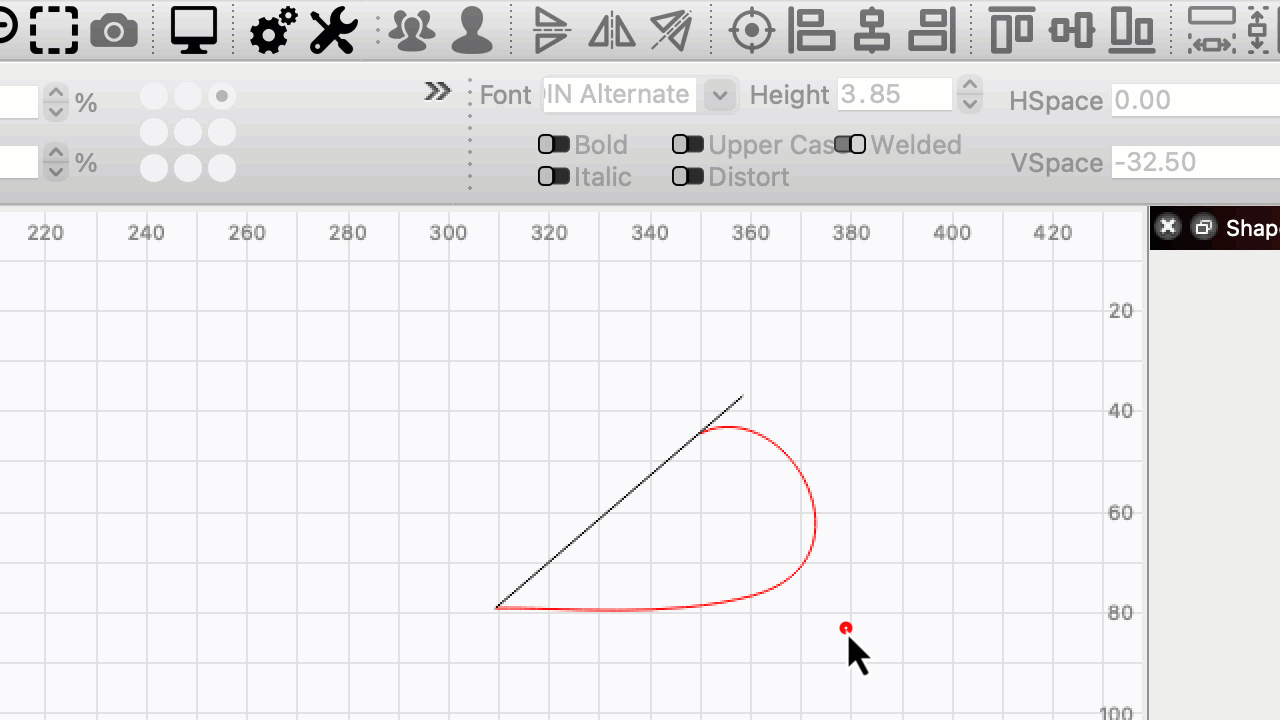

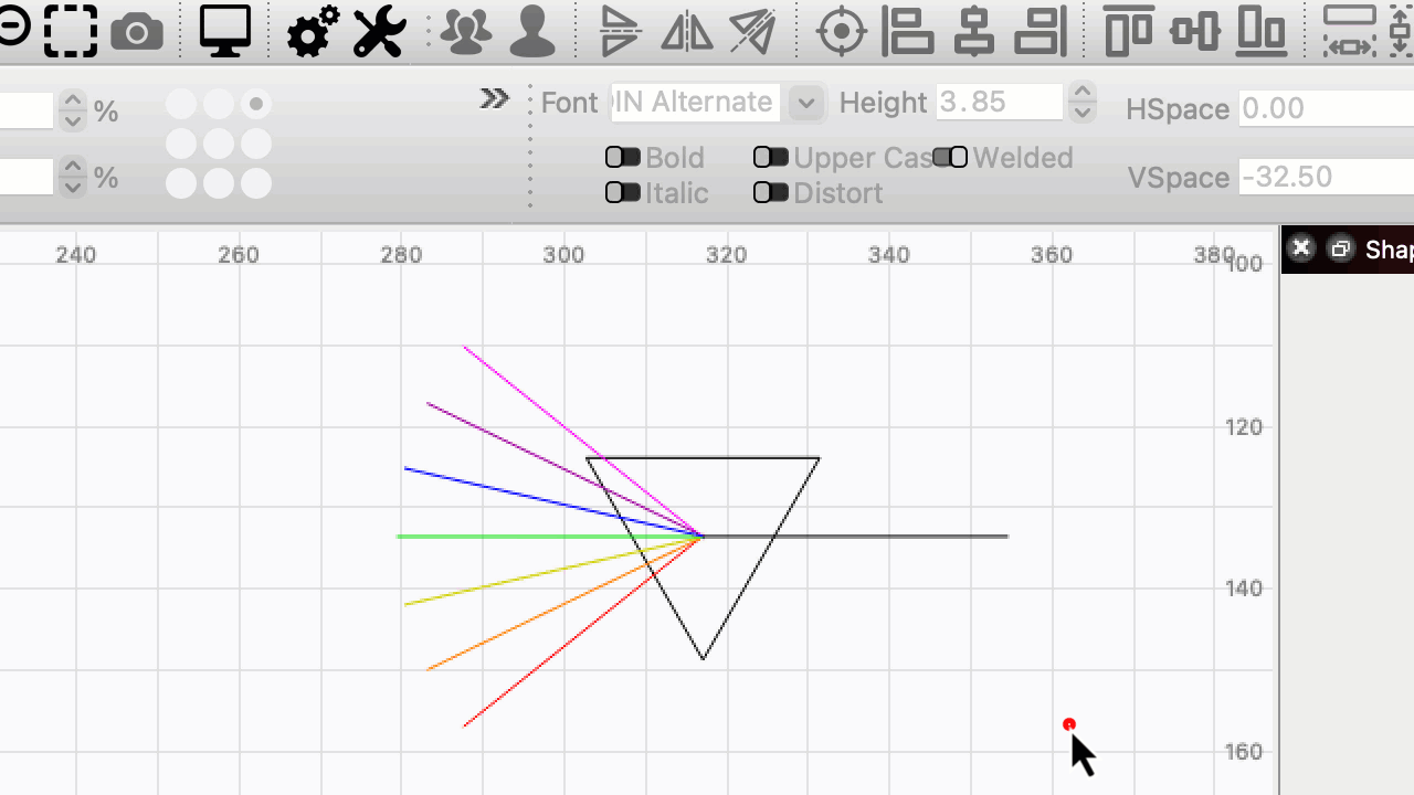

Mirror Across Line¶
**Mirror Across Line **is available in the Arrange Menu, Arrange Toolbar, and by hotkey (see below).
Mirror Across Line creates a mirrored duplicate of your selection across a custom-selected line.
- The line must be the last object added to your selection — in other words, you must first select the objects you'd like to Mirror, then select the line you'd like to Mirror them across.
- The line must be a straight line with only two points.
Use Mirror Across Line to create a symmetrical shape
Draw half the original shape, then mirror it to create the other half, like this:
