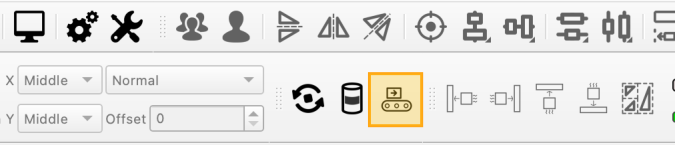

To configure your external axis' motion parameters and enable the Split Marking tool, click the conveyor icon in the Modes Toolbar.

Click the Conveyor icon in the Modes Toolbar to open the Split Marking Setup window.
The Split Marking conveyor icon in the Modes Toolbar

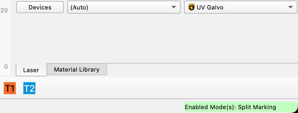

Enable Split Marking
This switch controls whether Split Marking Mode is enabled. When enabled, you'll see a status indication in the bottom right corner of your screen:
Rotary Mode Enabled
