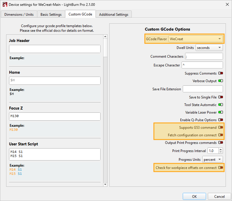

The WeCreat Vision needs to be set up as a Custom GCode device, either using Create Manually or by importing a pre-configured bundle.
If you choose to add the machine manually, or already added one and aren't sure the machine is set up correctly, please make sure you use the following settings in the Custom GCode tab of Device Settings.
  • GCode Flavor must be set to WeCreat.
  • Supports G53 command must be disabled.
  • Fetch configuration on connect must be disabled.
  • Check for workpiece offsets on connect must be disabled.
Screenshot of WeCreat settings

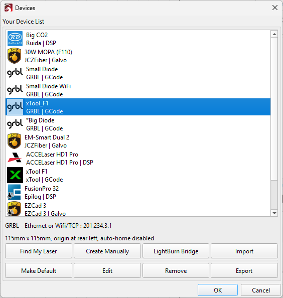

LightBurn 2.2 brings significant changes to how xTool devices are configured and used in LightBurn. Please see our xTool page for additional information on setup and device support.
Existing xTool Devices
If you've already set up an xTool device in previous versions of LightBurn, you'll need to re-add the device to LightBurn.
Screenshot showing the xTool F1 installed using the old GRBL configuration and the new xTool device type
In the screenshot above, you'll see the xTool F1 listed twice. The highlighted one has a grbl icon and was created using a .lbdev file. This older device setup should not be used for xTool devices in LightBurn 2.2. The new xTool device type, represented with an xTool icon, offers more support for xTool features, an easier installation process, and support for a wider range of machines.
What to Do
If your xTool device was set up before LightBurn 2.2 or has a grbl icon:
  • Make sure you know where your Material Library is if you're using one.
  • Add your xTool device using our updated directions for 2.2.
  • Load your Material Library if you have one to load from an old xTool device.
  • Delete the older xTool device.
