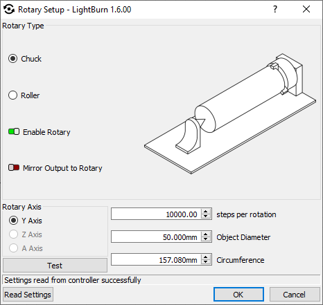

Rotary Mode
Rotaries are used to turn cylindrical objects so that their surfaces can be marked by a laser. In order to use your laser with a rotary, you must first establish several important parameters in the Rotary Setup window that control the rotary's motion.
Info
If you're working with a tapered object, use the largest end of the taper for the object diameter.
To open Rotary Setup, go to Laser Tools → Rotary Setup (Ctrl/Cmd+Shift+R), or click the rotary icon in the Modes Toolbar.
Learn More
Rotary Setup window for a DSP laser, chuck selected
