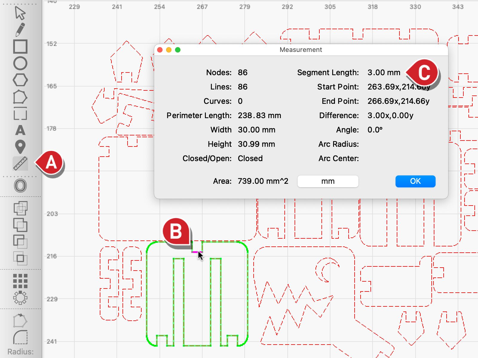

1. Measure Existing Slots¶
Before using Resize Slots, you'll need to know the size of the original slots or tabs in the design we want to adjust.
- Click the View Shape Measurements button in the left toolbar.
- Hover over the segment of the slot or tab you want to adjust. We'll be adjusting slot width, so that's the segment we'll hover over.
- The length of the line is displayed as the Segment Length. Our design has a starting slot width of 3 mm, because we designed it to be cut out of 3 mm thick material.

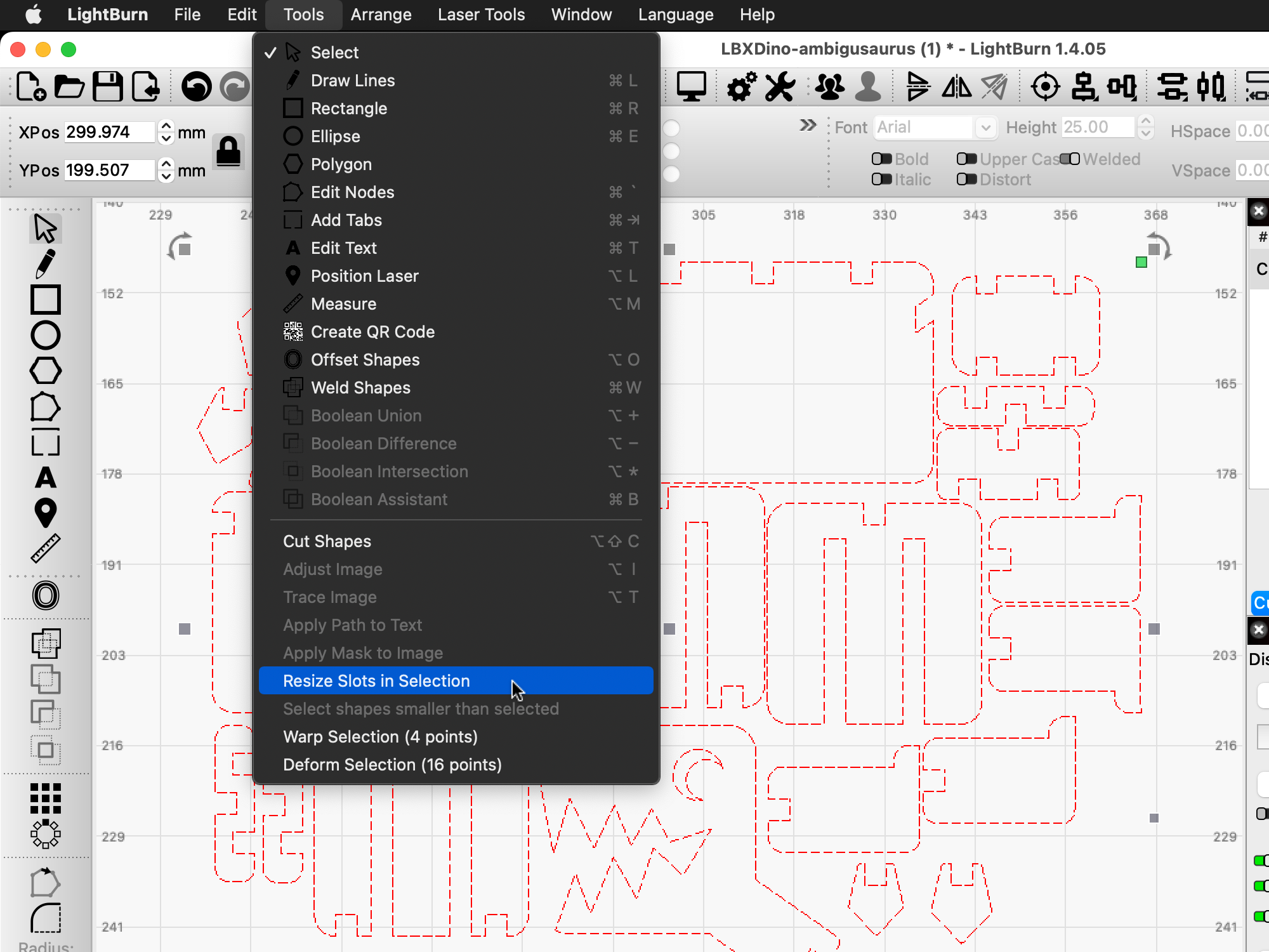

2. Prepare The File¶
- Before opening the Resize Slots tool, it's important to make sure none of the graphics are grouped, or the resizer won't be able to identify the slots or tabs. You can ungroup graphics by selecting them and clicking the Ungroup button or pressing ++ctrl+u+ / Cmd+U.
- Select the parts that need to be adjusted. Pressing Ctrl+A / Cmd+A will select all graphics in your project.
- Go to Tools → Resize Slots in Selection to open the Resize Slots tool.

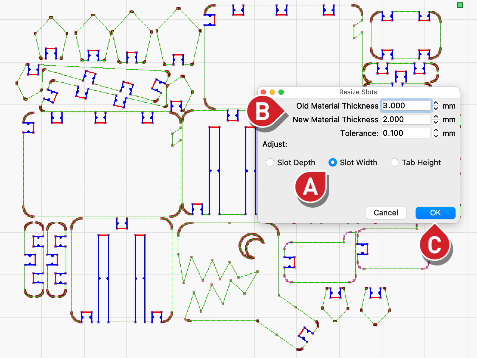

3. Resize Slots¶
- Select the Adjust: Slot Width option
- Set Old Material Thickness to the width you measured in the previous step (3 mm in our case), and New Material Thickness to the thickness of the new material you'll be cutting (2 mm in our case).
- Now that we've set the proper values, click OK to apply the changes.
The sample file only needs adjustment for the Slot Width, but the same process can be used to adjust Slot Depth and Tab Height as well. Our Slot & Tab Resizer documentation has more detailed information on this process, including troubleshooting tips.
