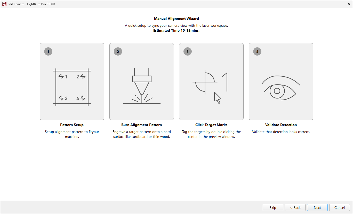

  1. Select your alignment method. Automatic alignment is faster and easier, but if you don't have good lighting or can't get a good high-contrast mark, you may need to go with Manual Alignment instead. The Alignment Wizard will show you an overview of the steps you'll need to take.
  2. Set up your alignment pattern, following the on-screen directions, then click Next to move to the next step.

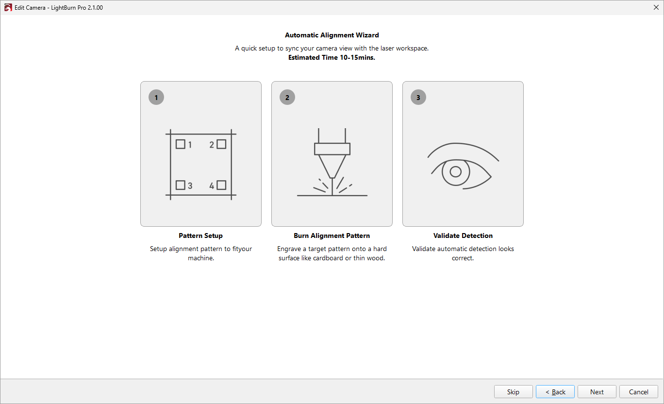

3. Select your Alignment Method.
You can use automatic or manual Camera Alignment. The automatic method is quicker and easier, but requires good lighting and high contrast between the marked pattern and the background material.
Screenshot showing the start of automatic alignment
Overview screen for automatic alignment.
Screenshot showing the start of manual alignment
Overview screen for manual alignment.

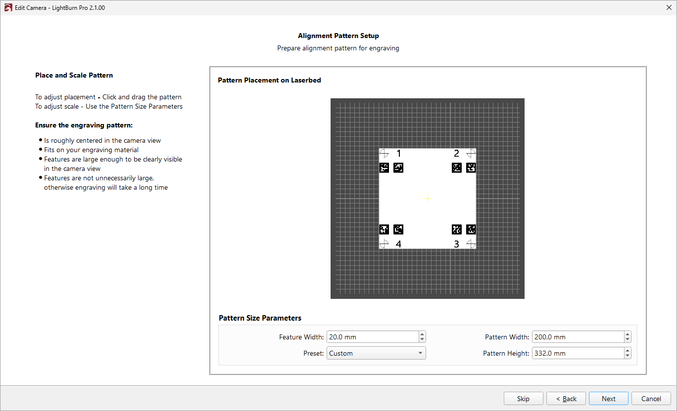

4. Set Up Your Alignment Pattern
Next, you'll set up your alignment pattern. The screenshot below is from the Automatic Alignment wizard, but the only difference for Manual Alignment is that there are no AprilTags - all the settings work the same between the two.
Screenshot of alignment pattern generator
Place and Scale Pattern
When creating the pattern, it should be:
  • Roughly centered in the camera view.
  • Sized to fit on your engraving material.
  • Created with features large enough to be clearly visible in the camera, but not so large they take an excessively long time to engrave.
Fill Features
Enable Fill Features (new in LightBurn 2.2) to make the numbers and crosshair markers easier to see.
Pattern Size Parameters
  • Feature Width: The size of the calibration features.
  • Pattern Width / Pattern Height: The width and height of the overall pattern.
  • Preset: You can choose one of several presets as a starting point. To go back to the defaults, you can select Center from the dropdown.

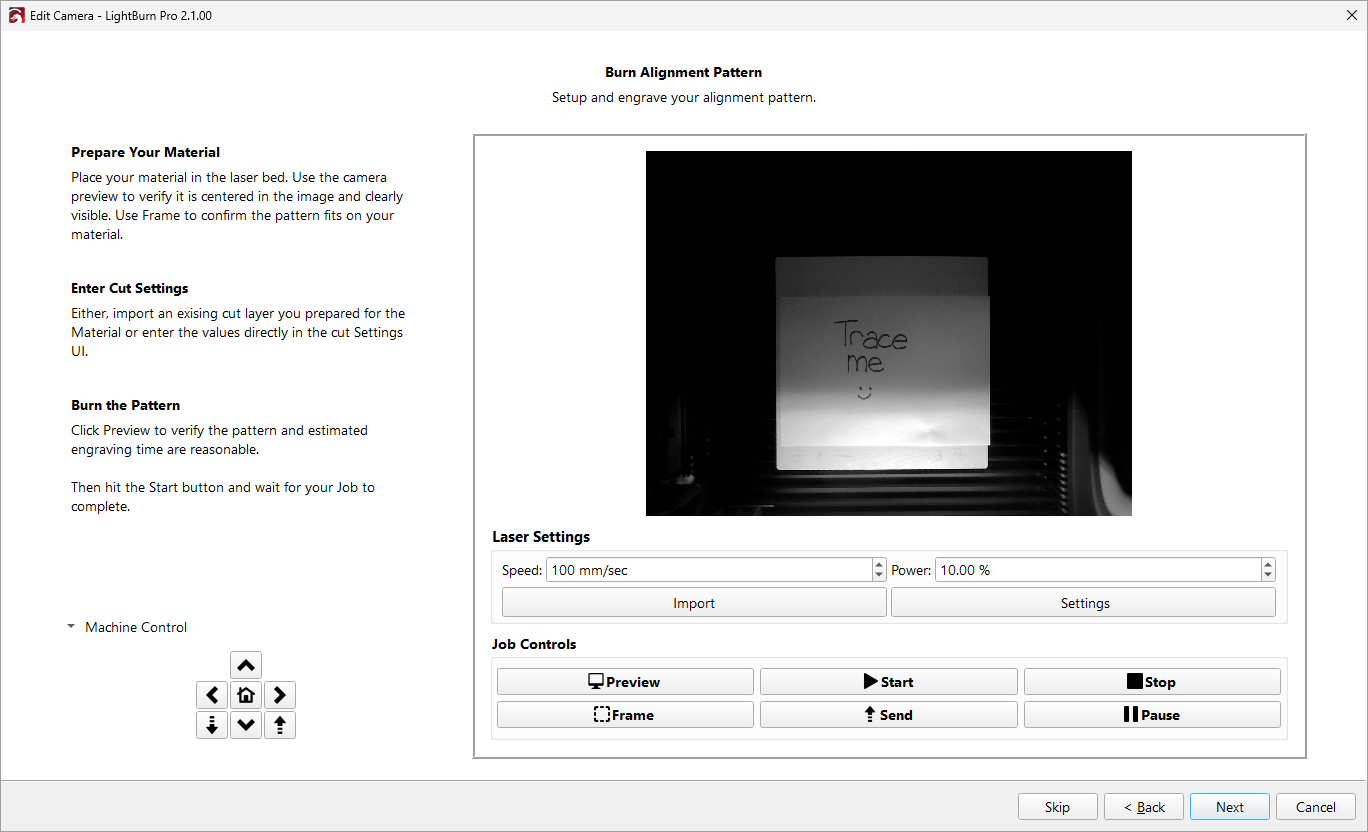

5. Burn Alignment Pattern
Place your material in the laser cutter and get ready to burn the alignment pattern.
Screenshot of Burn Alignment Pattern screen
Use the camera preview to make sure the material is near the center of the image and clearly visible. Use Frame to make sure the pattern fits the material, and use Preview to see what will actually be burned. Use the Machine Control section in the lower left to move your laser head around if needed.
Adjust your cut settings to engrave a dark, crisp mark without cutting through the material. You can adjust your settings in a few ways:
  • Adjust speed and power right in the Alignment Wizard window, just below Laser Settings.
  • Click the Import button to load a layer from your Material Library.
  • Click Settings to adjust your layer settings in the Cut Settings Editor.
Run the job using Start or Send, however you'd usually control your laser.
Do not move the pattern after you burn it, or you will need to burn a new alignment pattern.

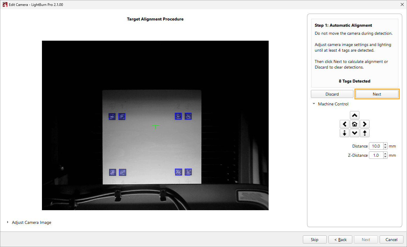

Automatic Alignment

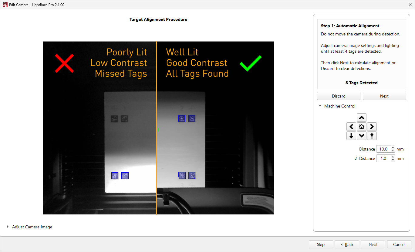

Automatic Alignment uses the camera to read the AprilTags you've engraved and automatically calculate the placement of the camera relative to the material.
Screenshot showing good and bad visibility for automatic alignment
Getting good results with automatic alignment
Because LightBurn is attempting to read the alignment pattern for you, it's important that you have good lighting and clean, high contrast engravings. See the screenshot above for an example of poor lighting/contrast on the left, and improved lighting/contrast on the right. If LightBurn is not detecting the tags, you may need to improve the lighting or adjust the camera image with the Adjust Camera Image controls in the lower left corner.
To start, LightBurn will attempt to detect the tags burned into the material. For automatic alignment to work, LightBurn needs to be able to detect at least 4 of the 8 tags you've engraved. You may need to use the Machine Control section or Adjust Camera Image section to make sure the image is clear and unobstructed.
Screenshot of automatic target detection

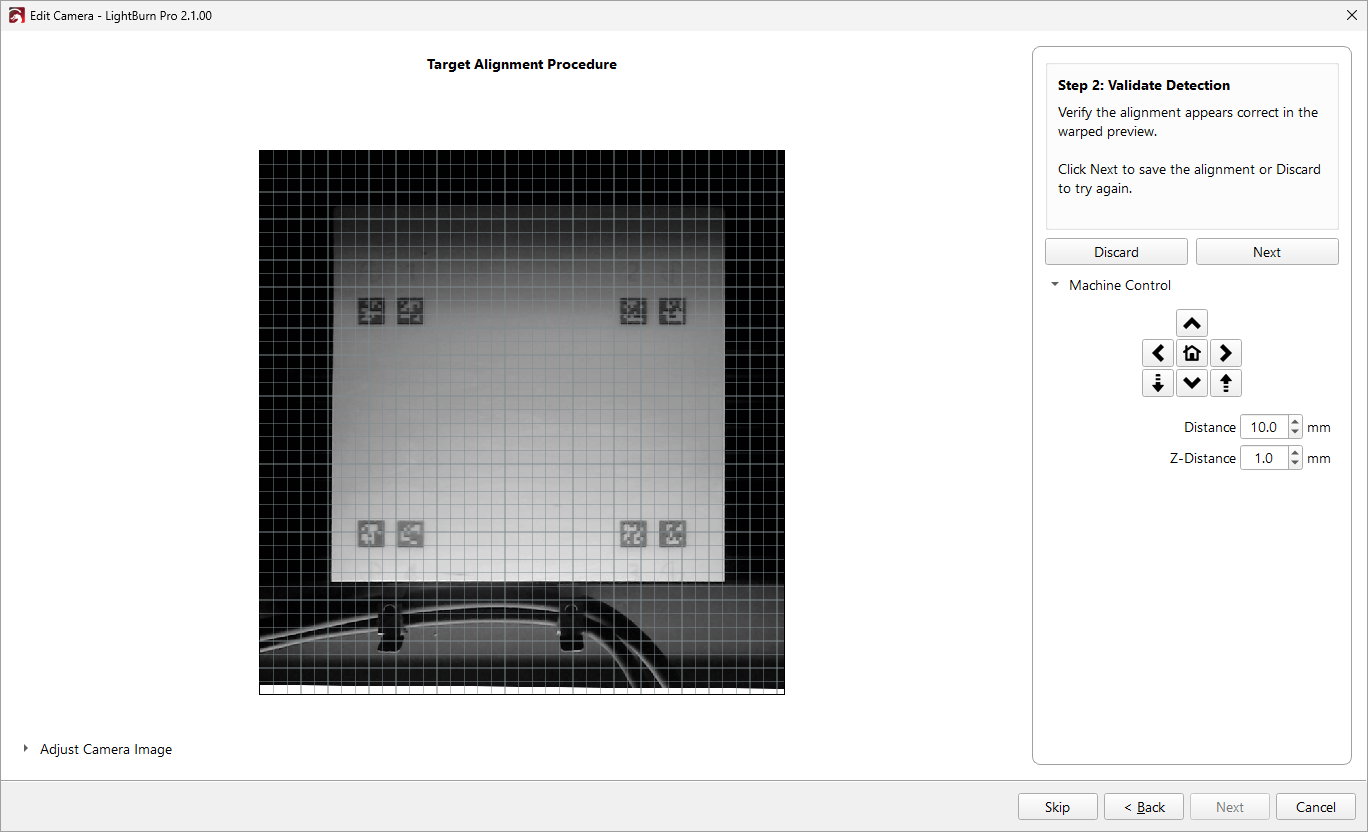

After LightBurn detects the alignment tags, you'll check the results, making sure that the alignment looks correct. Straight lines should appear straight, and the view of the alignment pattern in your laser should match the overlay shown in the Alignment Wizard window. If you're satisfied, click Next and then Finish to save your alignment. Otherwise, you can try using the manual alignment process.
Screenshot of automatic alignment validation

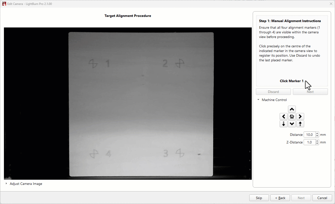

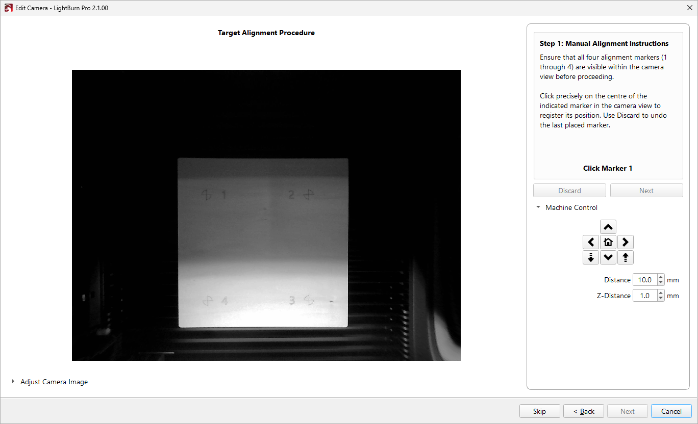

Manual Alignment

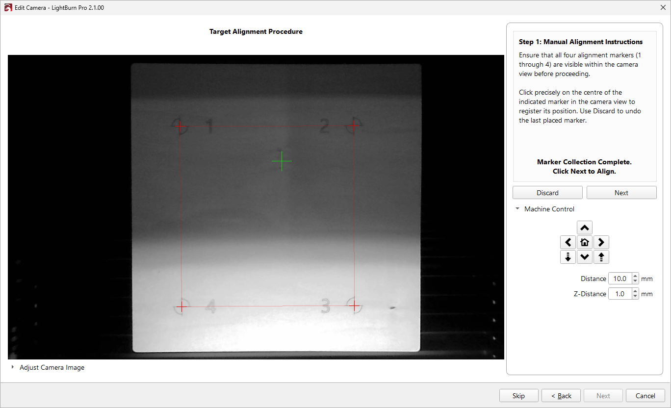

If you're unable to use Automatic Alignment, or just don't want to, you can also use the Manual Alignment process. Manual Alignment does the same calculations as Automatic Alignment, but requires you to identify the center of four crosshairs engraved onto the material yourself. If you aren't able to get a clear, well-lit, high-contrast alignment pattern or if your camera is particularly low resolution, you may need to use Manual Alignment.
Screenshot of starting the manual alignment procedure
Tip

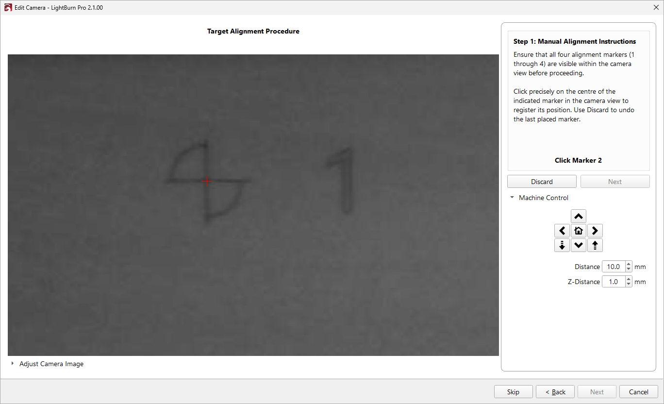

Trying to do this looking at the entire camera image will be both difficult and inaccurate. Use the scroll wheel to zoom in and out on the camera preview so you can see and select the center of the marks more easily.
LightBurn will start by showing you the camera view. You'll need to identify the exact center of the crosshairs - where the two lines meet. Click the center of each target in order. Press the Discard button to remove and redo a center mark.
Repeat for all four corners in order, following the on-screen directions.
Screenshot of identified center mark
GIF of identifying a center mark
Screenshot of manual tag selection completed
When you're done selecting all four manual targets, you should see something similar to the screenshot above, with red marks at the center of each crosshair, and red lines connecting each corner. Click Next to continue onto validation.
After you select the targets, you'll check the results, making sure that the alignment looks correct. Straight lines should appear straight, and the view of the alignment pattern in your laser should match the overlay shown in the Alignment Wizard window. If you're satisfied, click Next and then Finish to save your alignment. Otherwise, you can click Discard and try again.
