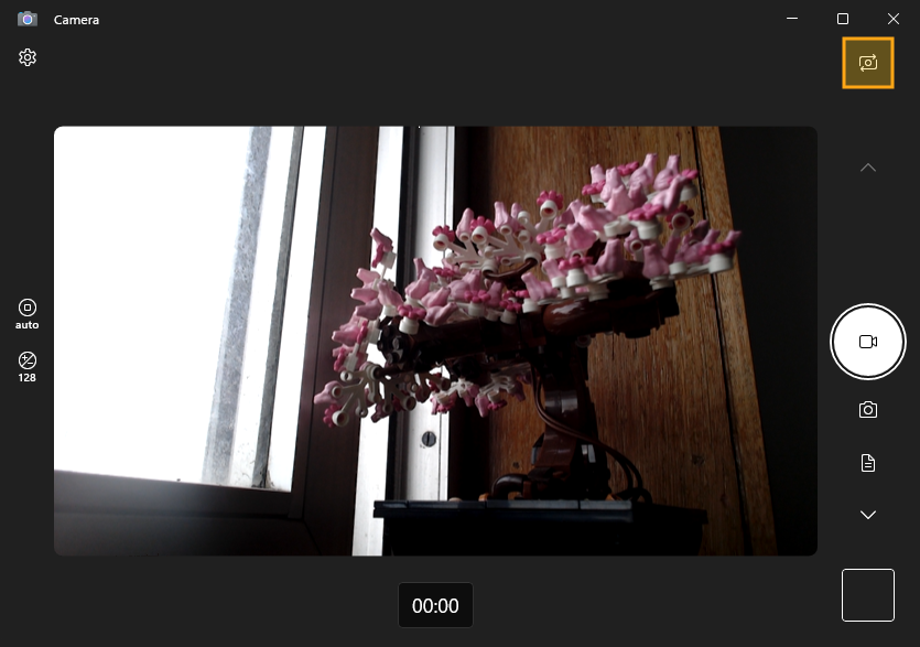

    Open the Windows Camera app and select the camera you want to use in LightBurn. The highlighted button in the top right corner cycles through all of your connected cameras.
    Camera switching button highlighted in Windows Camera app

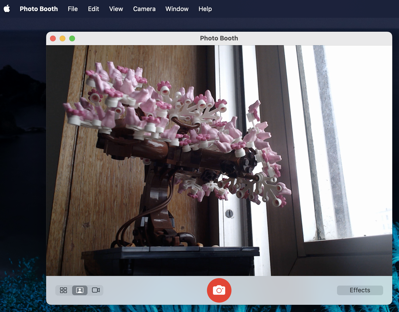

    Open the built-in Photo Booth app, and use the Camera menu to select the camera you want to use in LightBurn.
    Camera menu opened in Photo Booth app

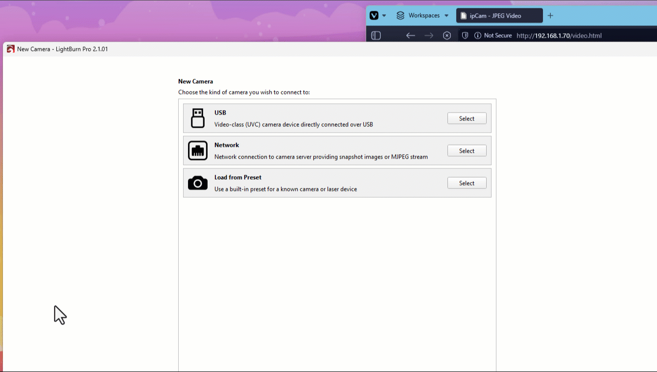

Getting the Correct Feed URL
The web URL provided by many camera manufacturers is to a page that displays the camera stream, not the camera stream itself. If you can see the camera preview in your browser but get an error saying "URL seems to be invalid. Ensure that you are connected to the same network as your device", this is often the reason.
In the GIF below, using the URL provided for my example camera (http://192.168.1.70/video.html) results in this exact error.
GIF of getting IP camera feed URL
To fix the error, try the following, as shown in the GIF:
  1. Right-click on the camera feed in the browser.
  2. In the context menu that comes up, choose Open Image, Open Image in New Tab, or Open Image in New Window. Depending on your computer's operating system and your preferred browser, these options may be named slightly differently.
  3. You should now have a page displaying a single image. Copy the URL from this page, and paste it into the Network URL bar. If this URL is valid, your camera feed should load when you click out of the box.
Why not copy the entire URL?
If you see a ? followed by a bunch of characters, it may or may not be a necessary part of the URL. This particular camera works fine with or without it.
If this method didn't work:
If right-clicking on the video feed doesn't offer you the option to Open Image, Show Image, Load Image, or something similar, you may not be able to get a valid video feed, or you may need to get the feed another way. Please reach out to support for help, and include what camera you're using.

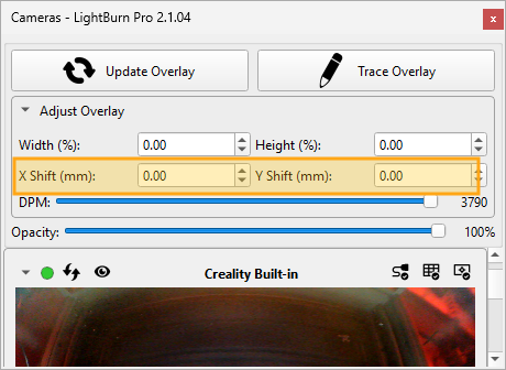

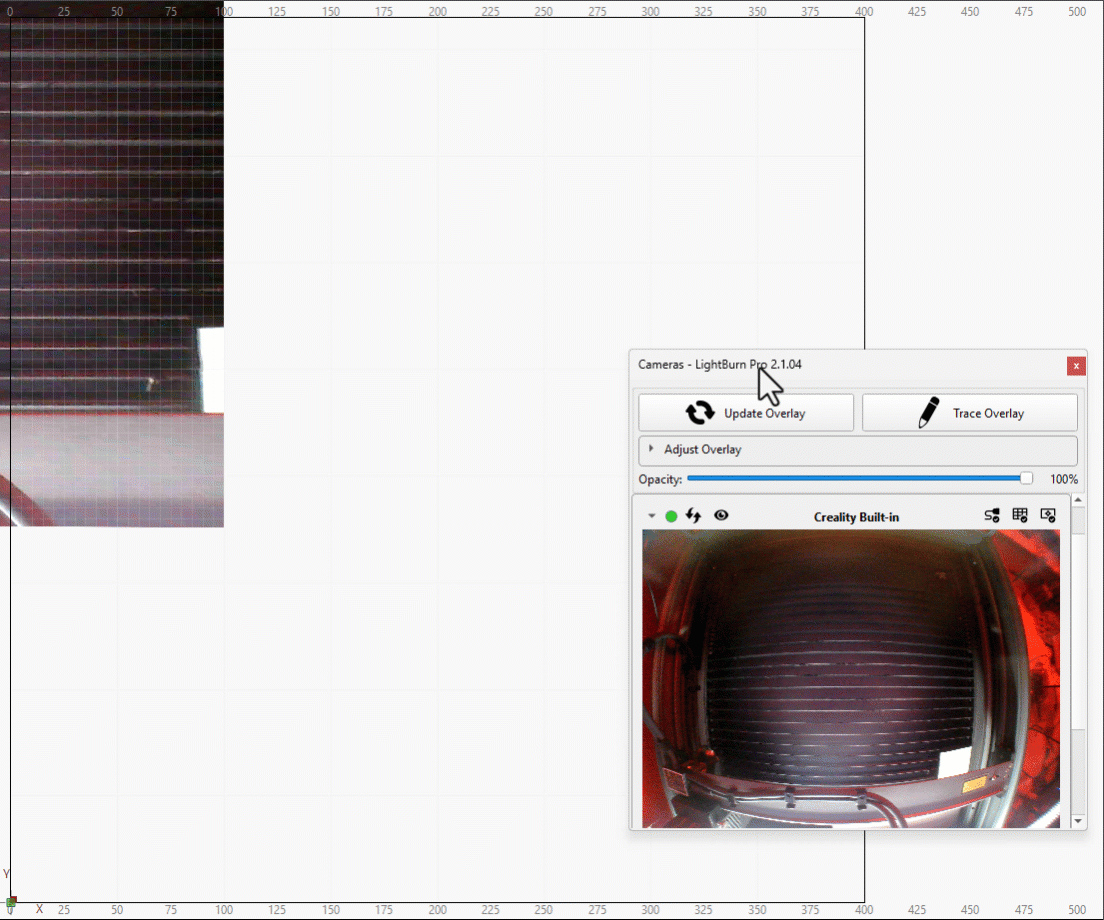

Overlay Misaligned
Any time your Camera Overlay is misaligned, please check the following:
  • Make sure your Start From mode is set to Absolute Coords.
  • Check the Adjust Overlay to make sure X-Shift and Y-Shift haven't gotten changed. For most users, those values should be 0.
Screenshot of the Cameras window annotating where to adjust the X-Shift and Y-Shift values
Demo of adjusting the X-Shift, Y-Shift, width, and height values for the Camera Overlay
If these checks don't fix the problem, we have suggestions below for different situations.
