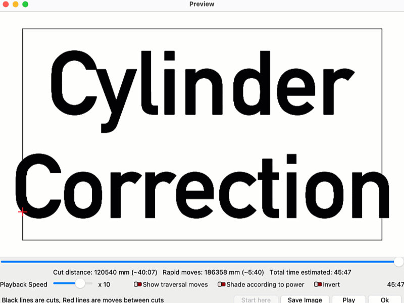

Cylinder Correction
Available for Galvo lasers only, Cylinder Correction is a special mode that warps the output of your design to correct for distortion caused by engraving cylindrical objects, without using a rotary. EZCAD users may be familiar with this tool by the name ProjectMark.
Open the Cylinder Correction Setup window by going to Laser Tools → Cylinder Correction Setup, or clicking the Cylinder Correction button in the Modes Toolbar.
Learn More
Cylinder Correction

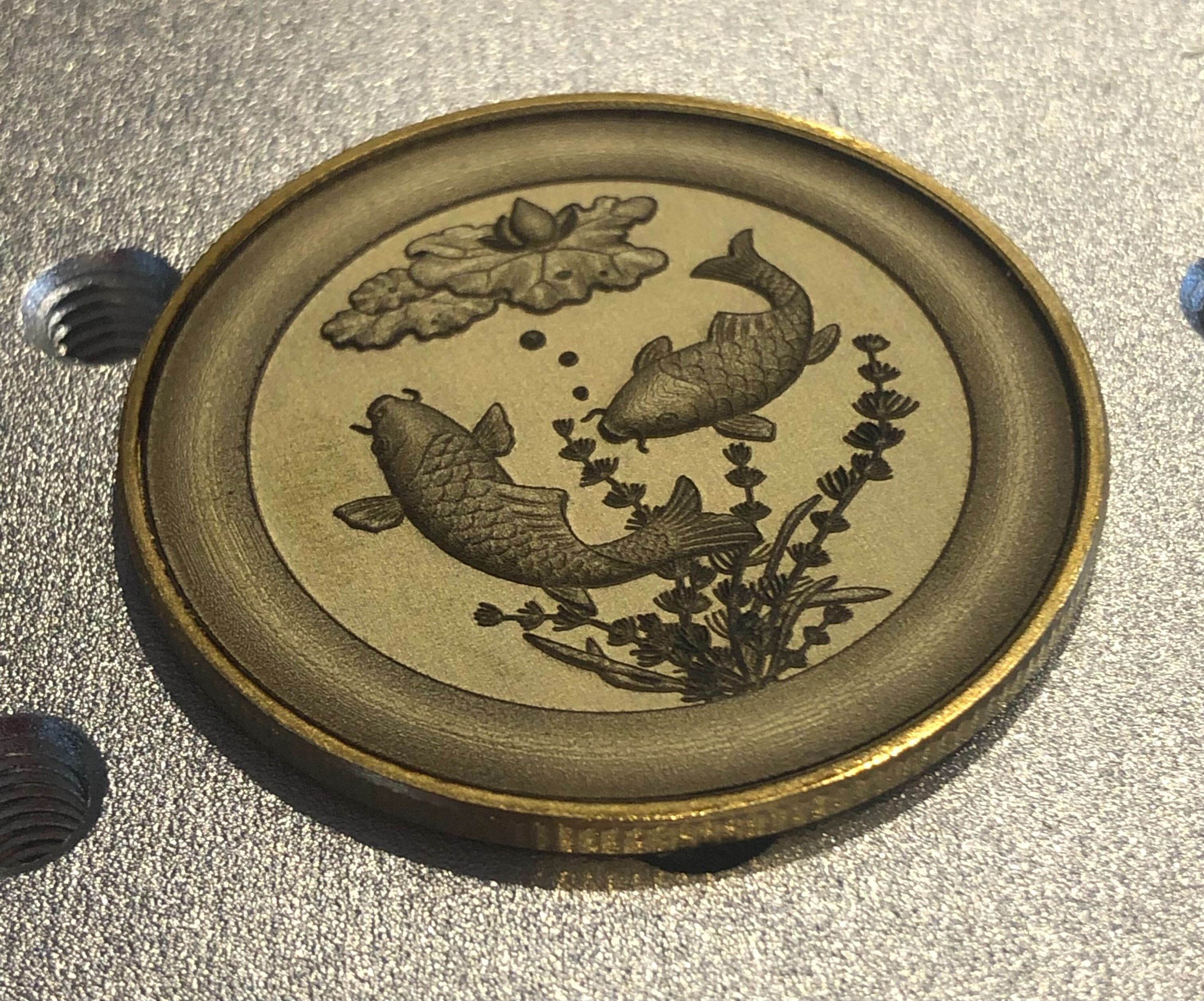

3D Sliced Engraving
LightBurn's 3D Sliced Image Mode enables Galvo users to create engravings with both visual and physical depth. This 2.5D engraving mode does not require a live Z Axis and can produce highly detailed engravings, but does not offer precise control over the engraving's depth.
Learn More
