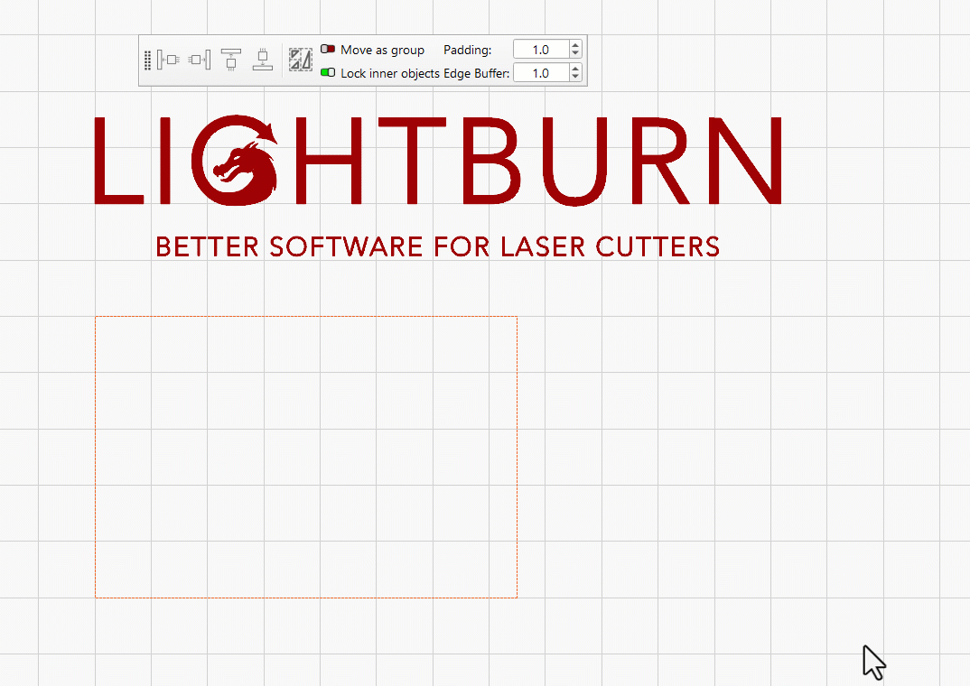

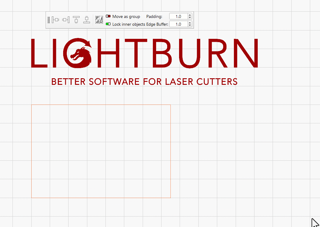

True Nest
Nesting allows you to fit more parts in less material by packing your shapes efficiently into the space availble. LightBurn 2.2 introduces a new feature, True Nest, which offers built-in nesting using the true shape of the objects, including multi-sheet nesting for working with more parts than you can fit on a single sheet og material. True Nest is only available for LightBurn Pro.
True Nest Demo
Quick Nest
Quick Nest offers quick, simple nesting without leaving LightBurn. Quick Nest uses bounding box nesting, which calculates nesting based on the smallest rectangle each shape fits into. Quick Nest requires LightBurn 2.1 or newer. You don't need LightBurn Pro to use Quick Nest.
Quick Nest Demo
Learn More
SVGNest (External)
If you need denser nesting than Quick Nest offers and aren't using LightBurn Pro, you can use SVGNest to automatically create and export an SVG of selected graphics, upload it to SVGnest.com, and re-import it after it nests the graphics contained in the file.
Learn More
Nest Selected demo
