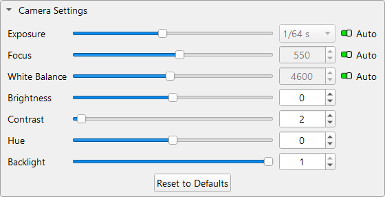

Camera Settings¶
The Camera Settings section contains settings for adjusting your camera image.
The default settings here are chosen to work for most setups, but you can adjust your settings using the sliders or numeric entry boxes. For Exposure, Focus, and White Balance, you can also enable or disable automatic adjustment here.
