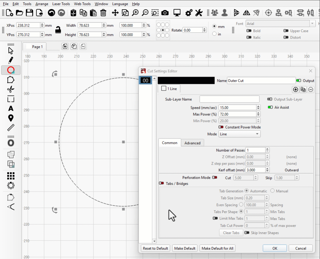

Generate Path From Cut creates new paths based on your currently selected objects. The new paths include properties you've added through the Cut Settings Editor, such as Tabs, Kerf Offsets, and Perforations. The new paths generated are the cutting moves that are sent to the preview and the laser.
Demonstration of creating a new path from a cut with perforations and a kerf offset applied.
In this GIF, the circle has Perforation Mode and a large Kerf Offset (for visibility) applied, and a new path is created from it using Generate Path From Cut.
How to Use Generate Path From Cut
  1. Prepare your shapes as you see fit.
  2. Select the objects you want to generate paths from.
  3. Go to Edit → Generate Path From Cut.
  4. Your new paths are created without deleting the original objects.
