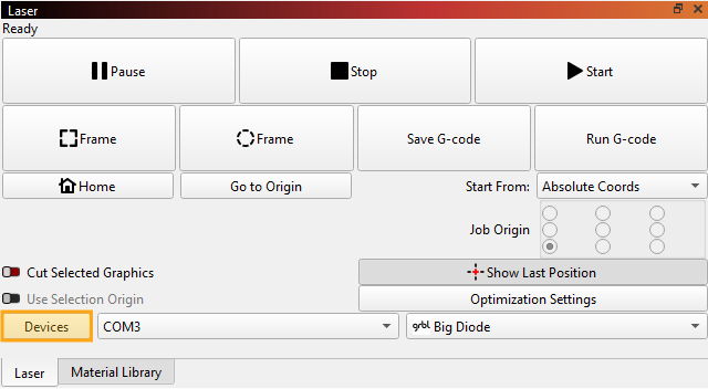

  1. In LightBurn, click the Devices button (highlighted in the screenshow below) in the Laser window to open the Devices window.
    Screenshot showing the location of the Devices button in LightBurn's laser window

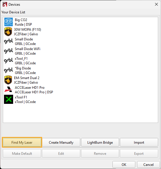

  2. In the Devices window, click the Find My Laser button under the device list to open Find My Laser.
    Screenshot showing the location of the Find My Laser button in LightBurn's Devices window

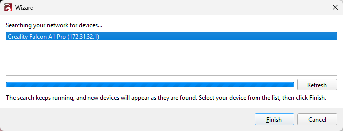

  3. Make sure your device is connected to the network. Click the Search Network button.
  4. If LightBurn detects your device, it will show up in the list. Select it and click Finish.
    Screenshot of the Find My Laser screen with a network device detected.

  1. In LightBurn, click the Devices button (highlighted in the screenshot below) in the Laser window to open the Devices window.

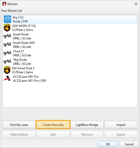

  2. In the Devices window, click the Create Manually button under the device list to open the New Device Wizard.
    Screenshot showing the location of the Create Manually button in LightBurn's Devices window

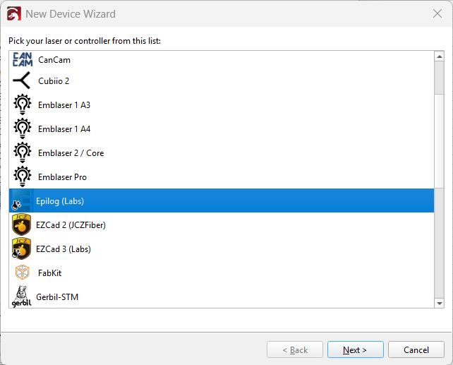

  3. In the New Device Wizard, select Epilog from the list of device types. Click Next to Continue.
    Screenshot showing the device type page of LightBurn's New Device Wizard

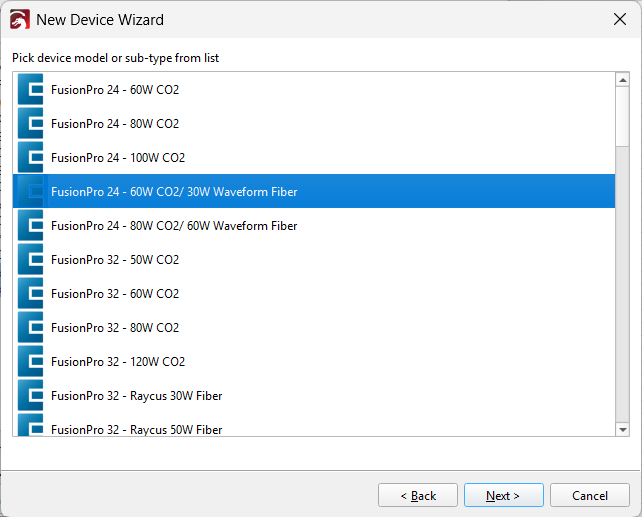

  4. Select your specific Epilog model from the list.
    Screenshot showing the list of Epilog models

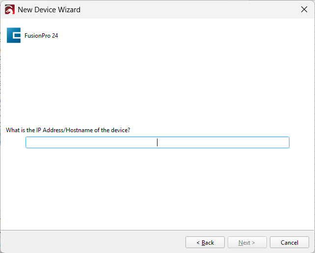

  5. Enter your IP address to tell LightBurn where to find your laser on your network. Click Next to continue.
    Screenshot showing the IP address page of LightBurn's New Device Wizard

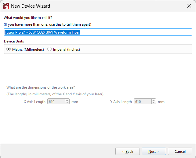

  6. Name your device something recognizable. The dimensions should be set automatically. Leave the Device Units in millimeters - if you prefer to design in inches, you can set that separately later. Click Next to continue.
    Screenshot showing where to set the device name and size in LightBurn's New Device Wizard

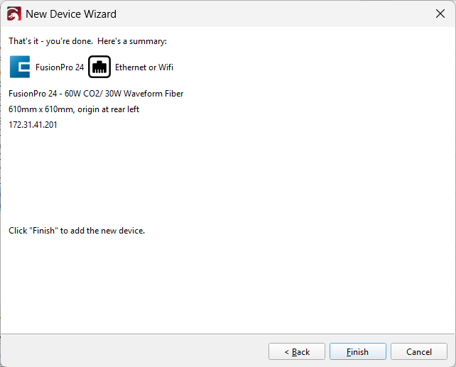

  7. Make sure the summary on the final screen seems correct. Click Back to go back and make changes, or Finish to save your changes.
Screenshot showing the device summary in LightBurn's New Device Window

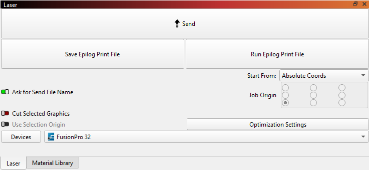

When you use LightBurn with an Epilog laser, you'll see a custom version of the Laser Window.
Screenshot of the Epilog version of the Laser Window
Send
Click the Send button to send the current design to your laser. If Ask for Send File Name is enabled, LightBurn will ask you for a file name.
Save Epilog Print File
Saves the cut data for the current design to an Epilog Print File (.prn) that you can upload to your laser later.
Run Epilog Print File
Loads an Epilog Print File and runs it on the laser immediately.
When Ask for Send File Name is enabled, LightBurn will ask you to name the file that is sent to the laser before sending it.
Start From and Job Origin
These two controls determine where the job is placed on the bed of your laser.
See Coordinates and Job Origin for more information.
Cut Selected Graphics
This toggle switch tells LightBurn to only send the portion of your design that is currently selected when you click Start, Send, or Save Machine File.
See Cut Selected Graphics for more information.
Use Selection Origin
Only available in combination with Cut Selected Graphics, the Use Selection Origin button tells LightBurn to calculate origin relative to selected graphics only, and not the whole design.
See Cut Selected Graphics – Use Selection Origin for more information.
Optimization Settings
This button opens the Optimization Settings window, where you can adjust various options that control the order in which your graphics are cut or engraved by the laser.
See Optimization Settings for more information.
