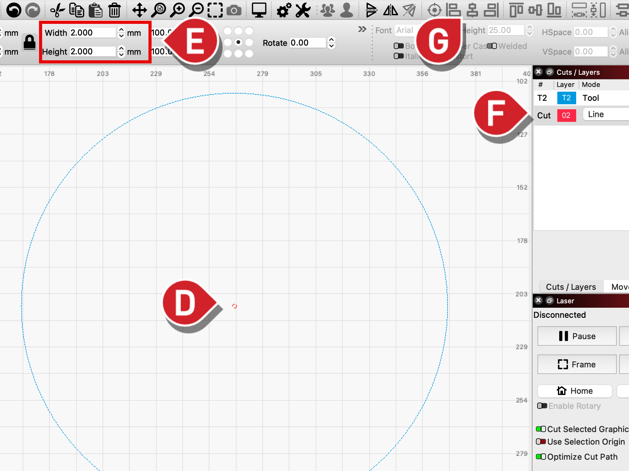

1. Outline the Clock Face
Before opening LightBurn, measure the width of the object you have chosen to use for your clock. Be sure to measure at the space where you want your design to be centered so you get the proper width.
  1. In LightBurn, use the Ellipse tool to create a circle. Holding the Shift key while dragging will make it a perfect circle.
  2. In the Numeric Edits Toolbar, set its Width and Height to match the material you selected to make your clock out of. If you made a perfect circle in Step A, you only need to adjust one dimension, as long as the lock icon in the toolbar is locked.
  3. Set it to a Tool layer. Tool layers are never output to your laser, so this will just be used for visual reference and alignment.
  4. Create another circle.
  5. Set its Width and Height to 2mm or .08". This small circle will make it easy for you to align the point of your drill bit later.
  6. Set it to a Line layer.
  7. Select both circles and use the Align Centers tool to make sure the small circle is perfectly centered in the large circle.

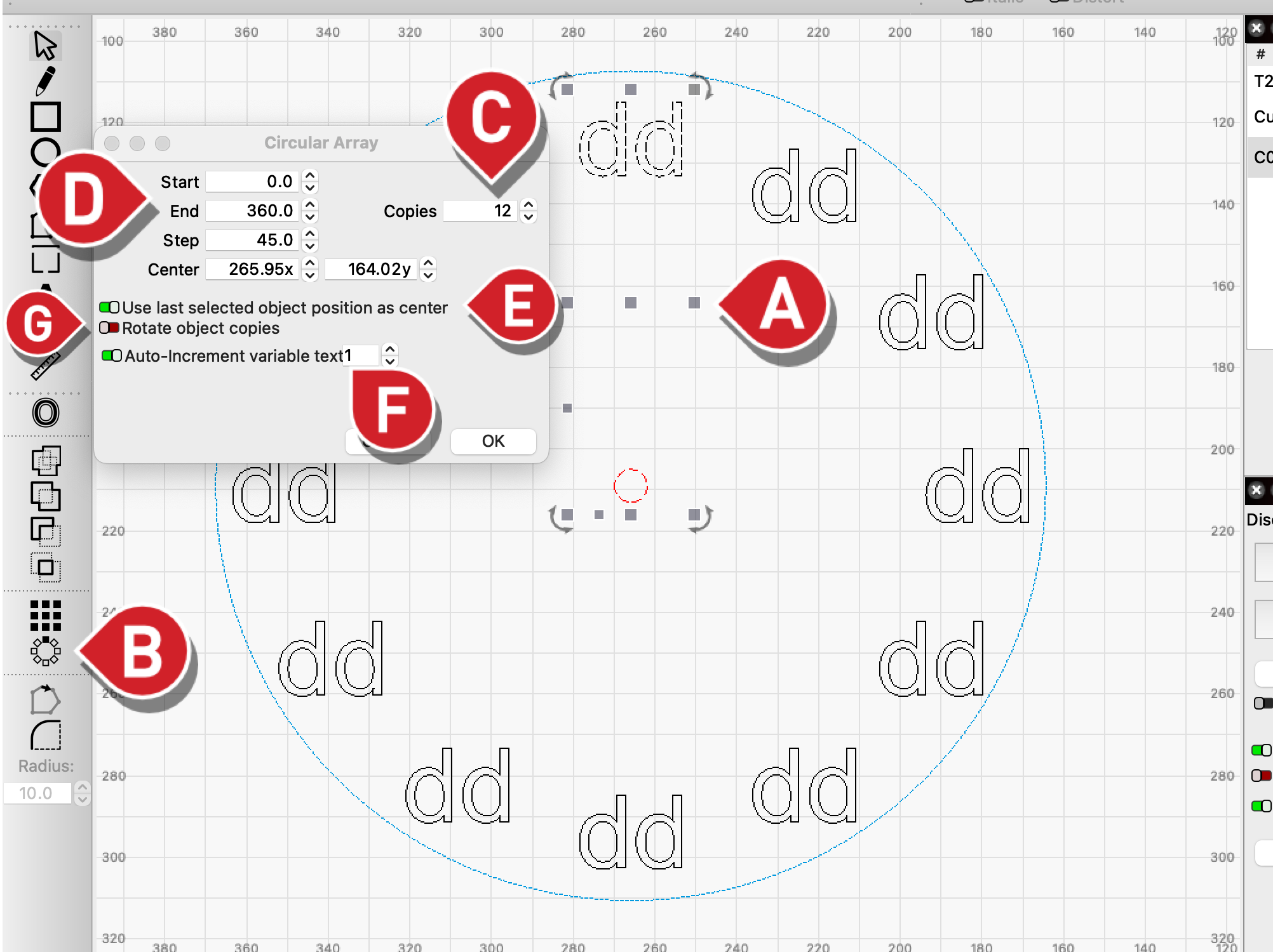

3. Array the Variable Text Around the Clock Face
Using the Circular Array tool, we'll create the rest of the numbers for the clock face.
  1. Select the text and then either of the circles.
  2. Click the Circular Array Tool.
  3. In the Circular Array window, set Copies to 12.
  4. Set the Start to 0, and End to 360.
  5. Enable Use last selected object position as center.
  6. Make sure Auto-increment variable text is enabled and set to 1.
  7. Disable Rotate Object Copies to keep the numbers rightside up all the way around the clock, or enable it to have them turn upside down.
  8. Click OK to make the array.

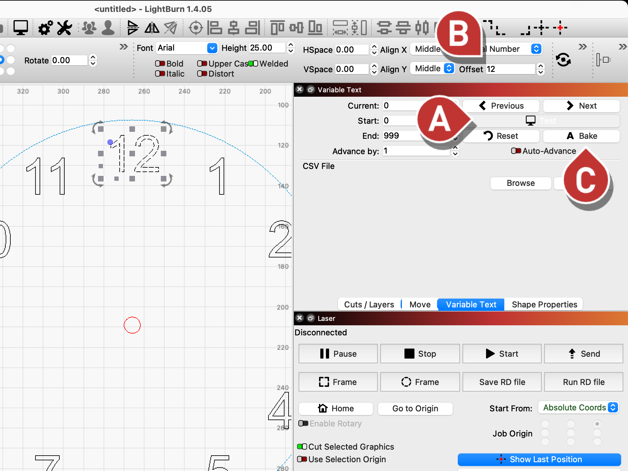

4. Test and Adjust the Variable Text
To finish off the clock face design, we need to make one small tweak to the Variable Text.
  1. In the Variable Text window, click Test. You should see the numbers 0-11, starting from the top center and advancing clockwise around the circle.
  2. Of course, we don't want 0 on our clock, so select the top center text, head up to the Text Options Toolbar, and adjust its Offset to 12.
  3. Click Test again to make sure it now reads 12. Once everything is correct, you can click Bake to permanently transform the Variable Text into numbers in your workspace. If you don't click Bake, the Variable Text will still output as numbers when you Preview or Start the job.

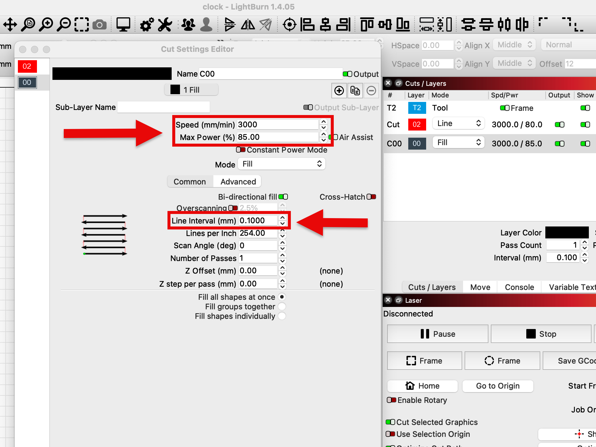

5. Assign Layer Settings
Before running the job, we need to apply appropriate settings to our Layers.
  1. Set the Fill layer to a speed, power, and line interval that produces a good etch on your material. If you're unsure what settings to use, you can run a Material Test on some spare material to find optimal settings.
  2. Set the Line layer to an appropriate power to etch the material just enough that you can use the mark as a guideline for drilling a hole.

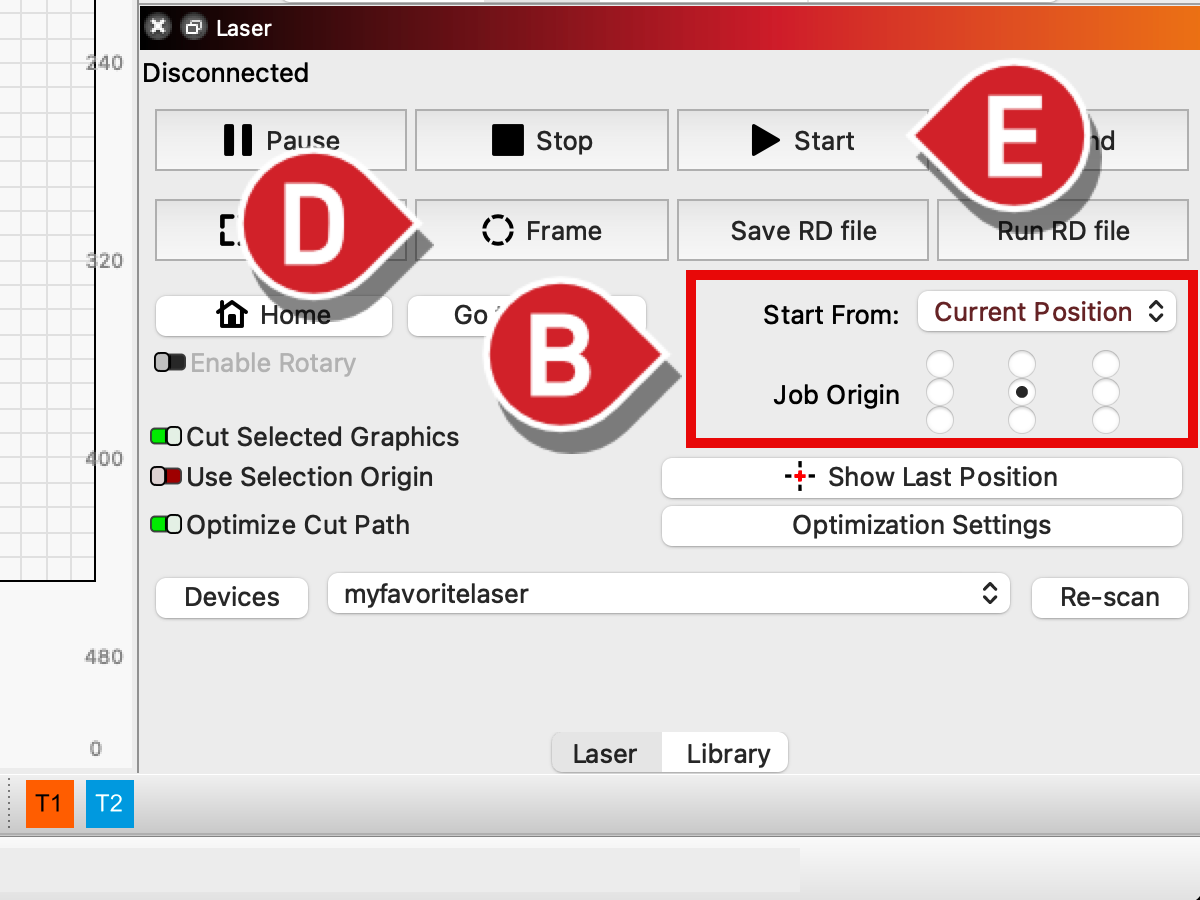

6. Position the Job
Next, we'll position our material, and select an appropriate Start From mode in LightBurn.
  1. Jog the laser head to around the middle of your machine using the arrows in the Move window.
  2. In the Laser window, set the Start From mode to Current Position and the Job Origin to the center position.
  3. Place your material centered under your laser's nozzle.
  4. Run the Rubber Band Framing routine to make sure your job is properly aligned and centered.
  5. Start the job!

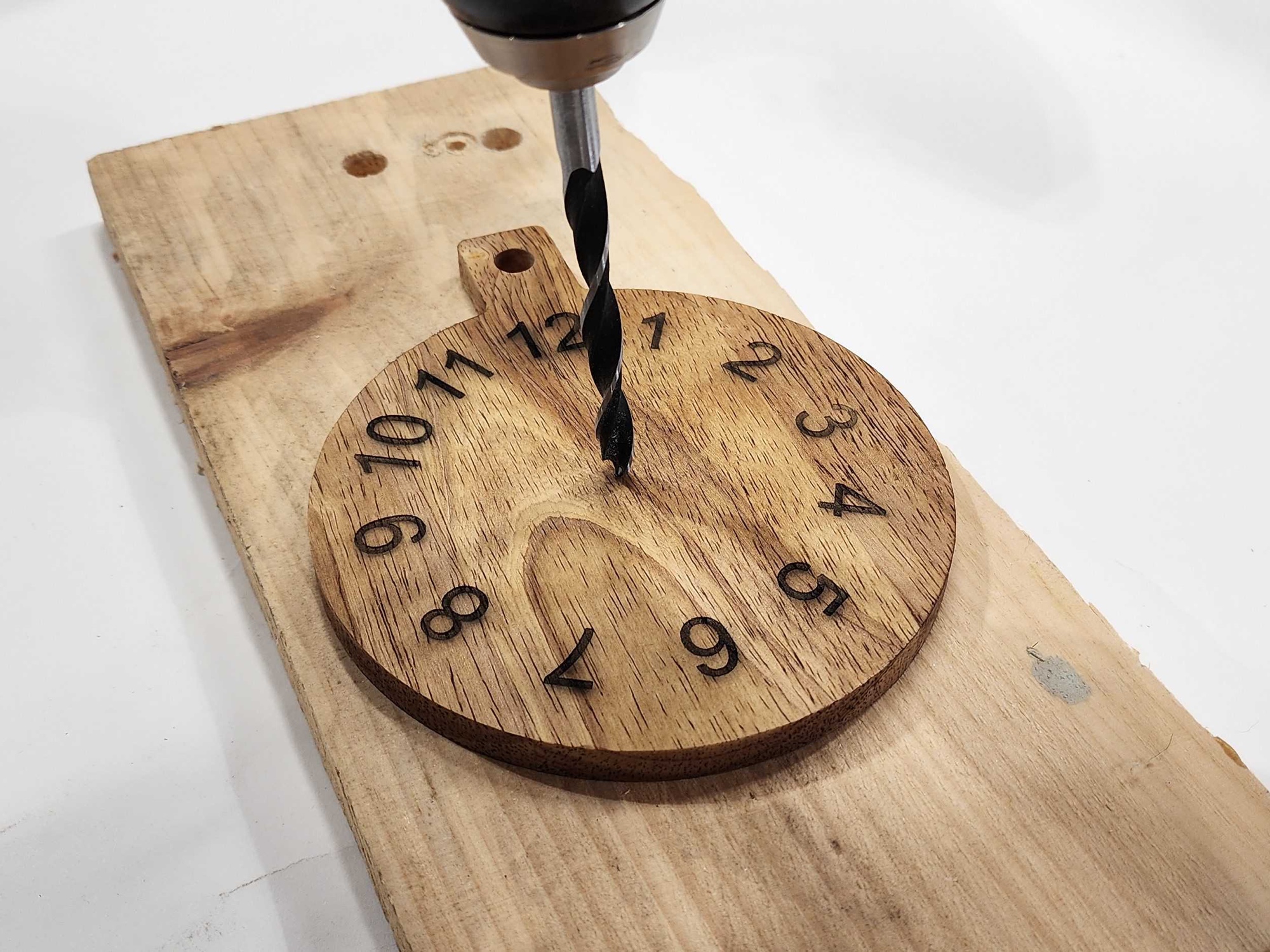

7. Drilling
Now that we've engraved our material, we still need a hole for the clock module to come through.
  1. Grab a hand drill and a drill bit that is the same size as the post of your clock module. A brad-point drill bit is best for this as it is easy to align and will not walk as you attempt to drill your piece.
  2. Put your piece on top of a spare piece of wood so you don't drill into your table when you come through your piece.
  3. Now line everything up, making sure to hold your drill perfectly vertical, and drill your hole.

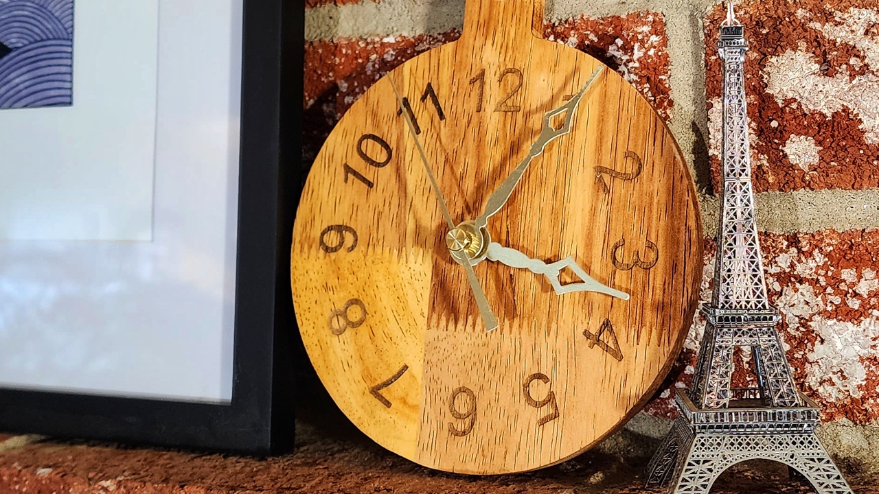

8. Mount the Clock Module
To finish the project, we just need to mount the clock module.
  1. Place the clock module's post through the hole and attach any nuts that came with it to keep it mounted on your clock face.
  2. Now, following the instructions that came with your clock module, add the hands, and your clock is complete.
  3. Add a battery, set the time, and enjoy your new clock for years to come!
After you've made your first clock, consider the ways you can modify the process and make another. You could embellish the face by etching an Image or pattern onto it, or cut out custom-designed hands for your clock module. The possibilities are endless — so long as you've got the time!
