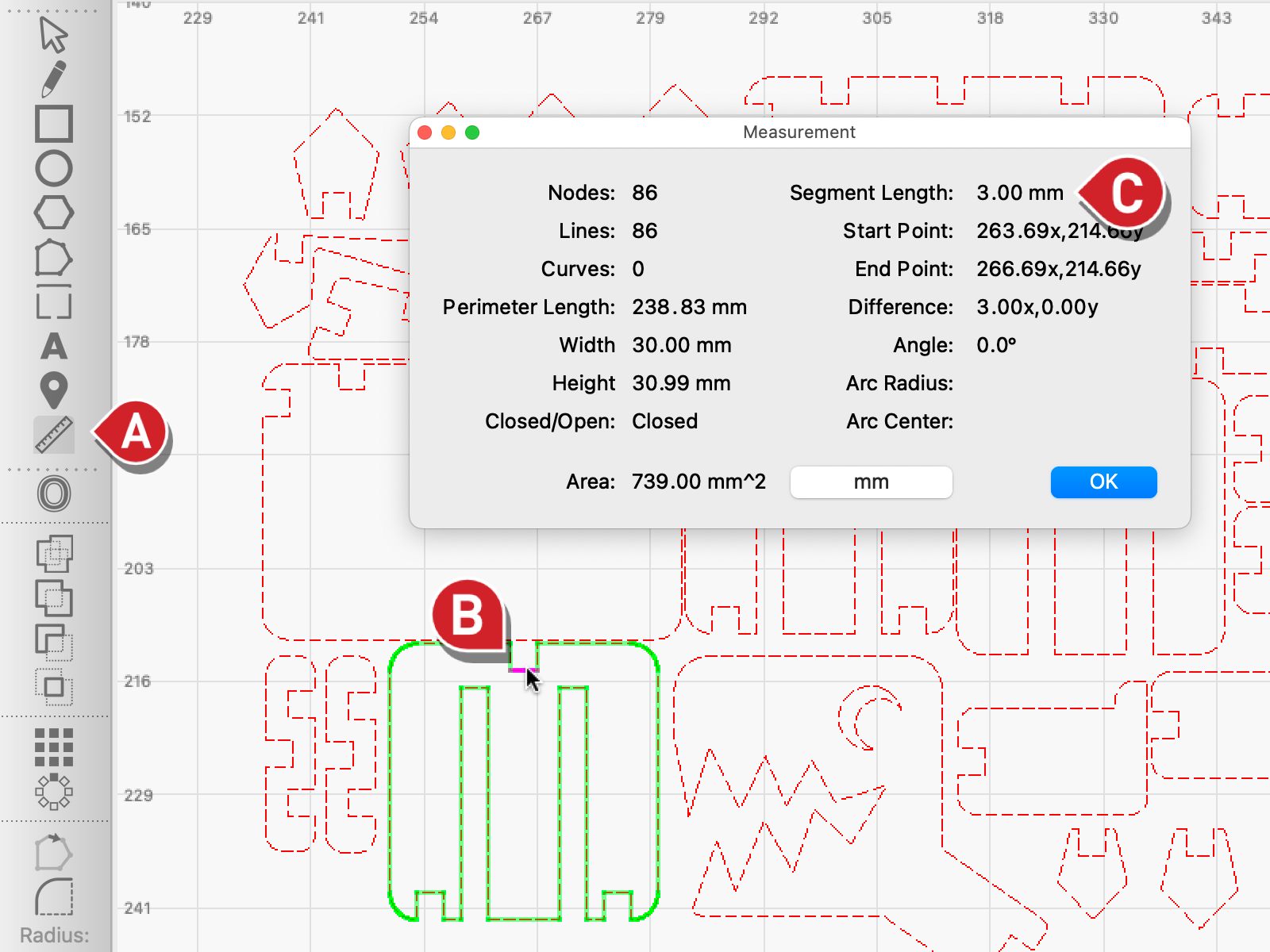

1. Measure Existing Slots
Before using Resize Slots, you'll need to know the size of the original slots or tabs in the design we want to adjust.
  1. Click the View Shape Measurements button in the left toolbar.
  2. Hover over the segment of the slot or tab you want to adjust. We'll be adjusting slot width, so that's the segment we'll hover over.
  3. The length of the line is displayed as the Segment Length. Our design has a starting slot width of 3 mm, because we designed it to be cut out of 3 mm thick material.

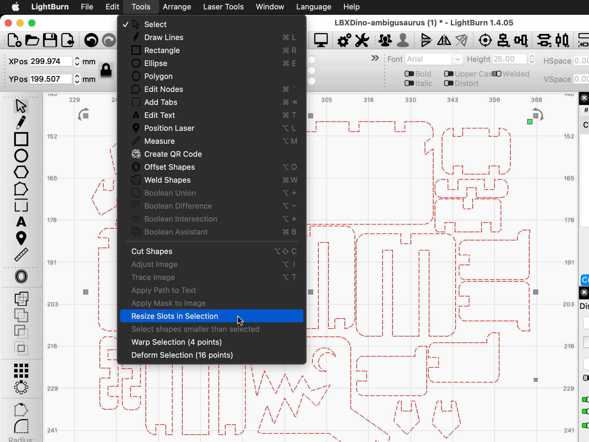

2. Prepare The File
  1. Before opening the Resize Slots tool, it's important to make sure none of the graphics are grouped, or the resizer won't be able to identify the slots or tabs. You can ungroup graphics by selecting them and clicking the Ungroup button or pressing ++ctrl+u+ / Cmd+U.
  2. Select the parts that need to be adjusted. Pressing Ctrl+A / Cmd+A will select all graphics in your project.
  3. Go to Tools → Resize Slots in Selection to open the Resize Slots tool.

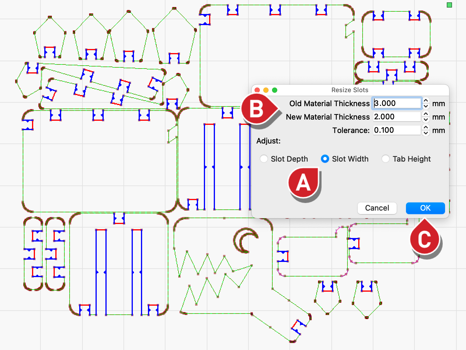

3. Resize Slots
  1. Select the Adjust: Slot Width option
  2. Set Old Material Thickness to the width you measured in the previous step (3 mm in our case), and New Material Thickness to the thickness of the new material you'll be cutting (2 mm in our case).
  3. Now that we've set the proper values, click OK to apply the changes.
The sample file only needs adjustment for the Slot Width, but the same process can be used to adjust Slot Depth and Tab Height as well. Our Slot & Tab Resizer documentation has more detailed information on this process, including troubleshooting tips.

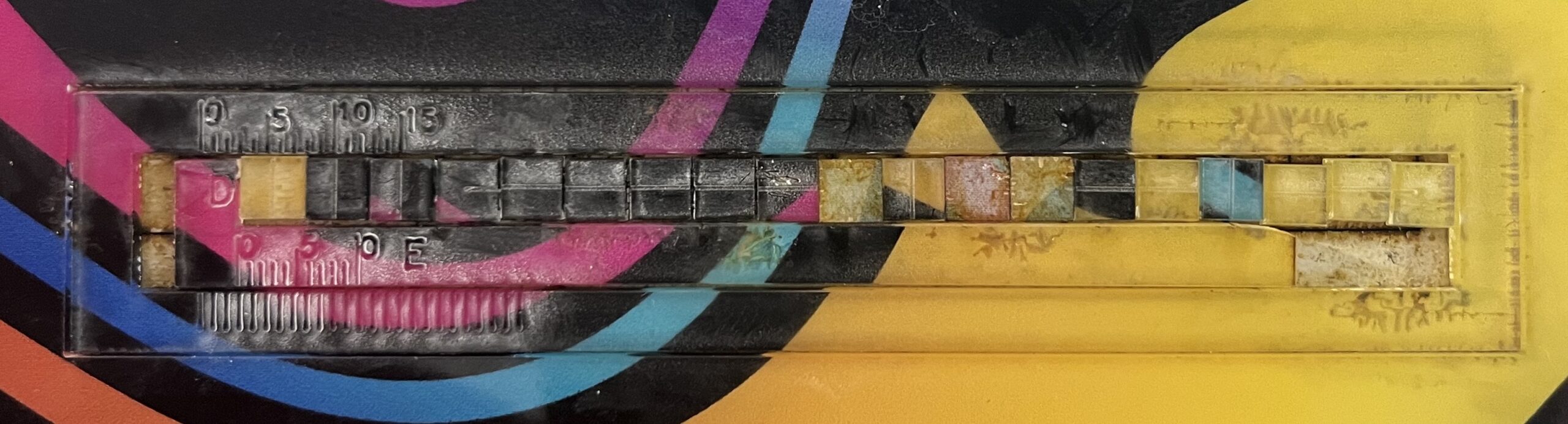

2. Use the Vernier Scale
  1. Find and record the largest number the line marked D passes. In this example, it's 3, meaning that the measurement is at least 3 mm, but less than 4 mm.
  2. To determine the value to the right of the decimal place, find which of the numbered lines to the left of E matches up closest to the lines etched on the bottom frame of the test piece. In this example, it's 7, meaning that the measurement is 3.7 mm.
  3. To get the width of a single kerf, divide the measurement by 20. In our example, the width of the kerf is 0.185 mm.
  4. Next, we'll divide the total kerf by 2 - since half of the kerf will be within the material we're cutting away, we only need to worry about offsetting the half that's cutting into the material we want to keep. That gives us a final Kerf offset value of .0925.

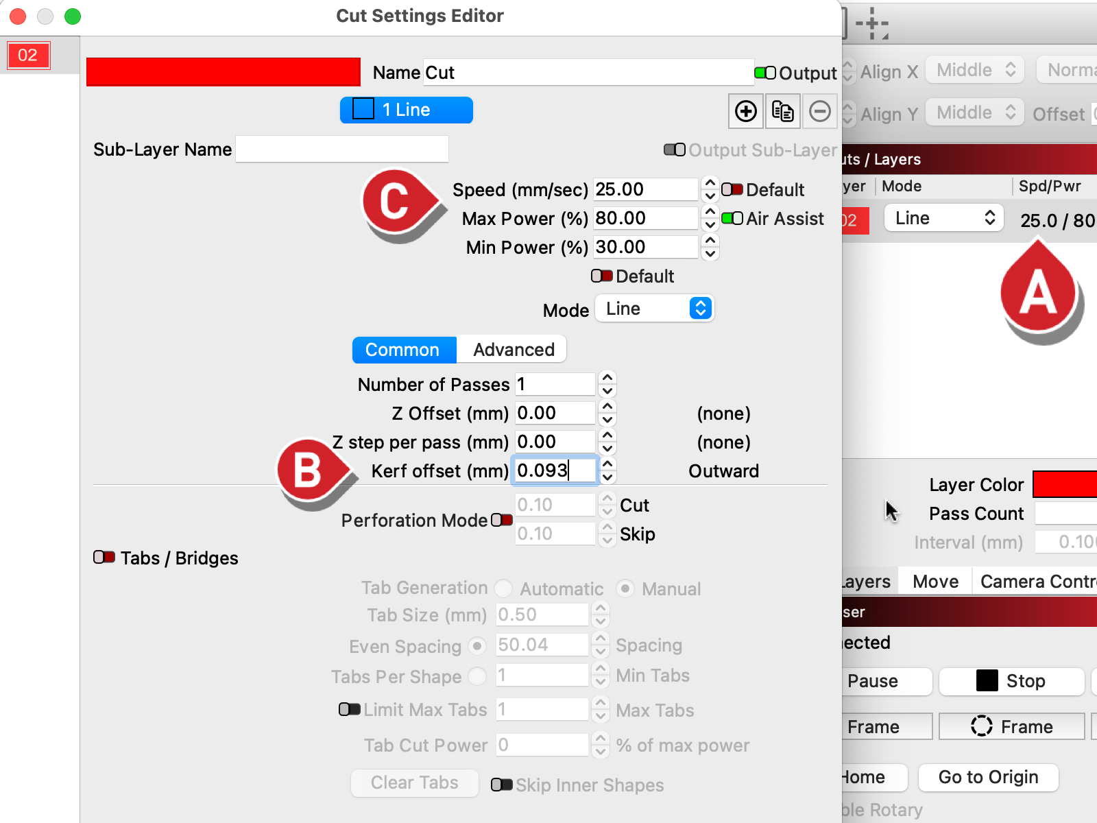

3. Set Kerf Offset
  1. Open the Cut Settings Editor by double-clicking the Line layer you've got your graphics set to in the Cuts/Layers window.
  2. About halfway down the window is Kerf offset. Enter the value you calculated in Step 2. Make sure the value is positive for an outward adjustment.
    • Positive values will adjust cuts outward, or away from the shapes being cut.
    • Negative values will adjust cuts inward, or into the shapes being cut.
  3. Make sure the speed and power settings are the same as those you used when you cut the test file in Step 1.
Now the cut path will be offset to account for the laser's kerf without changing the underlying shape, and the slots will be accurately sized to the thickness of the material we're cutting. We're ready to cut our model!
