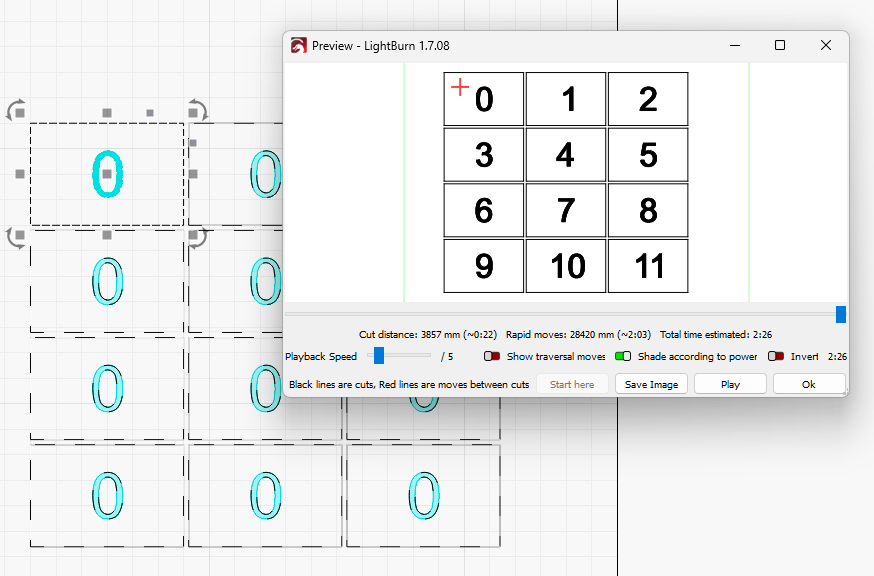

Automatic Offsets
Some LightBurn tools can apply automatically advancing Offset values to duplicated objects.
Use Grid Array, Circular Array, or Copy Along Path to lay out copies of designs while increasing the Offset of each copy by a specified amount.
  • Grid Array Auto-increment Offset demo
  • Grid Array Auto-increment Offset demo Preview
