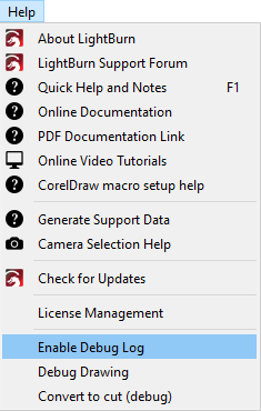

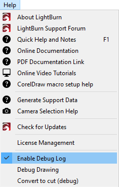

Go to Help → Enable Debug Log to begin recording a log of the actions you take in LightBurn. A check mark will appear next to it when it's enabled, and logging will continue until you select Enable Debug Log again to disable it, or restart LightBurn.
Debug Log Disabled
No check mark — Debug Log not enabled
Debug Log Enabled
Check mark — the Debug Log is enabled
