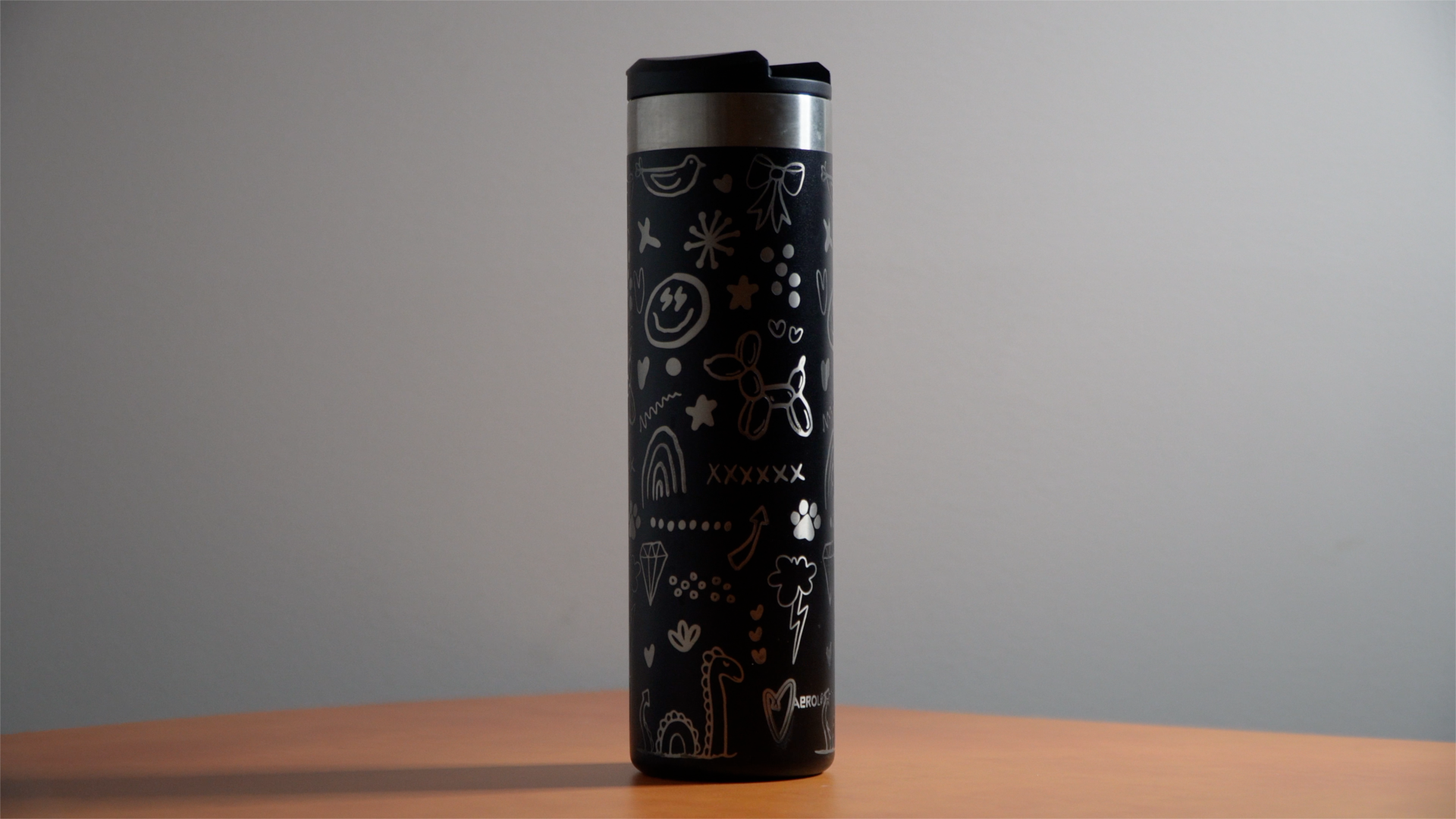

Full Wrap Tumbler Engraving
Whether you're looking to make a personalized gift for a friend, add a new product to your lineup, or just do something fun with your laser, full wrap tumbler engraving is a rewarding technique to master.
Full wraps utilize a design that goes all the way around the cup, so you can’t tell where it begins and ends. They can be simple or complex, tightly grouped or loose, but they will all require similar steps to ensure they come out the way you expect.
Learn how to start tackling this popular design style and make it yours.

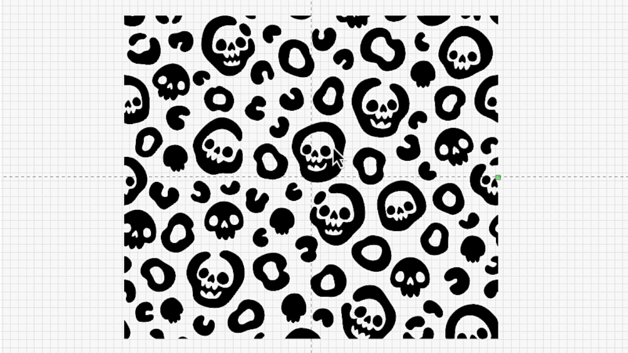

  • How to create a template and full wrap design using the following tools:
    • Tool Layers, to make a template of your tumbler in your LightBurn Workspace
    • Grid Array, to duplicate a design until it fits the circumference of your tumbler

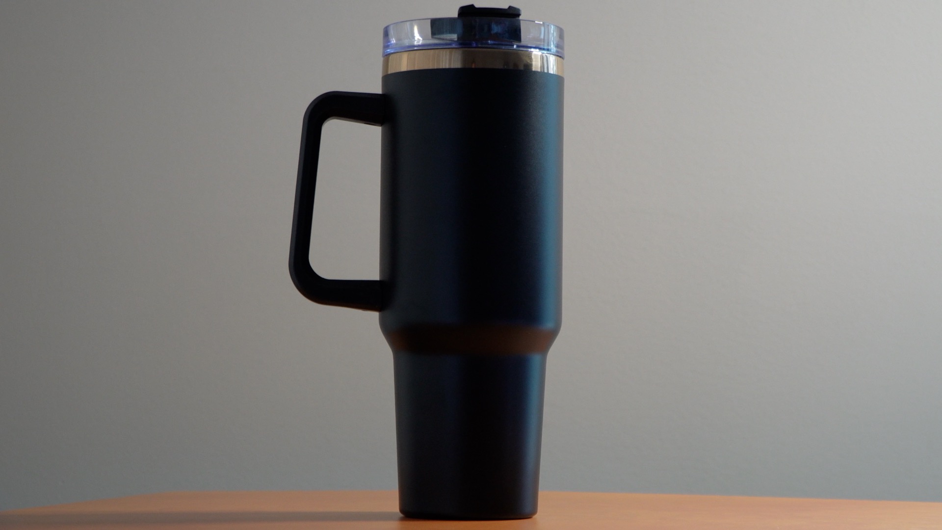

Hard
Tumblers with step downs are the most difficult to work with. The dramatic differences in circumference make it more challenging to get all your measurements and focus right, in addition to distorting your designs.
A tumbler with a stetp down

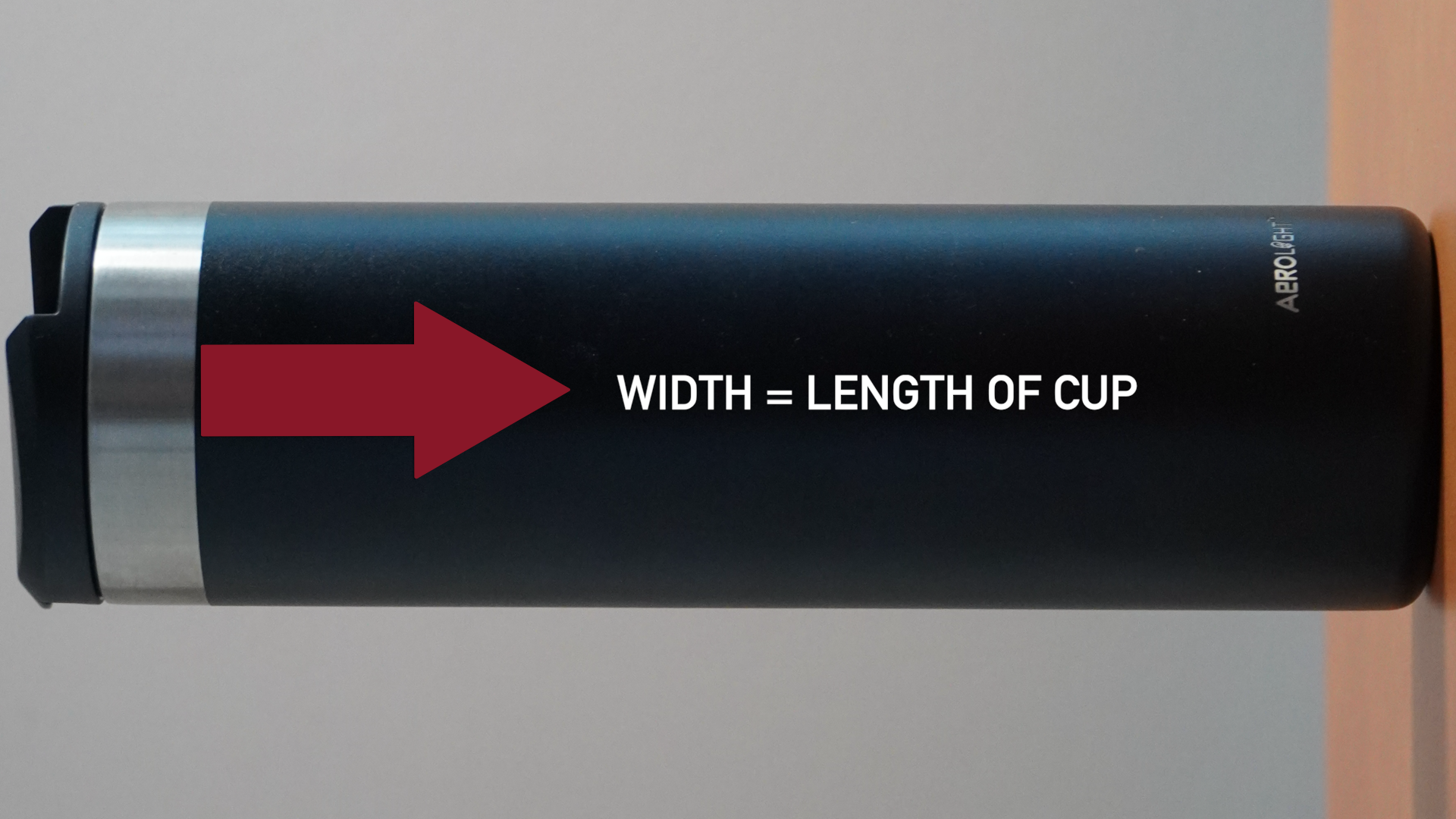

  3. In the Numeric Edits Toolbar, set one of the rectangle's sides to match the cup's length, and the other to match the cup's circumference.
    Quick Reference: Numeric Edits Toolbar
    Note for Galvo Users
    If you're using a Galvo laser, the correct orientation depends on whether you have set your rotary to the X or Y axis. See Rotary Mode (Galvo) — Rotary Axis for more information.
    You can orient the rectangle however you'd like while you design, but remember which side is which, and, if necessary, take care to rotate it 90 degrees later, before sending the job to your laser. In the final orientation, the rectangle’s Height should match the cup’s circumference, and its Width should match the cup’s length.
    Tumbler circumference = Workspace height
    Tumbler length = Workspace width

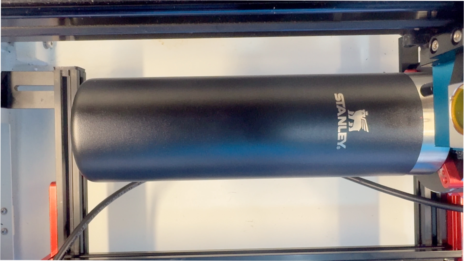

  5. If your tumbler has a logo you'd like to work your design around, get a rough measurement of its dimensions, and its distance from the top of your cup.
    Tip
    If you're using a CO2 laser and your tumbler has a logo that you don't want to work your design around, you can cover it with aluminum tape instead. CO2 lasers can't penetrate aluminum.
  6. Create another rectangle, also set to a Tool Layer, and set its dimensions to match the measurement of the logo — making sure that the Height and Width values are entered correctly for your template's current orientation.
  7. With the Selection tool active, hover over the side of the logo outline that is oriented parallel to the side of the template representing the cup's circumference, until you see the midpoint Snapping icon appear.

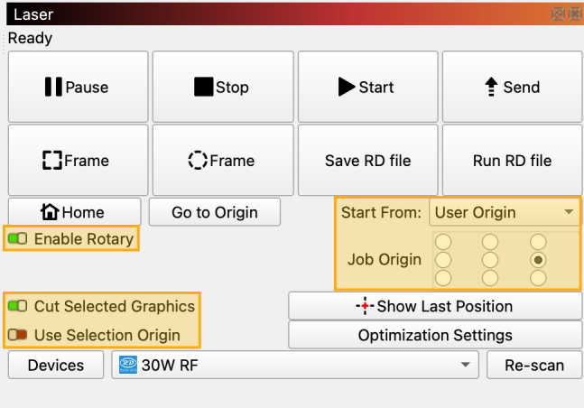

  7. In the Laser Window, set the Start From mode to User Origin, and the Job Origin to either the center-right or center-left.
    With these options selected, the rectangle will be engraved to the left (for a center-right Job Origin) or the right (for center-left) of your custom origin, at the same distance from the edge of the cup as the edge of the template.
    Learn More: User Origin
    User Origin works almost exactly the same as Current Position, except that the starting location is programmable. To set a User Origin, you must first jog your laser to the location you want your job to start from, then set the origin.
    Some lasers with digital displays, such as those with Ruida controllers, have an Origin button which you press to set the origin. GCode-based systems use the Set Origin button in the Move Window in LightBurn to do the same thing.
    For supported systems, use Clear Origin to remove and reset a custom-set origin.
    Set and Clear Origin
    After setting the origin, you are free to jog your laser around its work area. With User Origin selected as the Start From mode, the laser will always move back to start the project in a position relative to the programmed location.
    You can also use the Go to Origin button in the Laser Window to command your laser to travel back to the origin you've set.

The level of complexity of your design affects how easy it will be to complete your engraving successfully. You can create your design completely from scratch, or Import multiple design elements into LightBurn, and then pattern them appropriately, as we will do in this guide.
This guide will focus on an easy design, while incorporating one intermediate element — we'll show how to work your design around a logo on the tumbler.
Easy
  • Very loose, meaning all graphics in the design are well spaced apart, with little risk of elements overlapping or crashing into each other if your object slips on your rotary.
  • No shapes that will look obviously distorted if your rotary setup isn't perfect, or there is a taper to your cup that you haven't compensated for. Distortion will be most obvious on standard geometric shapes like squares or circles.
  • No logos on the cup that you need to work your design around.
  • No seamless patterns. Seamless patterns are meant to line up at specific distances that won't necessarily match your tumbler's length or circumference. Fitting them onto your tumbler without distorting them can be a challenge (unless you design your own from scratch).
Easy design example
Intermediate
  • Relatively loose but with graphics closer together, leading to more potential for overlap.
  • Includes some shapes that will show clear distortions if your setup isn't perfect.
  • Designs that must work around existing logos on the cup.
Intermediate design example
Hard
  • Graphics that are very tightly spaced, with little to no margin for error.
  • Lots of straight lines or geometric shapes that will show clear distortions.
  • Seamless patterns — these not only leave zero room for error, they are also challenging to size correctly to any given object.
Hard design example

  1. Make sure your laser is connected to LightBurn, and Rotary Mode is enabled.
    Note
    If you aren't working around a logo on your tumbler, you can skip the rest of this section, and Frame your entire design before moving on to engraving it.
  2. In the Laser Window, enable Cut Selected Graphics, but make sure Use Selection Origin is disabled.
    • Using Cut Selected Graphics will tell LightBurn to only send objects currently in your Selection to the laser when you Frame or Start the job. For this test, we only want to Frame one thing — the outline that represents the tumbler's logo.
    • Keeping Use Selection Origin disabled will mean LightBurn still includes everything that isn't being sent when calculating Job Origin. We want to make sure we include the entire tumbler template when we calculate origin, rather than just calculating it based off the logo outline.

  3. Select the logo outline, and the logo outline only.
  4. As before, set the Start From mode to User Origin, and the Job Origin to either the center-right or center-left — the same side of your cup that is closest to the logo.

    Settings in the Laser Window
  5. Jog the laser head so that it is to the right or left of the logo, and still roughly centered between its top and bottom.
    Laser in Position
  6. If you're using a GCode-based laser, press the Set Origin button in the Move Window. If you're using a DSP laser, use the Origin button on your laser's controller.
    Where's the Set Origin button?
    The Set Origin button is presented in the Move Window, which is docked behind the Cuts / Layers Window by default. If you don't see it, go to Window → Move to re-enable.
    This button is only available if you are using a GCode-based laser. If you're not sure what kind of laser you have, see Identifying Your Laser.
  7. Press the Frame button in the Laser Window — you should see the laser trace a path around the logo on the cup. If it's off by a bit, jog the laser, update the User Origin, and try again, until you get it as close as possible, and are sure your engraving won't overlap with the logo.

This is the big moment — we're going to engrave our tumbler.
  1. Ok, not quite yet. If you're nervous, you can keep the painter's tape from the earlier test on, and adjust your settings to lightly etch it, as a final step to verify your design, rotary setup, and alignment.
  2. If you're ready, now it's really the big moment. Press Start in the Laser Window. If you're using a DSP laser, you can also choose to Send the project to your laser, and start it from the controller.
    Engraving the tumbler
  3. How does it look? Prior to removing it from the rotary, make sure the engraving made it all the way through the powder coating. With a Chuck style rotary, you can run a second pass, if needed, to clean up any spots before you take it off.
  4. After we remove the tumbler from the rotary, we'll give it quick spray with a cleaning product and a scrub with a magic eraser to clean up remaining powder coat residue, and we’ve got a great looking tumbler.
  5. We did it! Look at that perfect wrap!
    Completed tumbler
