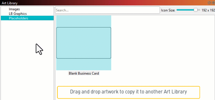

To copy artwork from one Library to another, drag and drop in the Art Library window. To move artwork, hold Shift while dragging the artwork.
Demo of drag and drop to copy or move artwork between Art Libraries
