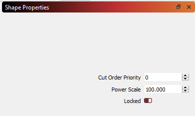

Three options are available for all types of objects, or when you have multiple types of objects selected at once.
  • Cut Order Priority: sets the order this shape is cut by the laser. Lower values are cut first, starting with 0 as the highest priority. You must also select Order by Priority in the Optimization Settings for this setting to take effect.
  • Power Scale: rescales the power used to cut this shape by this percentage, between Min Power and Max Power. For devices that do not support the Min Power setting, power is scaled as a percentage between 0 and Max Power.
    Video: Fine Tune Laser Output With Power Scaling
  • Locked: prevents any edits to the selected shape(s). See Lock Shapes for more information.
When multiple shapes are selected, changing these values acts on all selected shapes at once.
