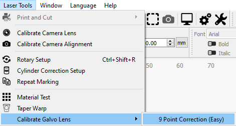

To open the Galvo Lens Calibration wizard, go to Laser Tools → Calibrate Galvo Lens → 9 Point Correction (Easy).

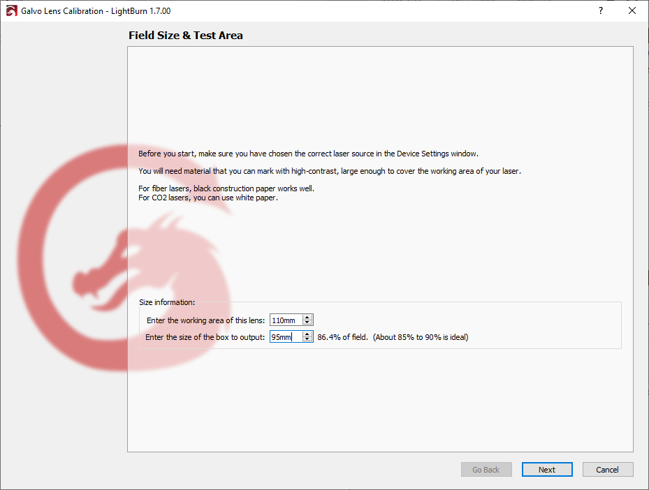

Field Size and Test Area
Galvo Lens Calibration Field Size and Test Area
Each of the fields in this step will be automatically populated based on the Field setting in the Device Settings window, but can be adjusted manually if those settings are inaccurate.
Enter the working area of your lens (this value is usually provided by the manufacturer) as well as the size of the box to output — a value between 85% and 90% of the working area is ideal.
Click Next to continue to the next step, or Cancel to exit the process (progress will not be saved).

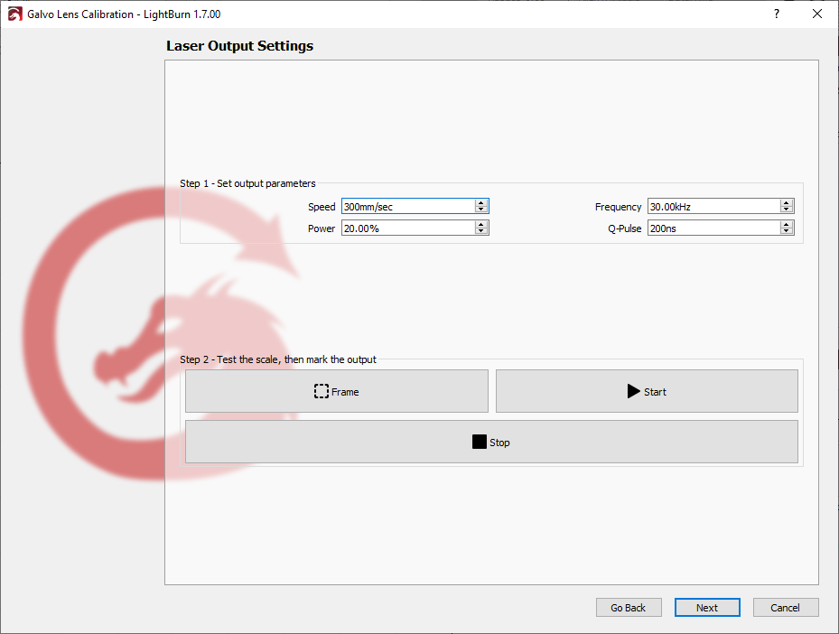

Laser Output Settings
Galvo Lens Calibration Laser Output Settings
Enter appropriate settings for your laser to mark the material you selected, with strong contrast. If you are unsure what settings to use, try running a Material Test first, or consulting your laser's manufacturer for suggested settings.
The Frame, Start, and Stop buttons work exactly as they do for all other output.
Use the Frame button to verify that the size of the box to output is valid for your laser's working area. Mark the design if it fits, or return to the previous step using the Go Back button, if you need to adjust the size.

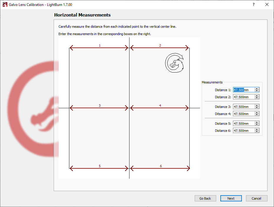

Horizontal Measurements
Galvo Lens Calibration Horizontal Measurements
Measure and enter the horizontal distances between lines, as indicated in the graphic. Take care to measure the distances as accurately as possible — the accuracy of the lens correction depends on the accuracy of these measurements.
Click Next to continue to the next step, Go Back to return to a previous step and adjust settings, or Cancel to exit the process (progress will not be saved).

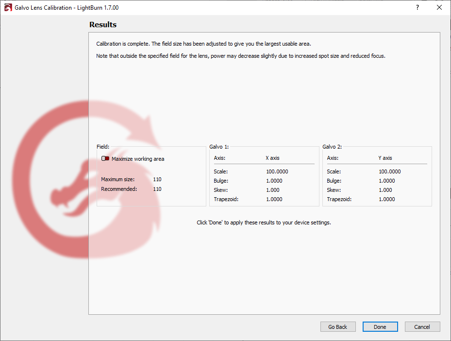

Results
Galvo Lens Calibration Vertical Measurements
The final page displays the resulting corrections that will be applied to each Galvo.
Toggle on Maximize working area to increase your laser's Field to the maximum size possible, if a larger possible size is indicated by the measurements you entered. Note that you may see a reduction in power output in areas outside the dimensions specified by the lens' manufacturer.
Click Done to exit the process and automatically apply the corrections to your Device Settings, Go Back to return to a previous step and adjust settings, or Cancel to exit the process (progress will not be saved).

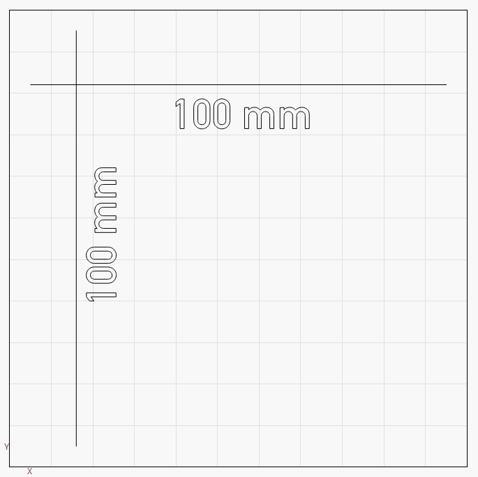

Calibrate your X and Y axis scaling after running the Nine Point Correction wizard to fine tune your Galvo laser's output to match the requested artwork dimensions.

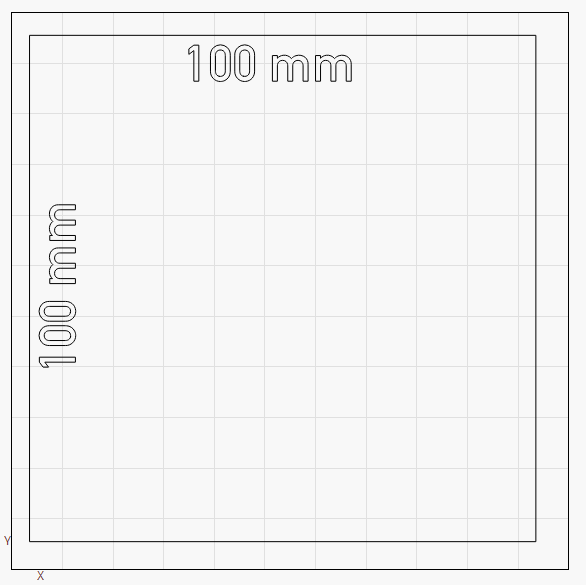

  1. Select the Draw Line tool and in the LightBurn Workspace draw a 100 mm line along the X axis and another along the Y-axis, or the Draw Primary Shapes tool and draw a box with equal dimensions — for example 100 mm.

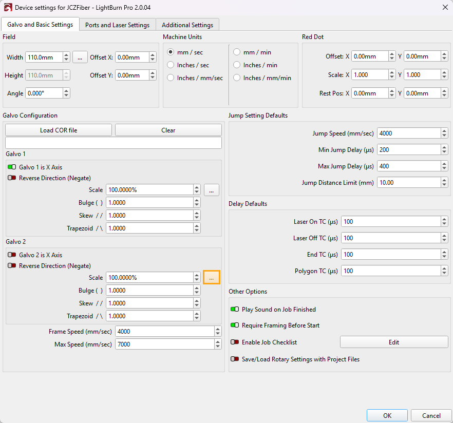

  2. Open the Galvo Device Settings window again and in the Galvo 1 section select the ... button to open the Calibrate Axis window. Depending on which galvo is set as the X Axis, you'll see either Calibrate Galvo 1 (X axis) or Calibrate Galvo 1 (Y axis).
  3. Measure the marked material along the appropriate axis, and update the Calibrate Axis Requested size and Measured size values.
  4. Select OK to apply the new scaling values to the first axis.
    Calibrate Axis Window
  5. Repeat the process for the other axis in the Galvo 2 section.
  6. Select OK to apply the new scaling values to the second axis.
