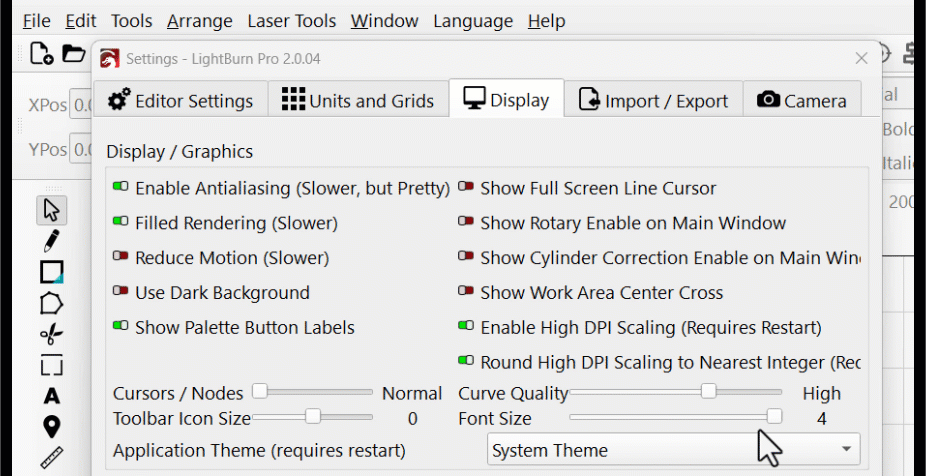

Font Size
Increases or decreases the font size for LightBurn window text anywhere in the program. This allows for manual overrides for high DPI screens, UI scaling, and visually impaired users. Not all UI elements may fit on screen if this is set too high.
Adjust the slider to adjust your font size. The default font size is 0 in the center, with -4 being the smallest font setting and 4 being the largest.
Font Size adjustment demonstration
Warning
Setting this slider too high may result in clipping of UI elements. If you scale font up or down such that you cannot reach the menu items to re-open the Settings window and shrink it, use the method listed here to reset LightBurn.

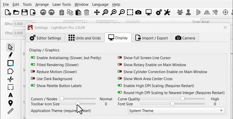

Toolbar Icon Size
Changes the scaling of icon elements in the LightBurn UI. This allows for manual overrides for high DPI screens, UI scaling, and visually impaired users. Not all UI elements may fit on screen if this is set too high.
Adjust the slider to adjust the size of icons and other graphical elements in LightBurn. The slider ranges from -5 (smallest) to 5 (largest), with 0 in the center being the default sizing. Any scaling from Enable High DPI Scaling is applied on top of this adjustment.
GIF showing toolbar icon scaling
Warning
Setting this slider too high may result in clipping of UI elements. If you scale icons up or down such that you cannot reach the menu items to re-open the Settings window and shrink them, use the method listed here to reset LightBurn.
