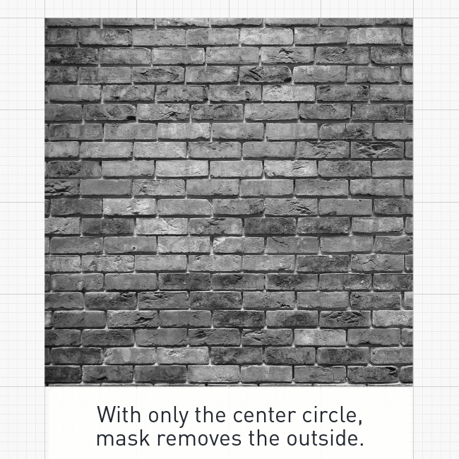

Removing the Center of an Image
Sometimes, you might want to cut out the inside of an image while leaving the outer portion intact. You can do this by Grouping together nested shapes before masking.
See below for detailed directions and an animation showing the difference in results between masking an image with just a circle or a circle inside of a rectangle.
  1. Draw the vector shape(s) for what you want to remove.
  2. Surround the shape(s) you drew with an outer shape. If the outer shape is completely outside of the image you're masking, the outer edges of the image will be unchanged. If the outer shape cuts into the image itself, the part of the image outside of your shape will be removed.
  3. Group your inner and outer shapes together.
  4. Select the grouped vectors and the image, and apply a mask by either going to Tools → Apply Mask to Image or right-clicking and choosing Apply Mask to Image from the context menu.
Demonstration of masking out the center of an image

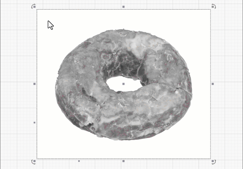

Using LightBurn's Trace tool on images with clearly defined edges can be a quick way to produce a mask to remove an unwanted background. In the example below, the donut is traced with Delete Image After Trace disabled, and then the traced shape is used as a mask to hide the background.
Demonstration of combining tracing with image masks
