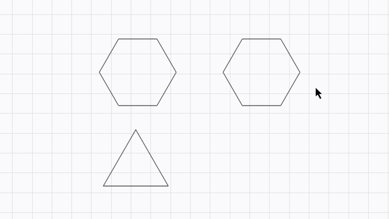

Moving to Snapping Points
When you move objects near enough to a Snapping point, they'll automatically align to that point, and the cursor will change to indicate the type of Snapping point they've aligned to.
Snapping demo

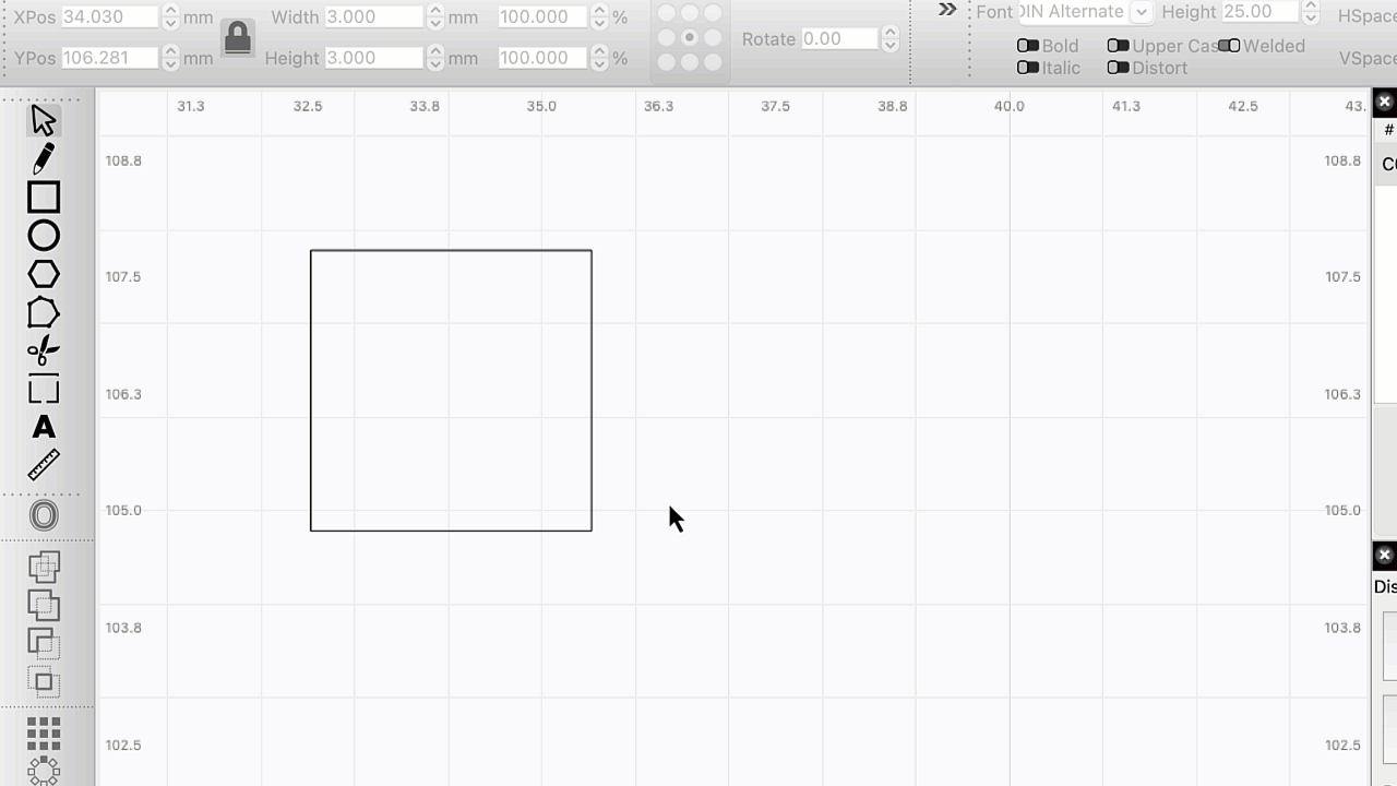

Selecting from Snapping Points
You can select and move objects directly from Snapping points by clicking and dragging from a location where the cursor has changed to one of the Snapping icons.
  • To move multiple objects at once from a Snapping point on just one object, you'll need to select them all at once, or Group them first.
    Snapping multiple objects at once
    Snapping multiple objects at once demo
  • To move objects from a center point when using a Wireframe View Style, you'll need to select them before hovering your cursor over the center of the selection.
  • The center of objects that are already selected is indicated by the four-arrow icon
    Selecting from a center point
    Selecting from a center point demo

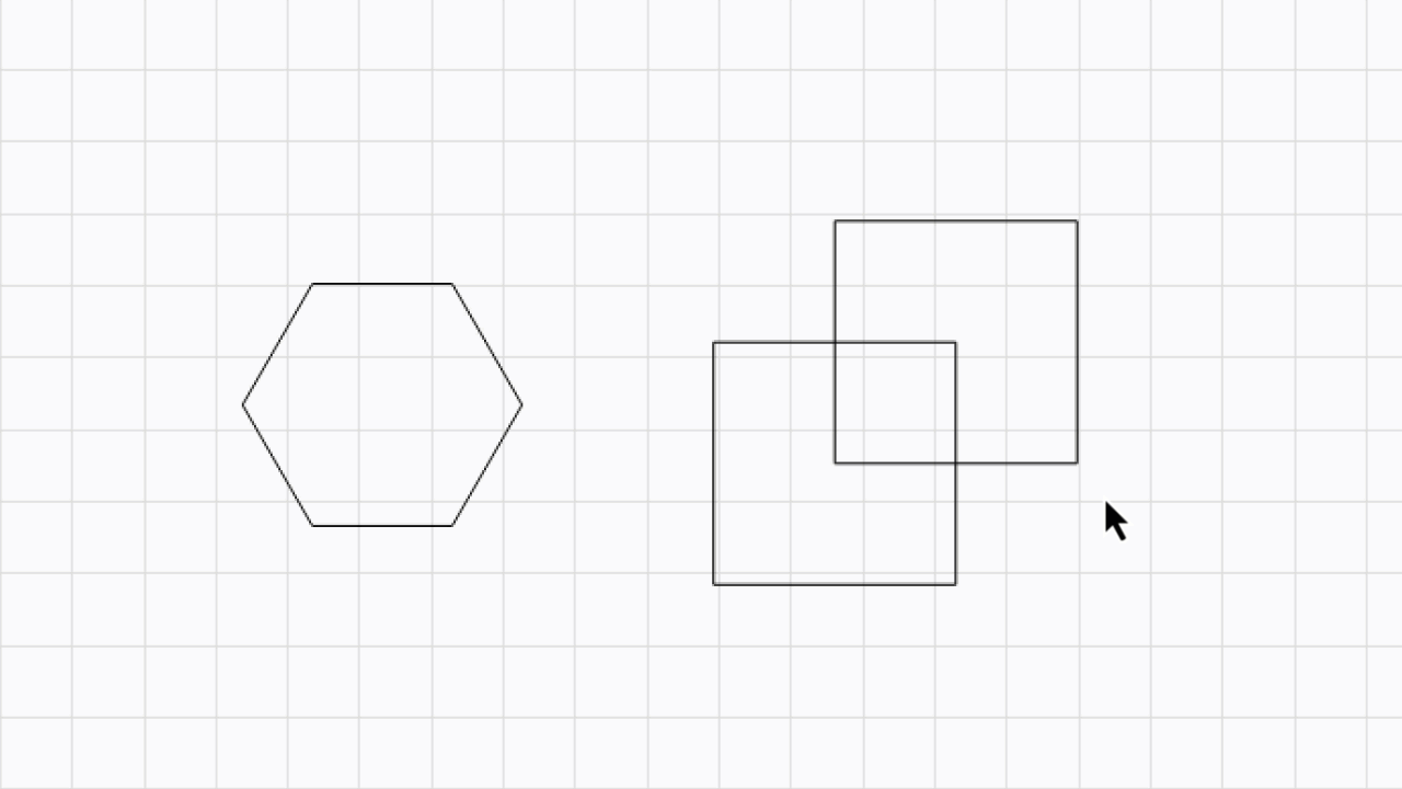

Creating From Snapping Points
When creating new objects using the Draw Lines tool or any of the Primary Shapes tools, your cursor will change to indicate when it is over a Snapping point.
  • Click and drag from any of those points to start a new line or shape at that point.
  • When you drag near a Snapping point, the cursor will automatically align to the point, and change to indicate the type of point it is aligned over.
    • If you're using the Draw Lines tool, click again to place a node at that point.
    • If you're using a Primary Shape creation tool, release to finish creating the shape.
Snapping during shape creation demo

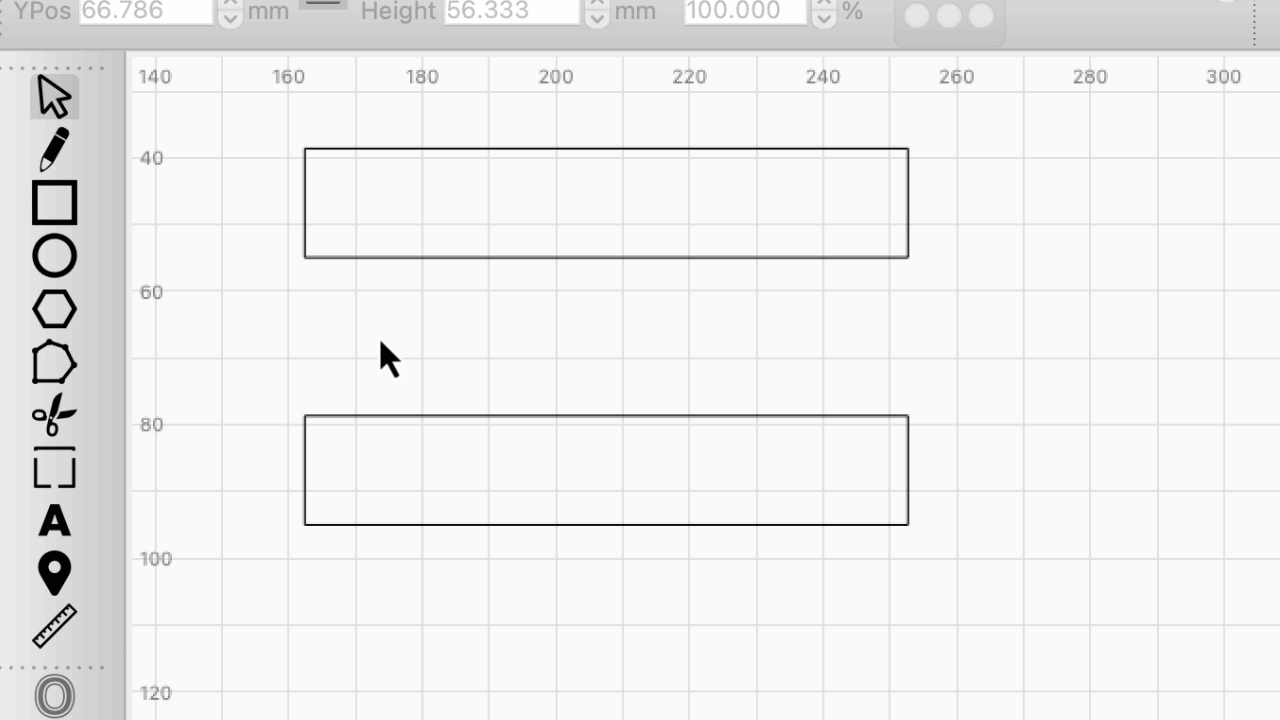

Snap to Grid
Grid Snapping automatically aligns your cursor to nearby grid corners when you're dragging objects or creating new ones.
Grid Snapping demo
Note
Grid Snapping points are determined by the Grid Snap Distance setting in the Settings window, and not the Visual Grid Spacing distance.
  • Grid Snap Distance determines the size of the grid squares whose corners your cursor will snap to — for example, if your units are set to millimeters, and your Grid Snap Distance is set to 1, your cursor will snap to the corners of a grid of 1 mm x 1 mm boxes.
  • Visual Grid Spacing determines the visual size of grid squares at the standard zoom level. As you Zoom In, you'll see a secondary 10 x 10 grid of squares within each larger square. Each smaller square is 1/10th the size of the Visual Grid Spacing value.
    Grid Snap Settings

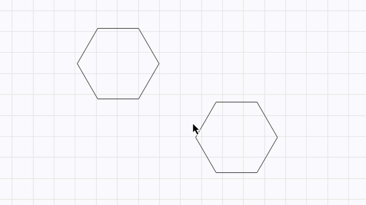

Keyboard Modifiers
  • Hold Alt/Option while dragging to make Object Snapping "stickier", meaning objects will automatically align to Snapping points from further away.
    Tip
    If you're moving an object or creating a shape, this will also enable Alignment Guides — temporary visual indicators that show when an object's edge or center is aligned to an edge or center of another object in your Workspace.
  • Hold Ctrl/Cmd while dragging to toggle either type of Snapping on or off for as long as the key is held down.
    Tip
    By default, this disables both types of Snapping. However, if you've disabled Snap to Objects or Snap to Grid in the Settings window, it will instead enable that type of Snapping for as long as the key is held down.
