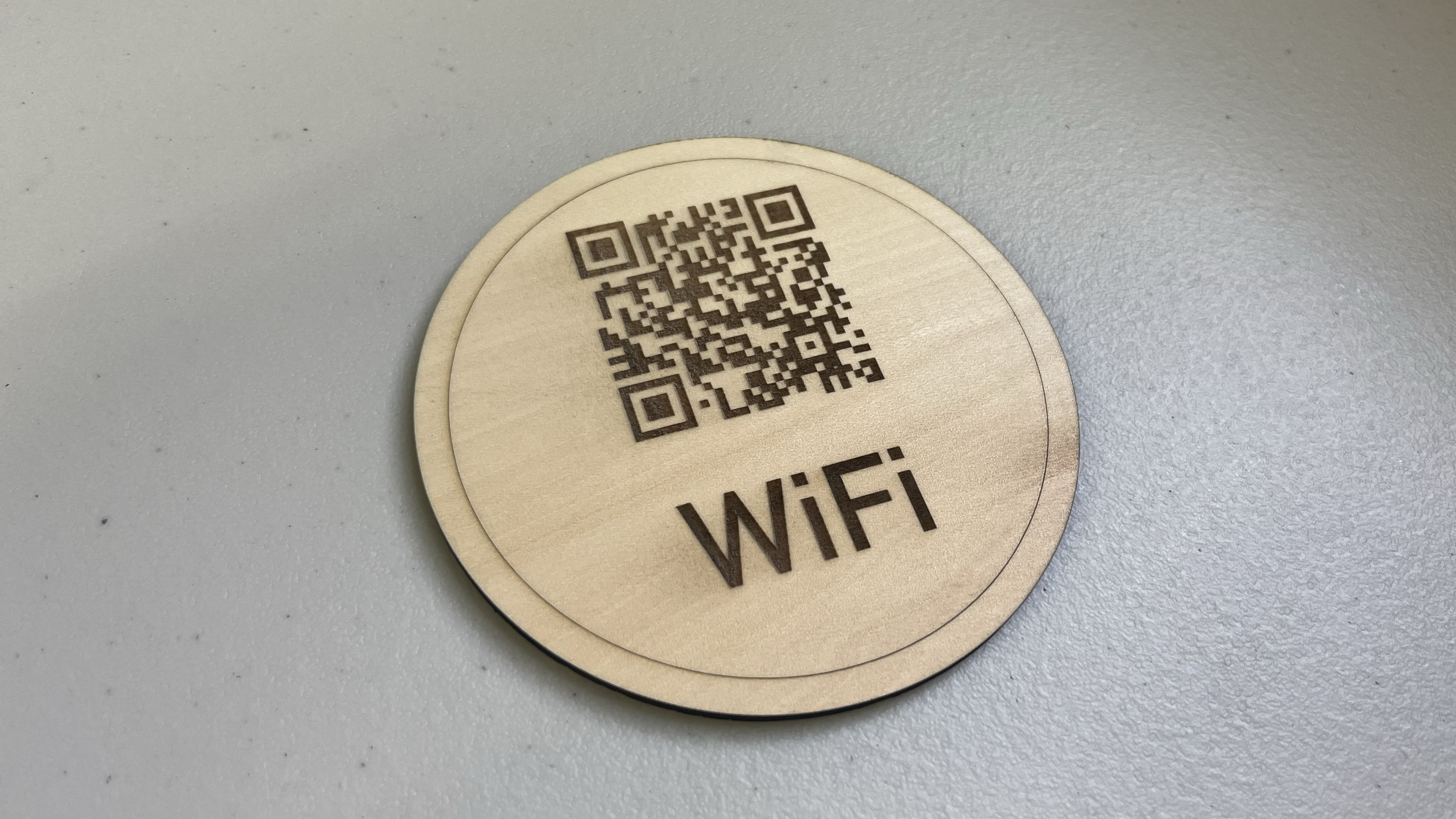

First LightBurn Project

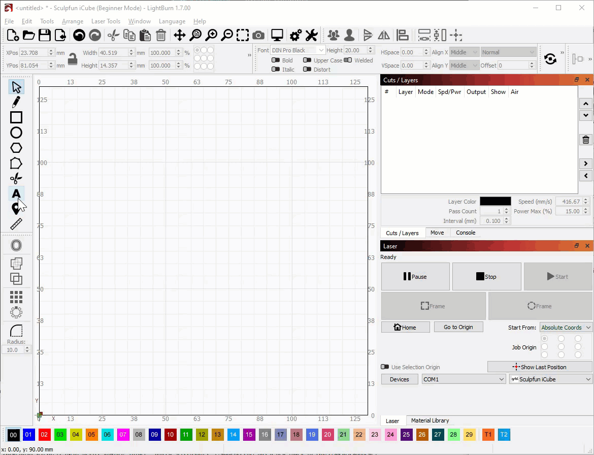

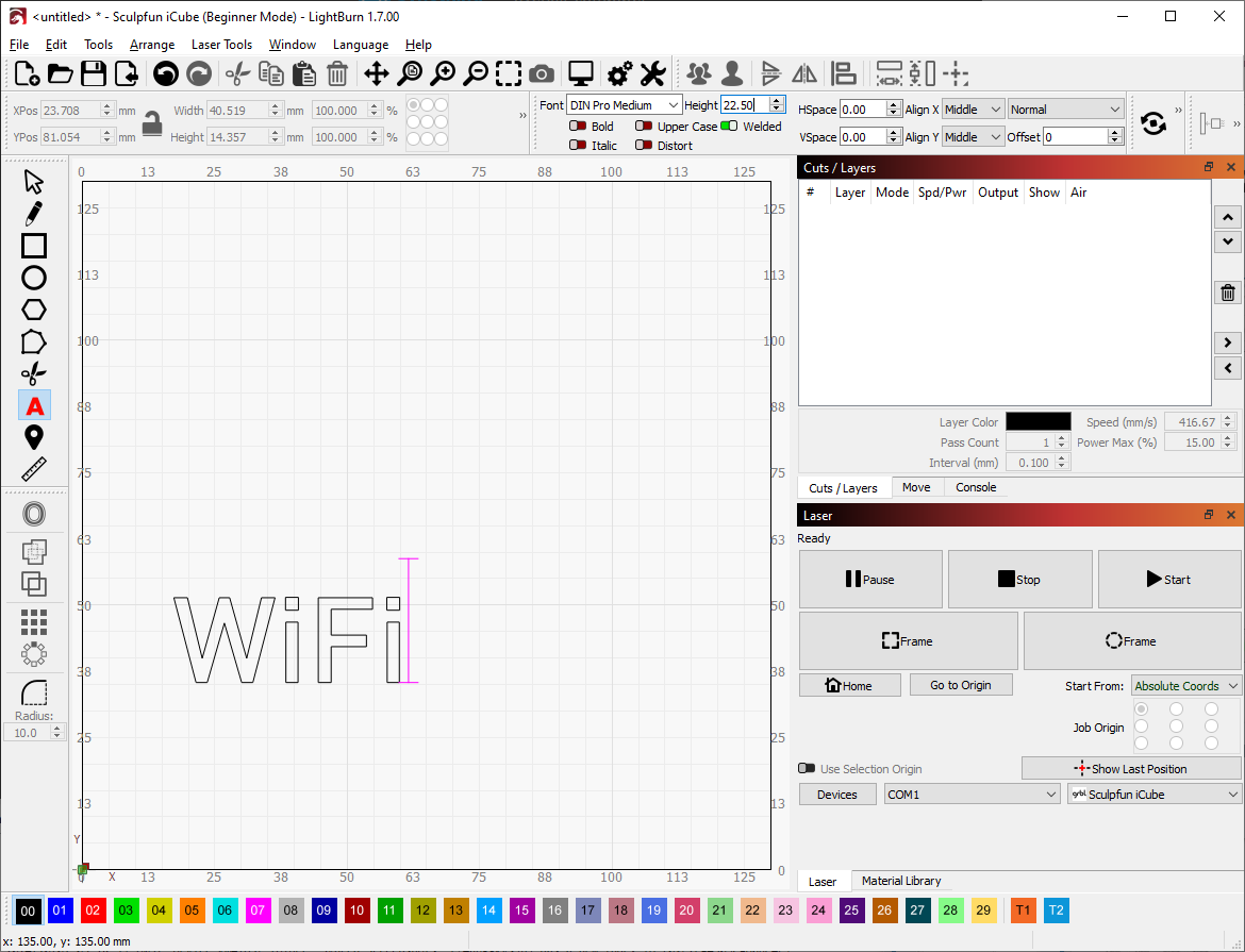

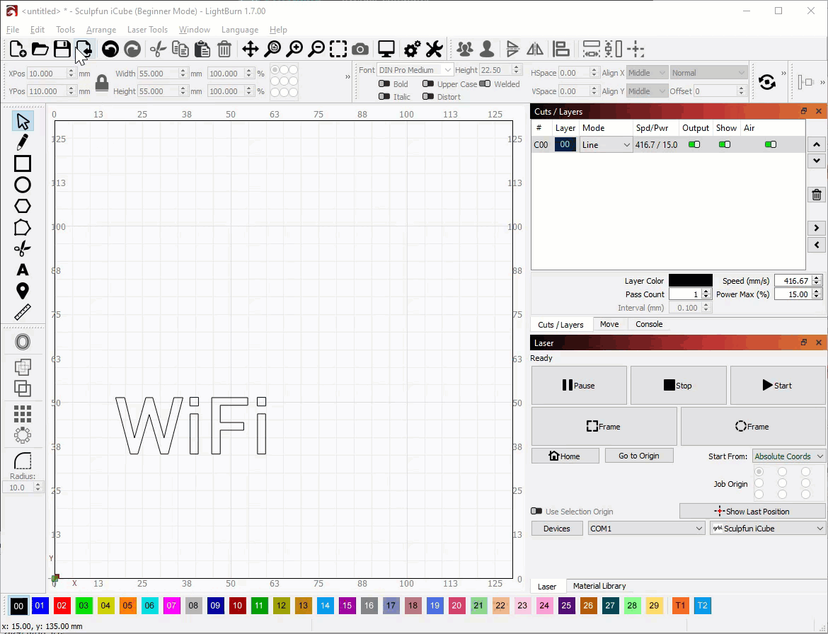

Create Text
You're going to start by creating text to engrave onto your coaster.
  1. Click on the Text tool in the Creation Toolbar.
  2. Click in the Workspace to place a cursor and type something out. Our demo coaster will say "WiFi", since that's what the QR Code will be for.
  3. Find the Text Options Toolbar near the top of the screen above the Workspace. When you have text selected, this toolbar becomes active, and provides several options for modifying the selected text. For this project, try the following steps:
    • Select a font you like from the Font dropdown. LightBurn can use any font installed on your computer.
    • Adjust the size with the Height box.
  4. When you're done typing, return to the Select tool by pressing Esc or clicking the cursor icon in the Creation Toolbar. You can come back and edit the text later by double-clicking it with the Select tool active.

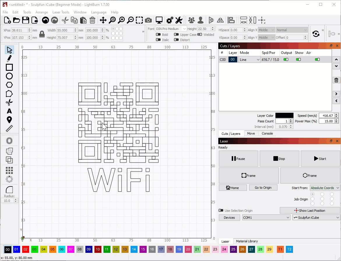

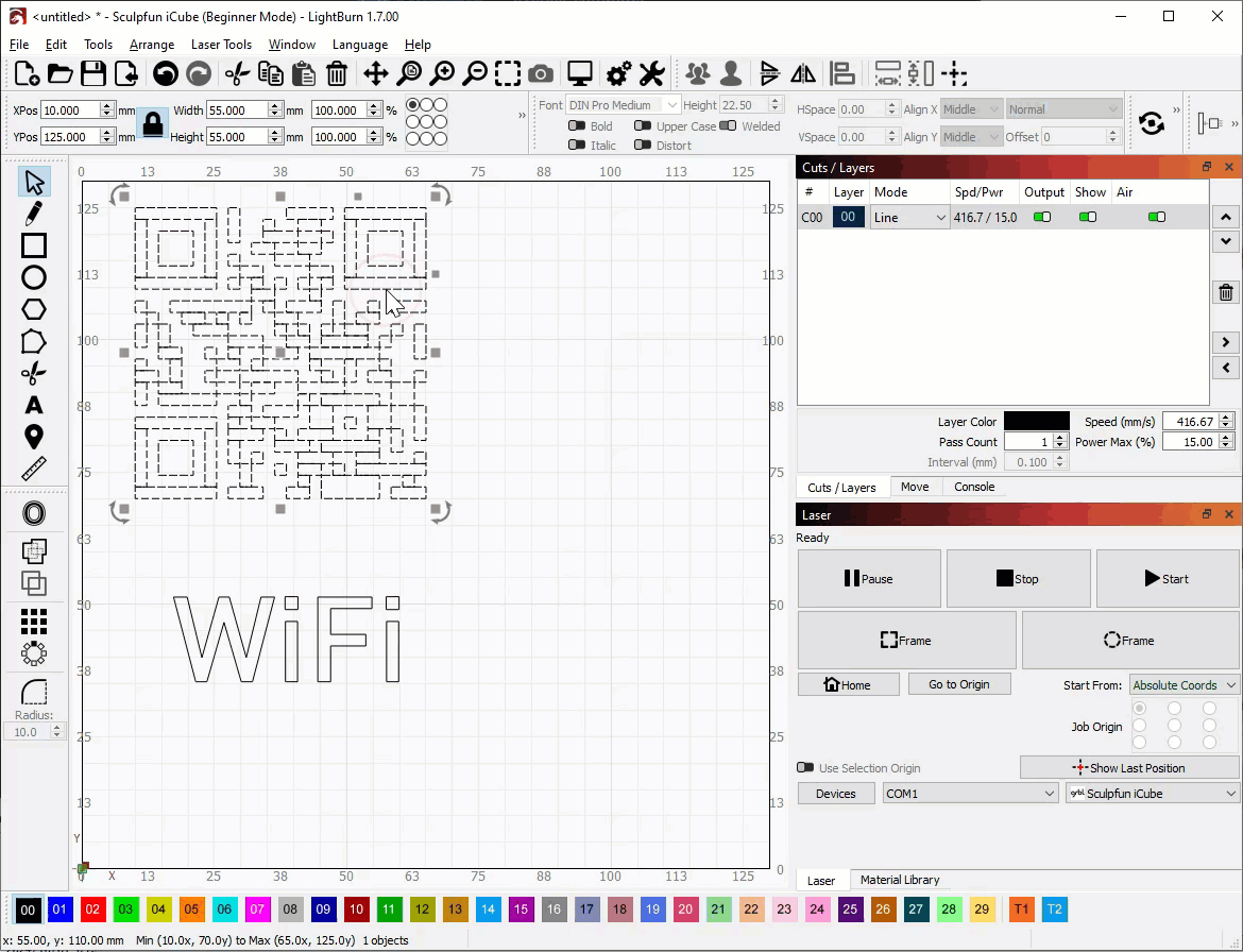

Create a QR Code
LightBurn has a built-in Bar Code tool, which can generate QR Codes as well as a variety of other scannable codes. You'll use this to generate a QR Code that automatically logs someone into your WiFi network.
  1. Go to ToolsCreate Bar Code to open the Bar Code tool. You'll see the cursor change to a QR Code. Click and drag in the Workspace to set the initial size of your QR Code and start creating it. Put it somewhere near where you want it — you'll improve the placement in the next step.
  2. Make sure the Bar Code Type is set to QR Code and click on the WIFI Tab.
  3. Enter your WiFi login info into the window – be very careful with your spelling and capitalization – and click OK to create the QR Code.
  4. Adjust the size with the Width and Height boxes in the Numeric Edits Toolbar. Make sure the lock icon is closed so the code's aspect ratio is maintained as you make adjustments, and it doesn't get distorted. Enter a size into either Width or Height — somewhere between 40 and 60 mm is generally a good size.

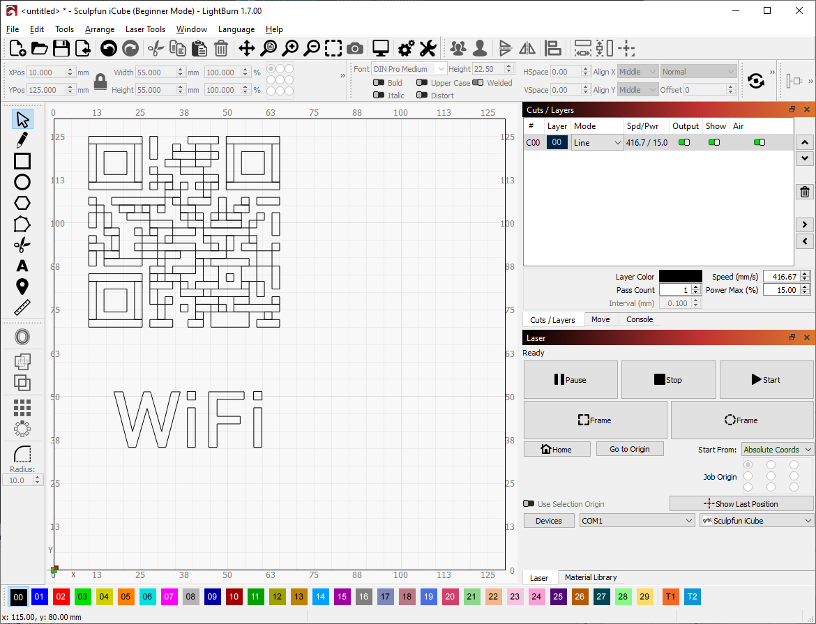

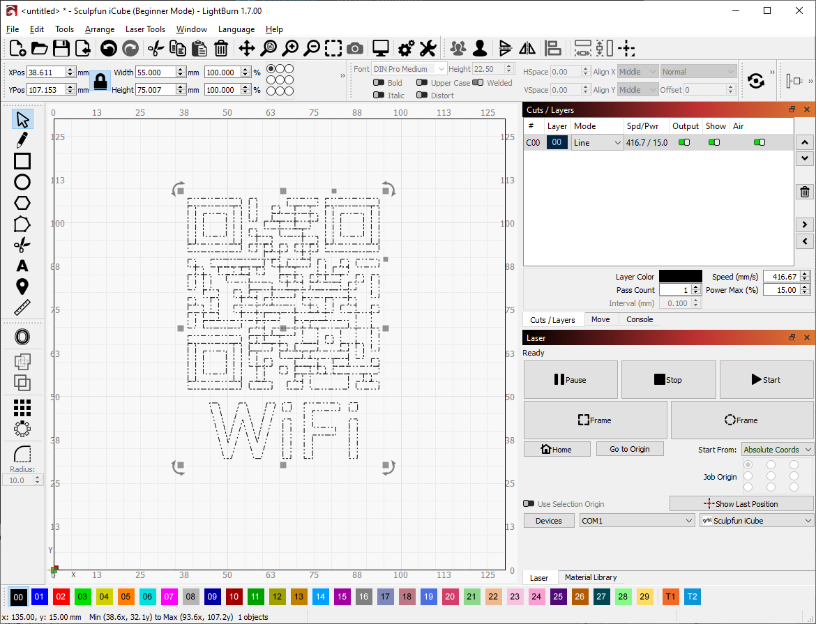

LightBurn offers Wireframe and Filled options for the View Style. After setting Layer 0 to Fill, if you don't see the shape filled in, you can use Alt / Option+W to toggle between Wireframe and Filled view styles. Read more at View Style Types.
  1. Open the Preview window with Alt/Option+P. This window shows your design as it will be sent to the laser, and can even simulate the engraving to estimate time and visualize what the laser will be doing. Try pressing play to see how it works.
  2. By default, your design will be on Layer 00 and set to Line Mode, which means the laser will trace the outside of the shapes rather than filling them in. Click on the dropdown under Modes and select Fill. Next to Speed and Max Power, set appropriate speed and power settings for the material you're using. Check your laser's user guide for recommended settings.

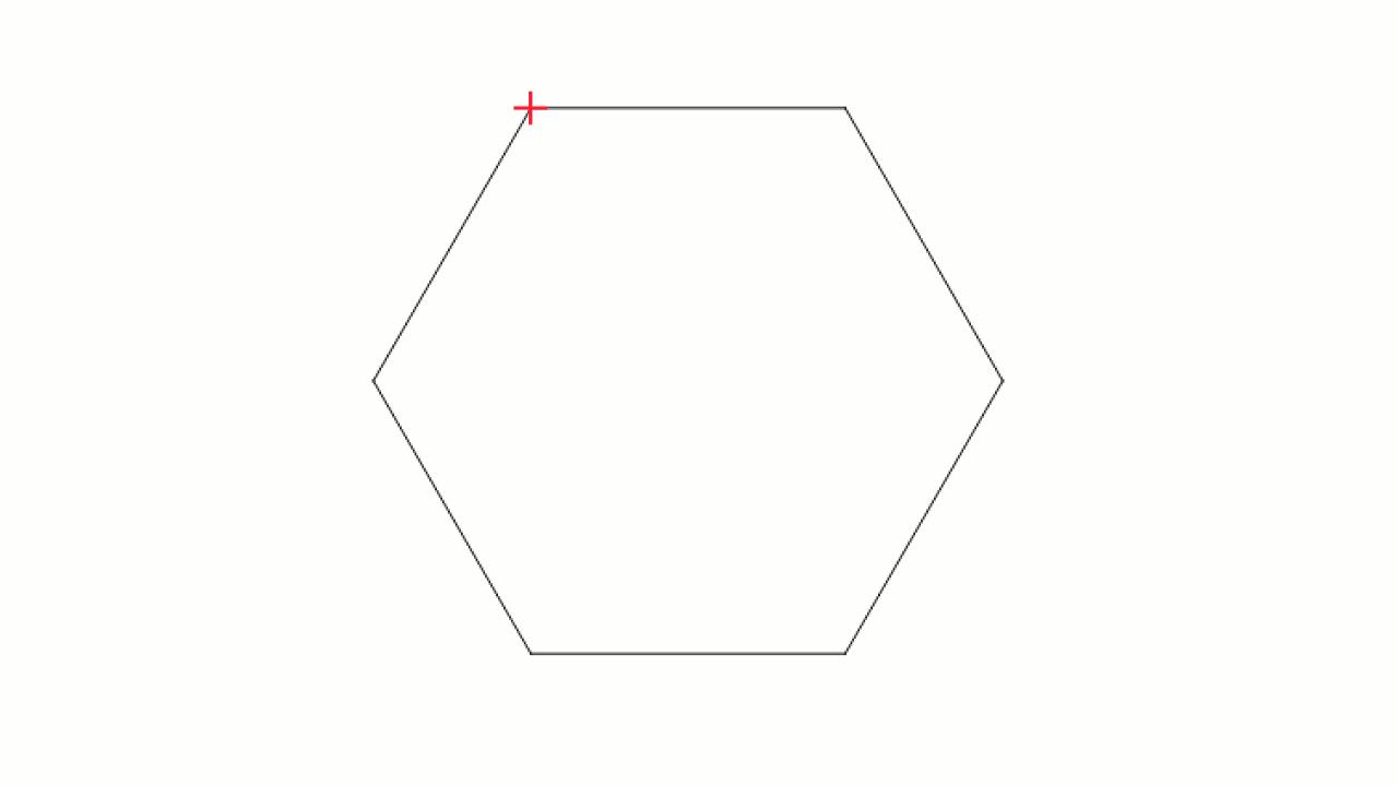

    Learn More: Line Mode versus Fill Mode
    Line Mode tells your laser to trace a path around the contours of vector graphics.
    If you command the laser to move quickly, or with low Power, it will likely just etch the surface (sometimes called scoring). If you move slowly and with high power, especially with a CO2 laser, the laser will cut deeper, or even completely through the material. The only difference between surface marking and cutting with Line Mode is the Power and Speed you set.
    Line Mode example

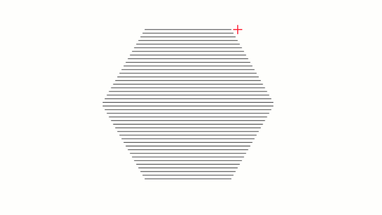

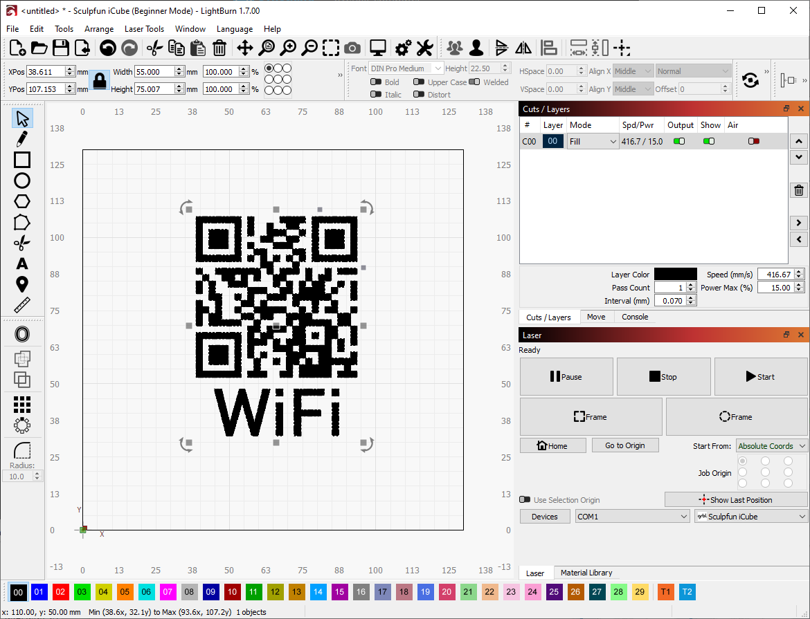

    Fill Mode tells your laser to etch parallel lines within the boundaries of vector graphics.
    The distance between each line is determined by the Line Interval setting, and the Speed and Power settings control the darkness or depth of the etch. Use low Intervals, low Speeds, and high Powers for deep engravings or dark marks, or tell your laser to move quickly at low Power to lightly etch or mark the surface.
    Fill Mode demo
  3. Turn off the Air toggle to disable air assist for this layer. It's helpful for cutting, but less useful for engraving.
    Learn More: Air Assist
    Air assists are a feature of some types of lasers that blow air onto the surface of your material at the spot where the laser's beam strikes, which can help prevent soot accumulation and charring, and aid in cutting processes.
    Some lasers have automatic assists, which LightBurn can turn on or off when a job begins. Other models have external air assists which you must enable manually when you start a job.
    If your laser has a manual air assist or no air assist at all, toggling the Air switch will have no effect.

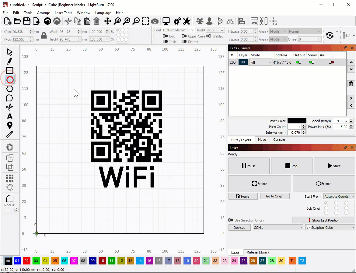

  4. Preview the design again, and you should see the design filled in instead of outlined.
Create a Decorative Border
With the QR Code and text ready to engrave, we'll move onto a different style of engraving.
When you set Layer 00 to Fill, the preview shows that the laser will move back and forth over the area to engrave, very much like printing on paper. A raster engraving like this is the most common way to engrave, but you can also engrave (or score) in Line Mode by using a lower power and higher speed than you would use to cut through the material. This tends to be faster and produce cleaner results on thin lines than a raster engraving. It's particularly effective with single line fonts.

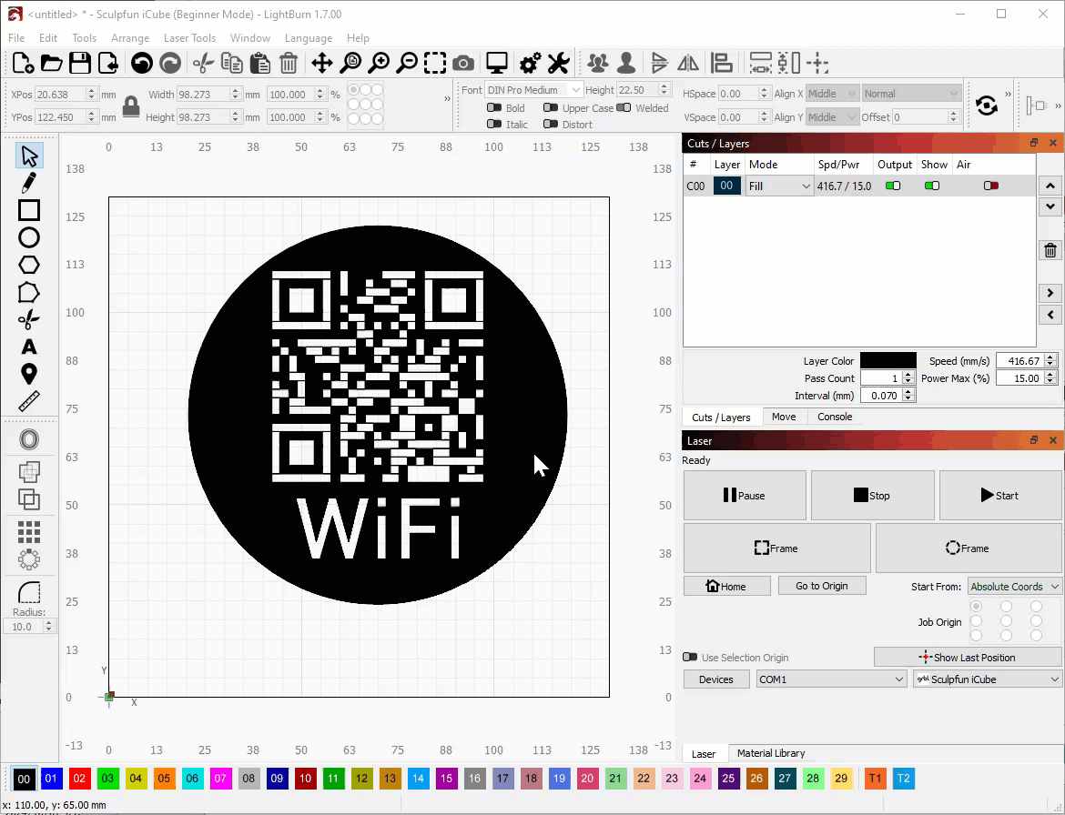

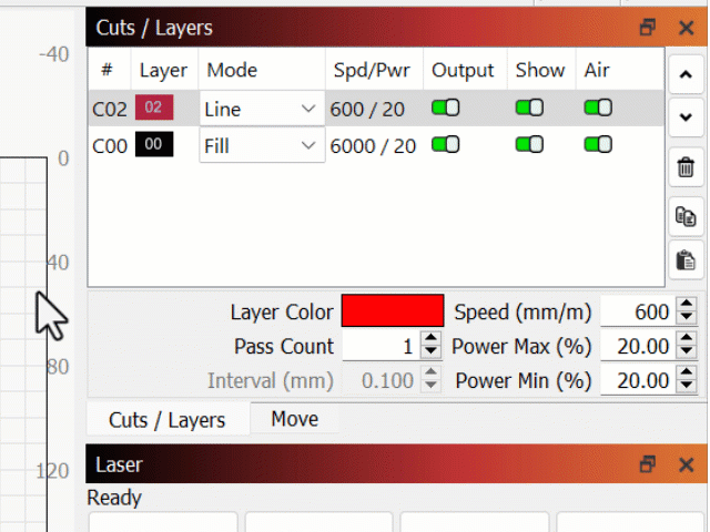

Right now, your circle is on the same layer as the QR Code and text. This means it'll be filled in like them as well. We'll need to move it to a different layer and give it its own cut settings.
My design is reversed!
A filled shape inside of another filled shape will act as a cutout, similar to a donut hole. We'll fix this in a moment. You can also see a more detailed explanation in How to Invert a Vector Engraving.
  1. Make sure the circle – but nothing else – is selected.
  2. At the bottom of the main window, look for the Color Palette. Select a layer other than Layer 00 or the Tool Layers, T1 and T2.
  3. In the Cuts / Layers Window, adjust the Speed and Max Power settings to a higher speed and lower power than your manufacturer recommends for cutting through the material you're using. This will let you engrave (or score) a line without cutting through.
  4. Preview your design. Your QR Code and text should still be filled in, but the circle should be just a line that the laser travels along.

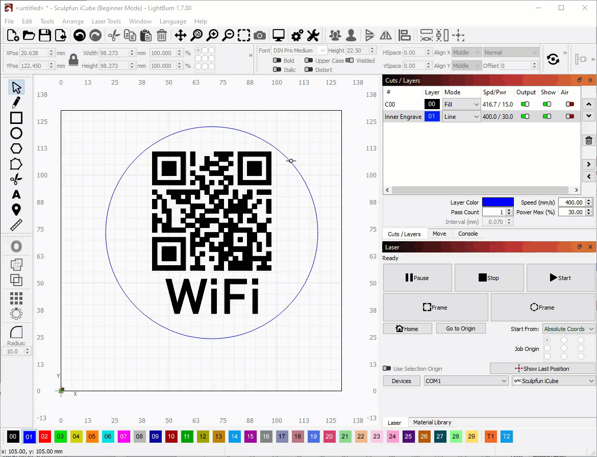

The last piece of the design is the circle to cut out. You could do the same thing we did for the previous step – draw a circle and center it with the Alignment tools – but this is a wonderful opportunity to get familiar with the Offset Shapes tool.
  1. Make sure the circle is selected.
  2. Go to ToolsOffset Shapes or press Alt/Option+O to open the Offset window.
  3. Make sure the Direction is set to Outward and Optimize / Simplify results is enabled. Adjust the Distance so that it looks good to you – LightBurn will give you a live preview as you adjust it. Somewhere around 6 mm or ¼" should work well, but this is your coaster and it's up to you. Press OK to create the new circle.
  4. As you did before with the first circle, move this circle to a different layer and adjust the cut settings.
  5. See your laser's user guide for recommended speed and power settings to cut through the material you're working with.
  6. If your laser has an air assist, keep the Air switch on to enable air assist for this layer. Air assists are helpful during cutting operations.

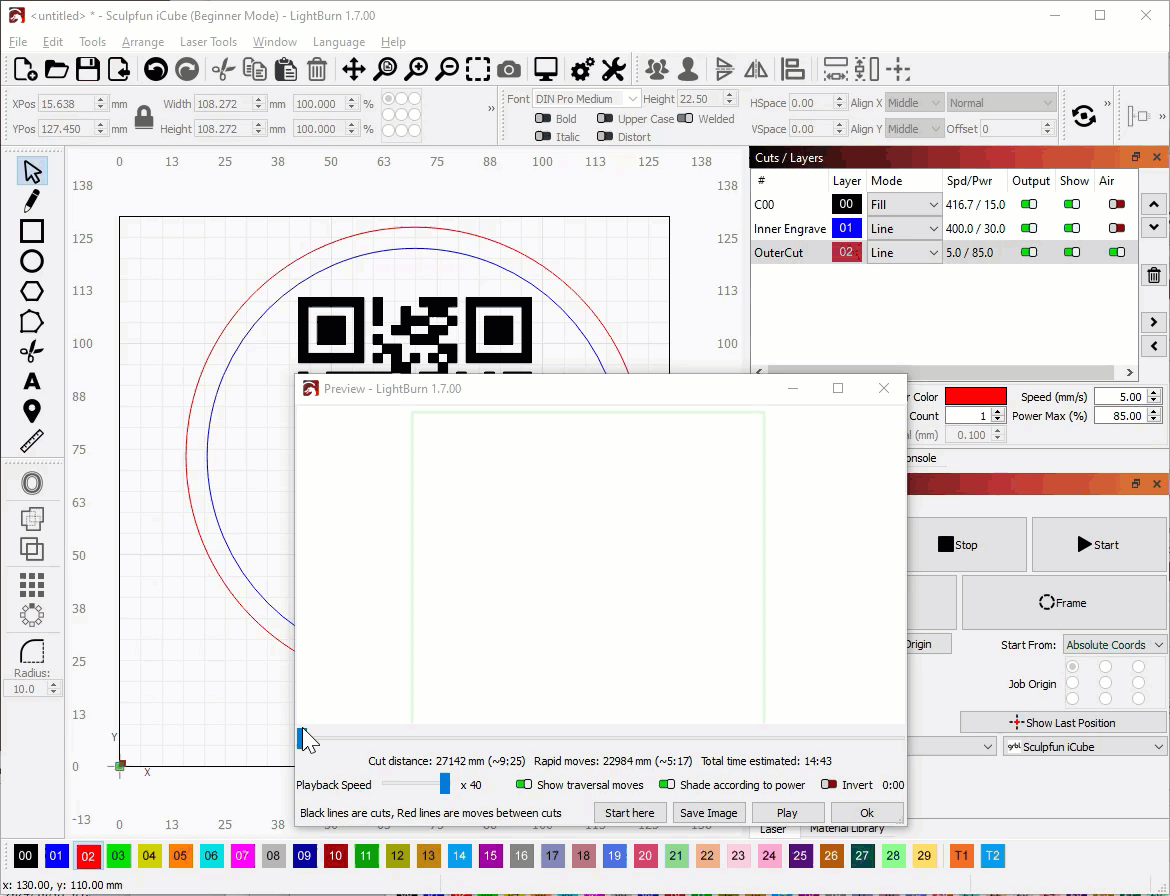

Previewing Your Design
Tip
It can be tempting to start a design without previewing it, especially when you're in a rush, but it's one of the best ways to catch errors before you start burning your material.

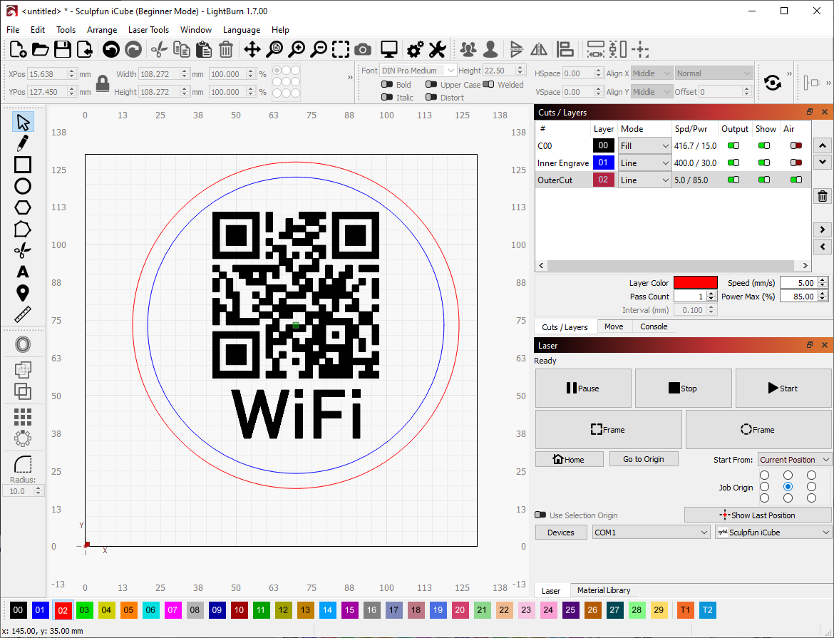

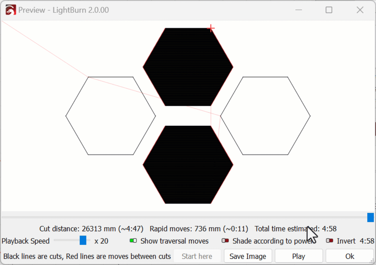

Now that your design is complete, preview it one more time. Remember that you can open the Preview window with Alt/Option+P. Press Play to preview what your laser will do. You can use the slider at the bottom to speed up or slow down the simulation.
In the simulation, you should see the following happen in order:
  1. Raster engraving to fill in the text and QR Code.
  2. Vector engraving the decorative border — the laser should follow the outline of the circle.
  3. Vector cutting the outer circle.
It's generally best to do engravings before cutting out your design. If you followed along with the steps above, your layers should already be in the right order. If they aren't, you can drag them around in the Cuts / Layers Window to change the order – by default, LightBurn will run each layer in order from top to bottom.
If you make changes, preview them again before moving on to cutting your design.

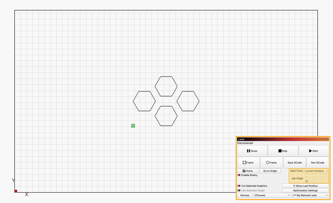

Start From

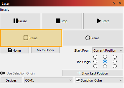

LightBurn has three different Start From modes: Current Position, User Origin, and Absolute Coordinates. For this project, you'll be using Current Position.
  1. Set Start From to Current Position using the dropdown in the Laser Window.
  2. Set the Job Origin in the Laser Window to the center of the artwork.
  3. With these two settings, your engraving will be centered wherever the laser is positioned when you start the job.
    Learn More: Current Position

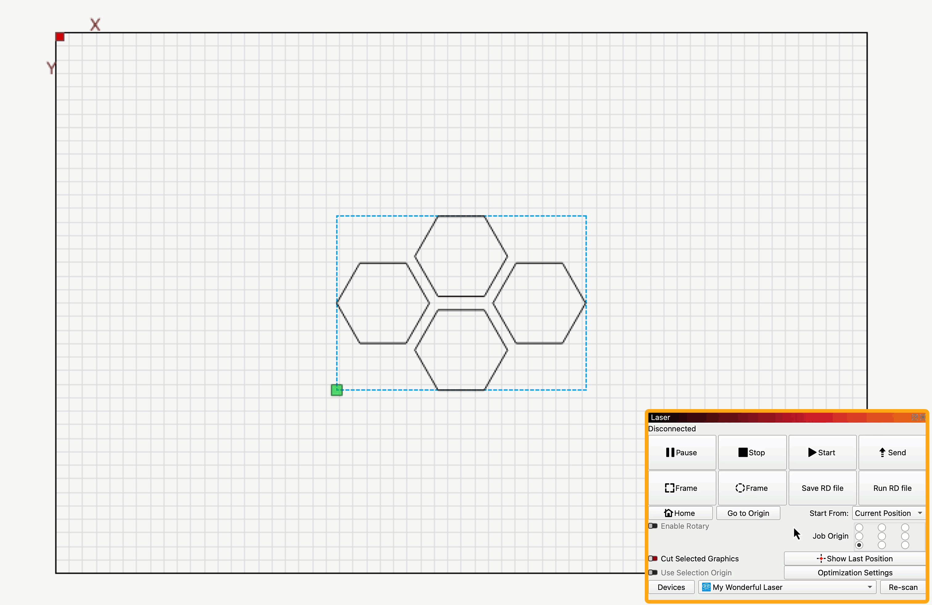

    With Current Position selected, your job outputs relative to wherever the laser head is located when you press the Start button. The Job Origin control in the Laser Window tells LightBurn how to orient output relative to the laser head.
    In this image, we're starting from the Current Position, with the Job Origin set to the lower left:
    Current Position Bottom Left Job Origin
    Notice the location of green Job Origin indicator. This represents the position of the laser when you start the job, so the laser is going to move slightly up and to the right from wherever it is, cut the four hexagons, and go back to where it started.
    Why is the Job Origin offset from the graphics?
    When using Current Position or User Origin, the green Job Origin indicator is always located on a corner, side, or at the center of an imaginary box — the smallest possible rectangle that can fully contain all graphics you're sending to the laser.
    Below, we've added a Tool Layer to represent that imaginary box. Notice how the Job Origin moves around the box as we change the location in the 9-Dot selector.

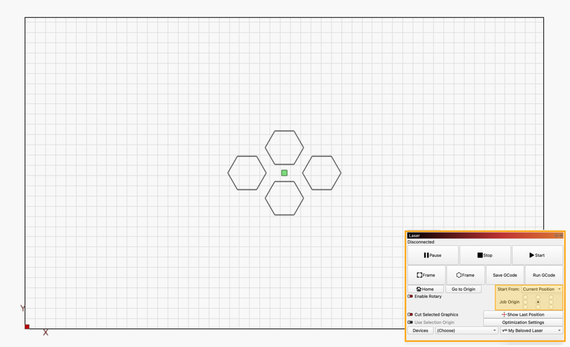

    Changing Job Origin
    Now imagine that you want to etch this four hexagon pattern onto a coaster or a phone case. Lining it up from the lower left is not easy. If you change the Job Origin setting to center, you get this instead:
    Current Position Center Job Origin
    The job will be centered around the current position of the laser head. If you position the laser head directly over the center of the item you want to etch, the output will be centered on the item.
  4. Jog your laser to the center of your coaster. If your laser has a controller display and keypad, you can use the buttons there to jog. If not, use the buttons in the Move Window.
Framing
The final check before you can run the job is to make sure that it will output in the location you're expecting.
  1. Click the Bounding Box Frame button to tell your laser to trace a box around the area the coaster will be cut and engraved.

    Framing with Current Position
    Here we've selected Current Position as the Start From mode, and the top right Job Origin position, so the laser moves down and to the left from its starting position:
    Current Position Top Right Workspace example
    Current Position Top Right Framing live example
    Here's Current Position again, but with the center Job Origin position selected — now the laser moves out from where it's sitting, and traces a rectangle centered on the location where it began:
    Current Position Center Workspace example
    Current Position Center Framing live example
