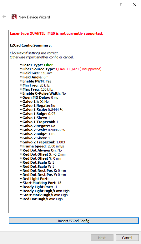

This means that we require data captures for nearly every type of different EZCad support laser source type to ensure that we correctly configure the controller board. For the more uncommong laser source types that we aren't currently able to confirm working, you may see a message like below when trying to import your old EZCad config:
If this happens, the best way to help us enable support for that specific laser type is to provide us with a data capture. This document will detail how to go about getting that capture.

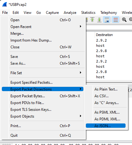

Step 5: In the Wireshark menu go to File > Export Packet Dissections > As JSON...
Save the file to a location you will remember with a descriptive name.
