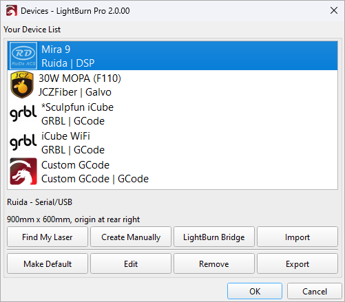

The Devices window shows all the devices you've added to LightBurn. Use this window to add new devices, Import and Export devices, and manage existing devices.
Accessing the Devices Window¶
To open the Devices window, click the Devices button in the Laser Window.
Managing Devices¶
Device List¶
The main section of the Devices window lists all the devices you've added to LightBurn. Click a machine to select it and see a device summary below the Device List. Some buttons in this window are only available with a device selected.

Make Default¶
Sets the currently selected device as the default. If you have multiple devices, use this to set which device is active when LightBurn launches. The current default device has an asterisk before the name.
Edit¶
Opens the New Device Wizard to go back through the device creation process on the selected laser. You can also double-click any device in the list to re-open the New Device Wizard for that device.
