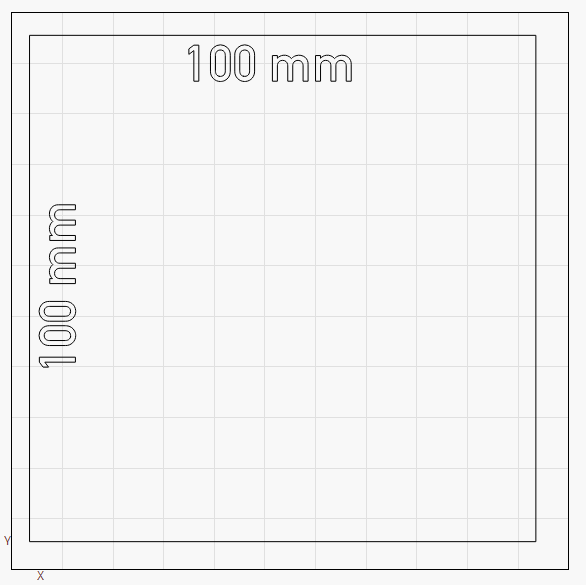

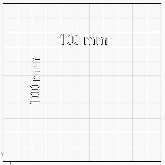

  1. Select the Draw Line tool and in the LightBurn Workspace draw a 100 mm line along the X axis and another along the Y-axis, or the Draw Primary Shapes tool and draw a box with equal dimensions — for example 100 mm.
    Two lines drawn on workspace
    100 millimeter square box

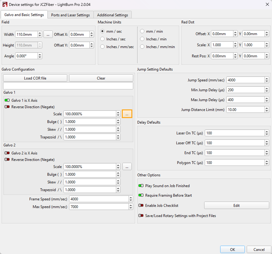

  2. Open the Galvo Device Settings window again and in the Galvo 1 section select the ... button to open the Calibrate Axis window.
  3. Measure the marked material along the X axis, and update the Calibrate Axis Requested size and Measured size values.
  4. Select OK to apply the new scaling values to the X axis.
    Calibrate Axis Window
  5. Repeat the process for the Y axis in the Galvo 2 section.
  6. Select OK to apply the new scaling values to the Y axis.
