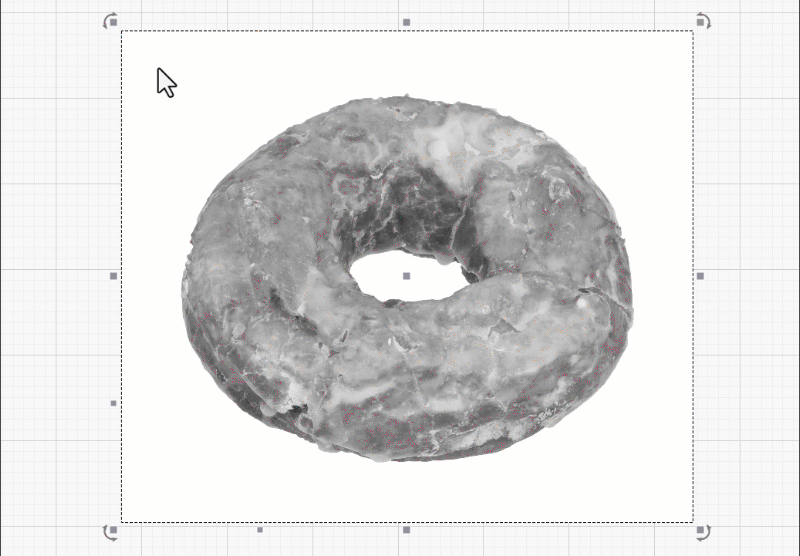

Use Apply Mask to Image to hide portions of images that you do not want to engrave, or to divide them into more complex engraving patterns.
By default, image masking doesn't delete the data of the removed part of the image, it just hides it from view and doesn't output those parts to the machine.
Tip
You can use masking to remove the background of an image, for example to isolate a pet or person from an photograph — a great way to get more clarity in an image that doesn't have a well-contrasted background.

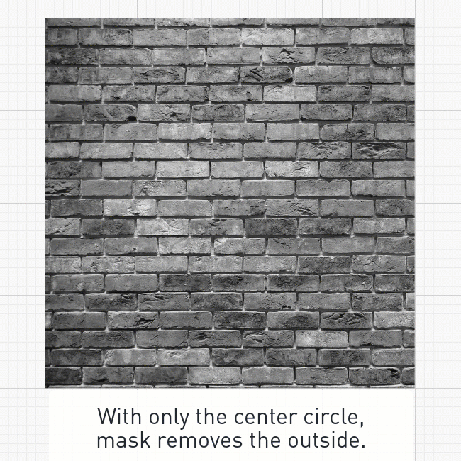

In addition to an image, masking requires a vector object, in any desired shape. The vector object must be:
  • Placed on either a Tool or Line layer
  • A closed shape, with a single, shared start and end point
You can use use rectangles to perform standard crops, but the shape can be a more complex path as well, or even a Group of vectors (including text) provided that the Group is all on the same layer. When shapes are placed on a shared layer, Grouped, and used for masking, the area between the shapes that would normally be solidly engraved with Fill Mode will be "filled" with the image instead.
To Mask an Image, select the image and vector, then go to ToolsApply Mask to Image, or right-click the selection and choose Apply Mask to Image from the context menu.
To immediately Flatten the mask in the process, you can select Crop Image from the same menus instead — if you choose to Crop an image, you will be unable to remove or edit the mask.
