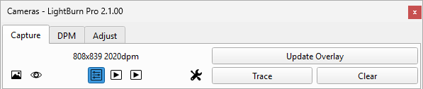

Capture Tab
Capture tab screenshot
Use the Capture tab to:
  • Capture images.
  • Manage and update camera overlays in the Main Window.
  • Manage cameras and camera previews.
  • Trace directly from the camera image.
  • Clear the current camera overlay.

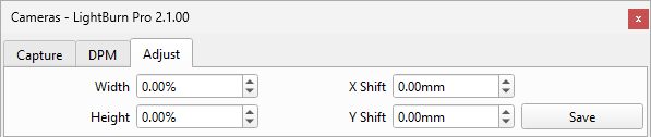

Adjust Tab
Adjust tab screenshot
Use the Adjust tab to scale and shift the camera image, if needed.
