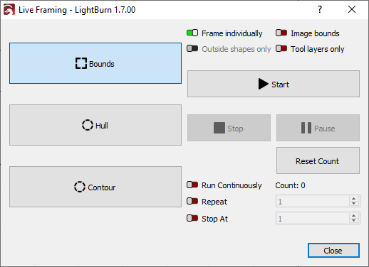

Click the Frame button in the Laser Window or press F1 to open the Live Framing window and start framing your job.
Note
Mac users need to hold the Fn key while pressing F1 to open the Live Framing window.
By default, the Live Framing window will also open when you press the Start button in the Laser Window, but you can disable Require framing before start in your Device Settings.
Galvo Live Framing window
There are quite a few settings in the Live Framing window, but many are advanced options you don't need to worry about just yet. We'll focus on the different styles of Framing, and a few other controls.
Framing Styles
The different options determine how the red dot light represents your shapes, and which shapes are shown.
Bounds
Commands the red dot light to trace a path defined as the smallest possible rectangle that will fully contain all graphics you're sending to the laser.
This mode is extremely fast, but doesn't represent complex shapes well.
Bounds framing example
Hull
Commands the red dot light to trace the smallest possible path that fully contains all graphics in the design you're sending to the laser, as if a rubber band were stretched around them.
It is nearly as fast as Bounds, but gives a much closer fit for rounded or smooth shapes.
Hull framing examle
Contour
Commands the red dot light to trace a path that follows the exact contours of your shapes — it takes the longest to draw, but it's the most accurate.
Contour framing example
Frame Individually
When you're using Bounds or Hull mode, this option determines whether to trace a single frame around everything in your project, or a separate frame around each individual shape.
This option is grayed out when using Contour framing.
