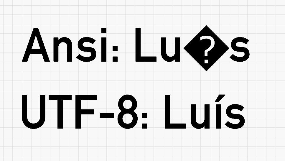

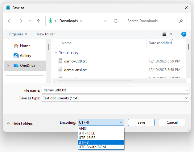

If special characters display wrong — typically as a question mark inside a diamond as shown in the image here — this is likely the result of the text encoding on the CSV/Text file being merged. Older programs may use the legacy ANSI format, which can cause problems with special symbols or accented characters.
To fix this problem, open the file in a modern text editor or spreadsheet program and save with UTF-8 encoding. Notepad on Windows and TextEdit on macOS both work well for this and come pre-installed with the operating system.
