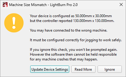

A machine size mismatch occurs when the machine size LightBurn reads from your device's firmware doesn't match the machine size saved in Device Settings.
Machine Size Mismatch
The error message reads:
"Your machine is configured as width x length but the controller reported firmware width x firmware length.
You may have connected to the wrong machine.
It must be configured correctly for jogging to work safely.
If you ignore this check, you won't be prompted again. However the software then cannot be held responsible for any machine crashes that may happen."

The error message provides you with three options.
Update Device Settings¶
Click this button to automatically adjust the Device Settings to match the device's firmware. Check your device's user manual or contact your machine's manufacturer to verify the correct dimensions and make sure they match the firmware before choosing this option.
Read More¶
This button brings you to this troubleshooting page for more information, and does not make any changes in LightBurn. You can still make changes manually.
Ignore¶
Ignore the error for this machine. You won't be prompted again, but the software cannot be held responsible for any machine crashes that may happen.
Correct the Mismatch¶
If you're certain the Working Size value is correct, you most likely either have the wrong device selected or have firmware with incorrect size values.
- If you have multiple device profiles, you may be connecting to a machine other than the one you intended. To check, use the dropdown menus in the Laser Window to switch to the correct profile, or select the correct communications port to connect to a different machine.
- In some rare cases, your machine's firmware may be set incorrectly. If this is the case, you will need to update the size in firmware using Machine Settings. This should be done with caution and only after verifying the correct size in your device's user manual.
